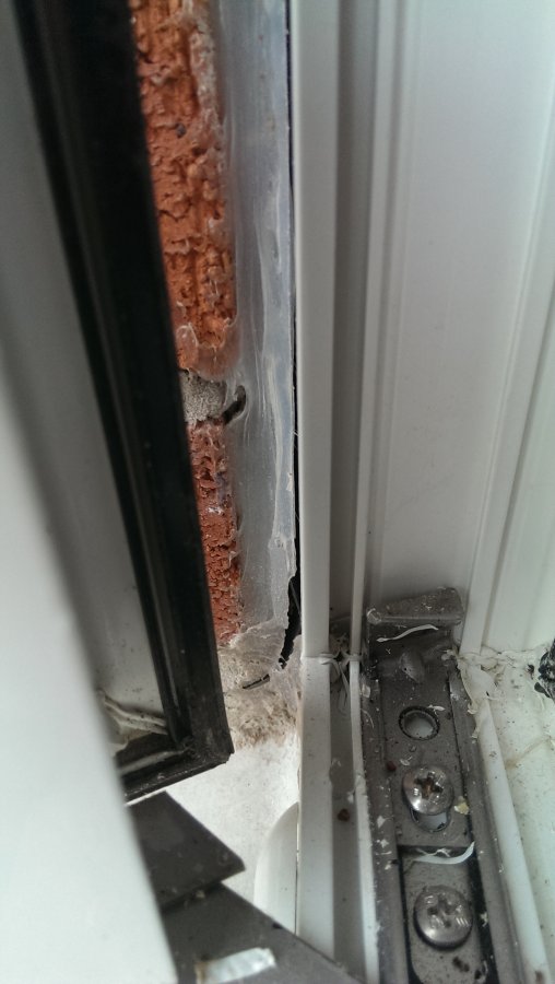

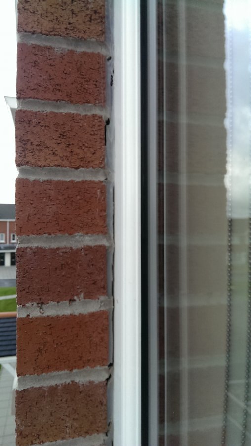

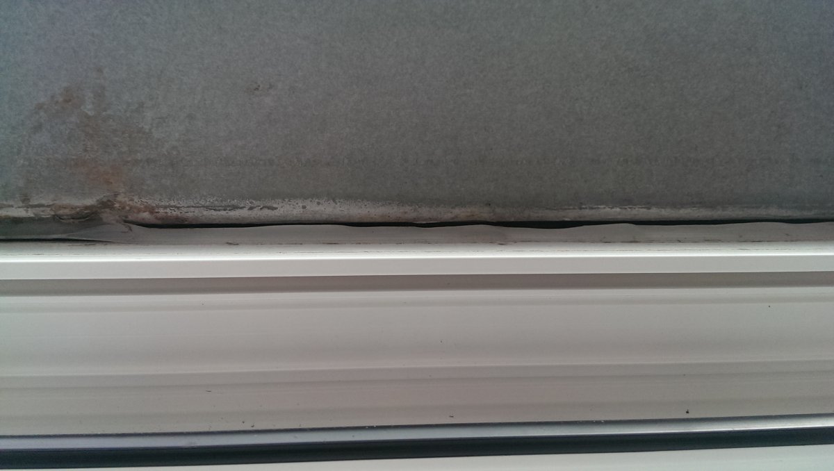

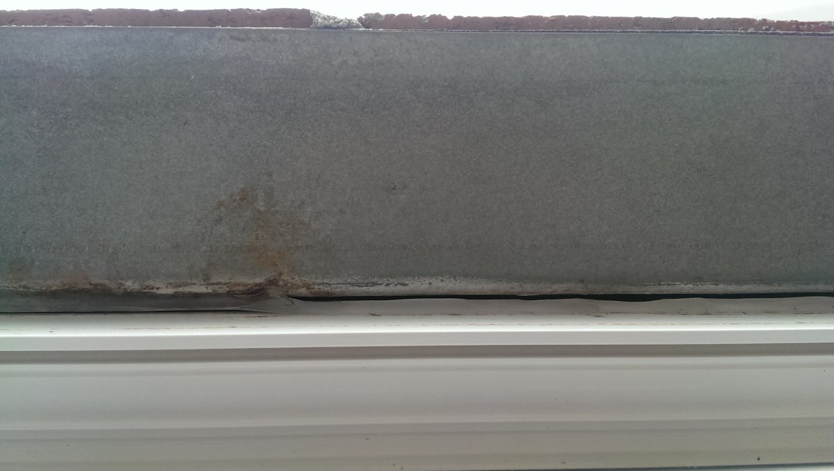

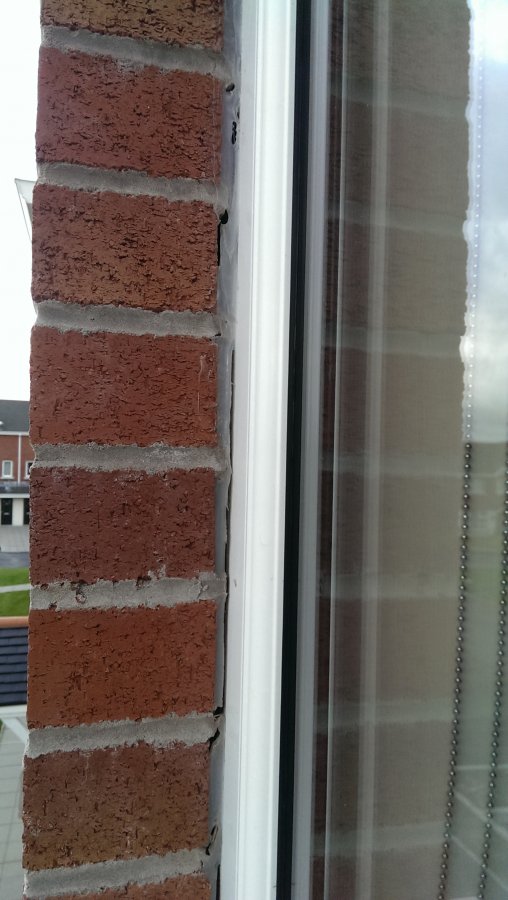

I have noticed that the windows at the front of my house have become very noisy when it is windy. Upon further inspection there seems to be a gap around most of the windows where the silicone has shrunk away approximately 10mm to 15mm. The house is a new build and i have only lived in it for a year. Is it just a case of getting the builder to reseal the windows? or is this gap to big and there is an issue with the fitting or adjustment of the windows? I have included a few pictures of the side and top of the window frames to help show the problem.
any advice would be appreciated.
Thanks Leo.

Windows can only be fitted as level as the bricks are.
Ideally it could have done with some expanding foam in the gap before it was sealed but I expect they will just silicone it again
That gaps way too big. It's possible that being a double cavity wall setup, they weren't able to set the windows far enough towards the outer skin. Foam should have been used to fill the gap, and then silicone on top to seal the windows. They obviously haven't done the foam, and haven't done enough silicone. Water will get in if it's not dealt with, so get in touch with the builders, but make sure they don't just add more silicone, as it'll just fail again.
Ah new builds!!! Windows are often made weeks or months before and stored, bricklayers use formers knocked together out of 4x2 more often than not a slightly different size to the windows, fitters come along on a 'price per window' basis and just fire them in, frames are often held in on cleats or a spring loaded type affair that locks into the cavity closer, they don't have time to foam, days or even weeks later a 'finisher' comes round and seals outside - again he gets paid per frame and hasn't got time to foam and wait and trim it off, he thinks why should he be slowed down and affect his wages when the builders made the openings too wide!

Thanks for the advice much appreciated. I guess ill get back in touch with the builders its like trying to draw blood from a stone trying to get them to do things especially now there not on site anymore the joys!
I'd be more concerned about the external beading.
Its cheapness that's all, probably mechanical joints as well. My brother bought a new build 5 years ago, ext beaded and on wedge, mechanical joints and 24mm units and I've changed about 5 already
Bodge job, still under warrantee?
