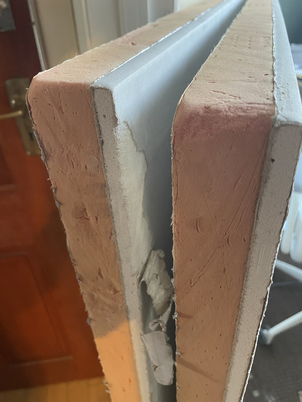

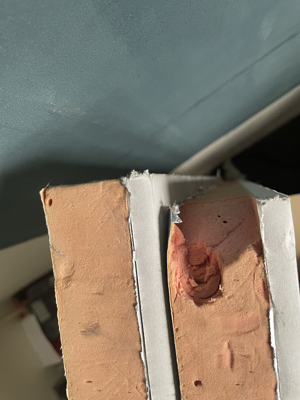

What is an acceptable level of damage to insulated plasterboards?
11 May 2016
89
5
I’ve just had a couple of 62.5mm Kingspan K118 delivered. C. £100 ea so not cheap certainly. There is damage to the faces, edges and corners of both boards, but I’m unclear as to what level may be considered acceptable (if at all). I’ve posted a couple of pictures - and would be extremely grateful if anyone may be able to advise please before I go back to the suppliers. It may also be possible for me to savage the remaining parts of the board (I do plan to skim them), but again, grateful for any advice.
Many thanks as always!!
I was thinking acceptable when I saw the first, then changed my mind when I saw photos 2 and 3. But they'll never be pristine.
I'd say send your photos to them and tell them you want replacements. Hopefully they'll just agree, if they don't then it would be interesting to hear their response here. You might find they tell you to go away the next time you order though.
Having said that, do you know what cuts you'll be making? If you could trim off the damage then it might make life simpler to just get on with it.
Thank you all for the comments. I did end up keeping them as is - on the Saturday when I then came to use them, then discovered that I'd actually been sent 52.5mm thick boards rather than the 62.5mm boards ordered! But thank you all for the very prompt responses as always!!
