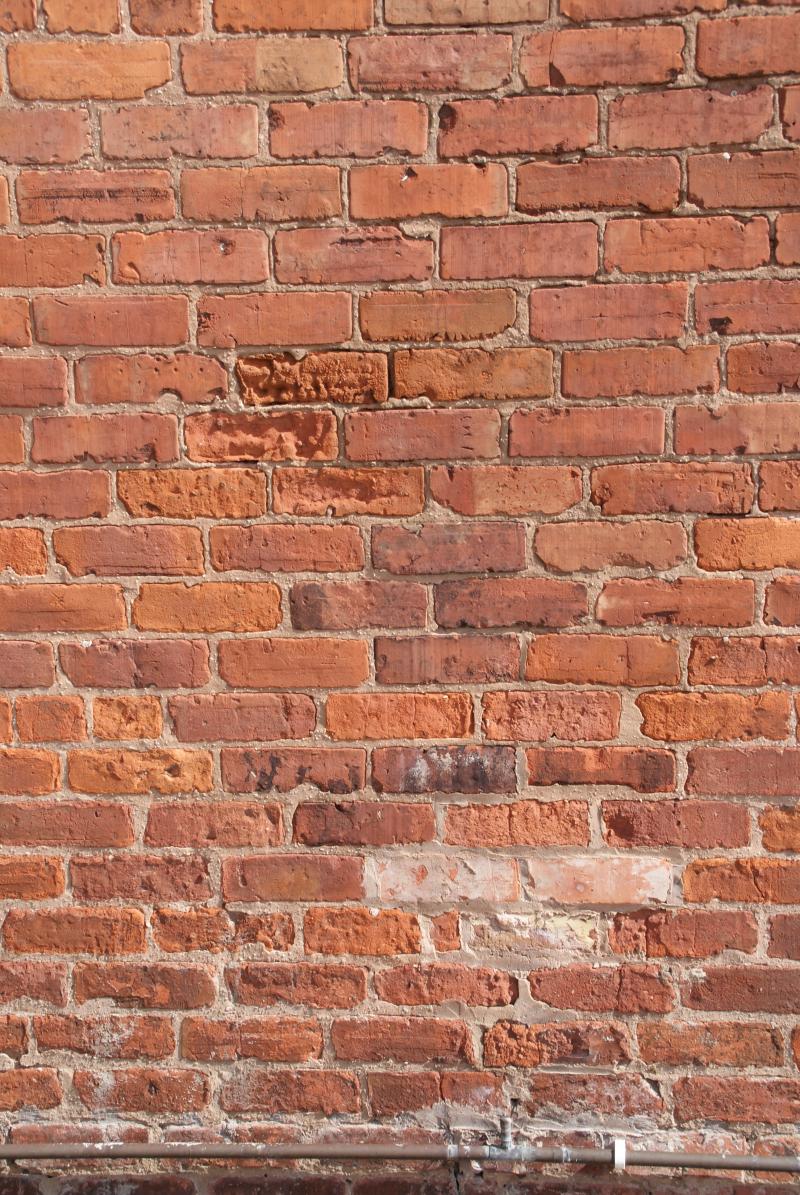

Hi,
I've recently exposed an old fireplace in a room we are renovating. I had previously noticed a damp patch on the outside of the house on the fireplace wall but didn't quite realiase the extent of the problem until everything was stripped out.
This is the view from inside, as you can see the bricks are crumbling:
And from outside (There is only 1 brick thickness in the wall at the back of the fireplace):
From a distance:
As you can see there is a damp line all the way from the chimney stack down to where it looks to have 'pooled' at the bottom. The chimney pot for this downstairs fireplace is capped, the room above is uncapped (there also seems to be a family of jackdaws in there!). The room above has a blocked fireplace and no vent that I can see. So my initial thoughts were water ingress through the uncapped chimney leaking right down to the DPC?
Before I exposed the fireplace, there was a gas fire using the chimney although this was unused for a few years before we moved in. If any condensation was caused by the gas fire this would have dried out by now, right?
Another suspicion I had was rising damp. The fireplace was filled with bricks, soot, plaster etc and the quarry tiled floor beneath is damp. (We're planning on having an asphalt screed eventually to sort this out) So the old DPC could have been bridged in this location for many years.
We had a new DPC a year ago when we moved in.
Maybe all three factors could have contributed to the problem, and others I haven't thought of?

1. What do you propose to do with the open fireplace (s)?
2. How do you know that the fireback is single brick? On the outside of the fireplace cheek, does it measure back 2 x bricks to the back wall?
3. Typical for your conditions would be some penetrating and a little rising damp.
4. If possible, post a pic of the exterior at ground level.
5. Research on here, there's much info ref flue's and stacks and openings.
6. There is a condition called sulpherisation that takes place in unswept and unvented, gable flues. But first, deal with the above Q's 1-5.
7. Given the waste on the gable, perhaps carefully examine for weeping leaks, any supplies to the basin etc that the waste serves.

2. Ignore the position of the frame - the gable appears to be a 9" solid wall, which would be appropriate for the built date.
Water might be penetrating thro the frame reveal tight to the c/breast. Spray water on and observe.
Smeared on patch pointing appears to have taken place. Whats required is to rake out to 18mm and re-point in 4-1-1, or 3-1xlime. The original mortar is lime mortar. Replace perished bricks. How far you would want to go is up to you, but cover the area in question.
3. No. Research your options for all flues and terminals in that stack.
7. Of course, i didn't think.
FWIW, I can see what might be historical, exterior, injection holes in the course just above the horizontal gas pipe, but no signs of interior injection holes. Any injection should have taken place in the course just above the solid floor.
AAMOI, does the frame have a lintel supporting the depth of the wall?

2. Perhaps it's only the fireback that is 4.5" - cheeky bricklayers.
3. DPC injection, FWIW, in solid walls is typically "double drilled" from the exterior. Hence, the fireback would have been drilled from the exterior. I can see injection holes in the fireback first course which indicates that they were drilled from outside and burst thro, or were drilled from inside. The cheeks should have been double drilled from the outer face of each cheek - that is, if they were accessible at the time.
Check with Rentokil, will they charge for a return visit and any "make-up" work?
Definitely install steel lintel (s) above any new frame. Doubtful that dropping pressure from lack of a lintel is causing damp. Mind, there is a "crack" ( or pulling away ) down the right hand reveal?

If that damp area is in line with the flue, then its sulphate attack of the mortar from the flue gasses - cement eaten away, leaving mainly sand and porous joints

Your're not getting it are you? It's condensation.
Warm moist air from your house is condensing on the cold damp brick. It's not going to dry out, neither will it get any worse - forget about it. Spend your money on a holiday.
