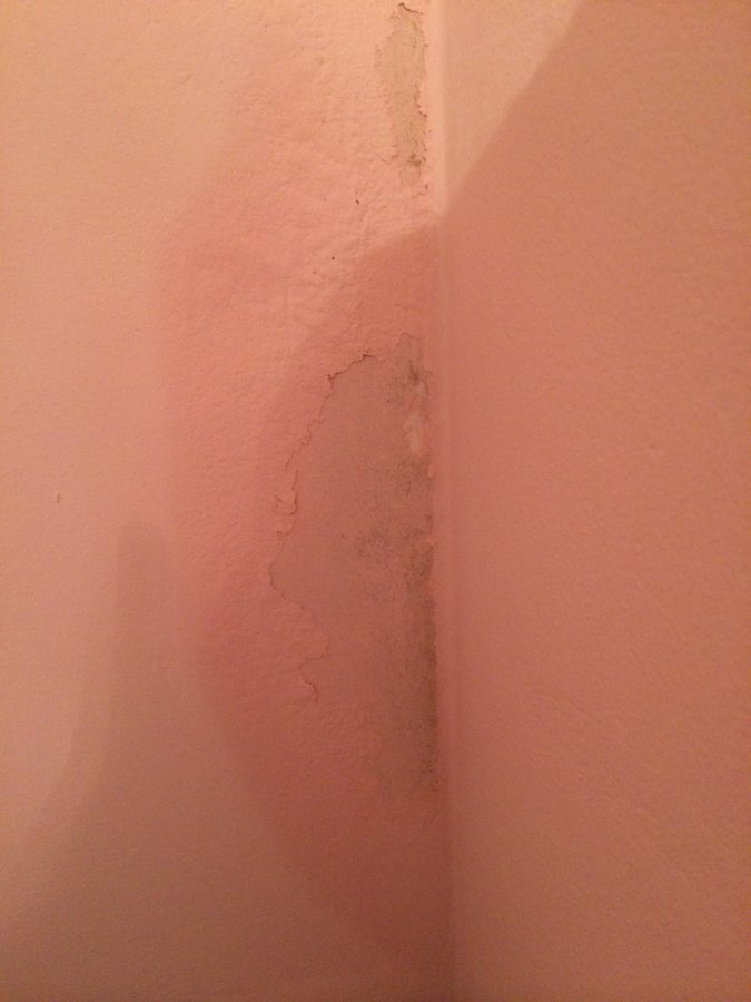

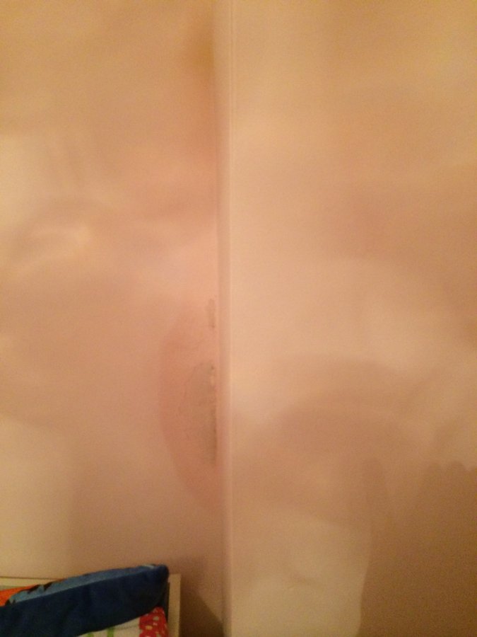

Hi
What is the cause of this on the wall of my daughters bedroom, its just showing in 2 places, where the paint has cracked off, and now its looking a bit black underneath. Also after periods of heavy rainfall it smells damp in the bedroom.
It has been like this for months and could it be hydroscopic salts in the chimney breast which is to the right of the damp patches on the picture.
In the last few weeks we have had the chimney stack taken down to roof level at the eaves and the chimney breast is venting into the loft. We had the stack removed as it was not being used and wanted to eliminate this as a cause of water ingress into the chimney.
On the exterior wall it is clad in clay tile, timber frame with rockwool insulation (1960's property, in the living room below in the fireplace is a standalone electric fire in the fireplace. When taking the electric fire out the chimney comes down into which looks like a baxi cast iron part. The wall in the living room where the fireplace is recently wall papered but we never have had any damp patches here. However sometimes the room can smell of wallpaper paste?
What is best to treat this wall with to solve the problem? Are there any anti damp paints I could use, as I don't really want to hack all the plaster off (actually this wall might be boarded over then plastered)
The shape of the damp stain is indicative of moisture penetrating from the rear of the wall, and not being absorbed from the air in the room.
Thompson's won't stop this. You'll need a different product to coat the wall to form a barrier, and then replaster a wider area.
But if it's coming from the flue, then the venting is inadequate, and the damp could just reoccur somewhere else. A disused flue should be vented from the bottom in the lounge and at the top to external - not in a loft as that does not draw air out and can cause warm air to enter the flue and condense.
Penetration from external is possible, and should be checked, but if this has occurred following work on the flue, then that's the most likely cause.

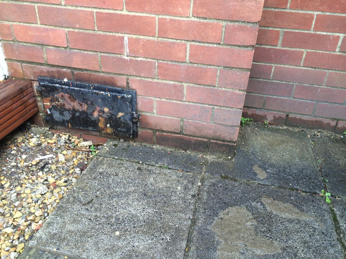

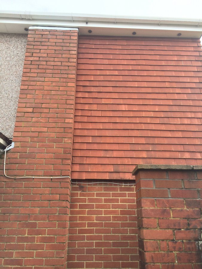

It was like this before the chimney was done so it must be coming from the outside? But how would you know? I have attached a pic of the exterior, the damp patch is to the right of the chimney breast where it meets the tiles

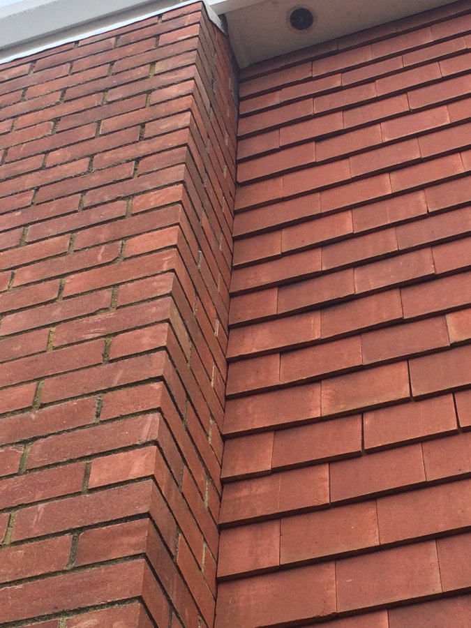

This is another pic of the exterior

There's no signs of abutment flashing soakers and stepped flashing where the tile meets the c/breast cheek?
Or it could be that its damp and salts (liquidised soot) penetrating from the chimney flues.

So fit air bricks in the exterior chimney breast just below the eaves and at the bottom, this is there at the moment which was used for emptying the ashes from the fire, so could this be made into an air brick as well? And would this provide adequate ventilation for the chimney ?

There is a lot of algae on that stack, which may indicate excessive water soaking it from the roof level. the roof covering or that flashing under the fascia might need looking at, to confirm that its not pouring water down the brickwork.
If there have been no previous damp issues, then it can be assumed that the tile hanging is not causing a problem.

My feeling is that when the rain comes from a certain direction, it gets " caught" in the corner between the tiles and the stack. So the side of the stack gets flooded and the water runs in past the edge of the tiles. The tiles should have slaters felt behind them with a waterproof seal to the side of the stack, so any water that gets in stays on the outside of the felt. This is where I feel your problem is:- No seal, bad seal, tear in felt. . . Real PITA to fix. You could prove this (perhaps?) by pushing some tissue paper up under the tiles right in the corner. Not conclusive but if it gets wet, then there is water coming down the corner the wrong side of the tiles.
