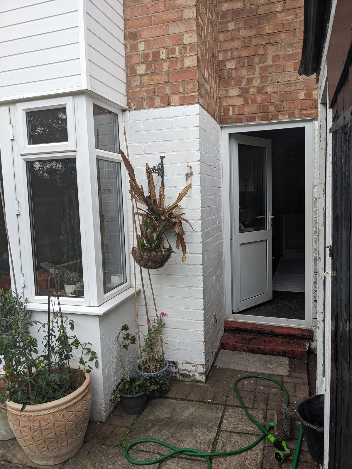

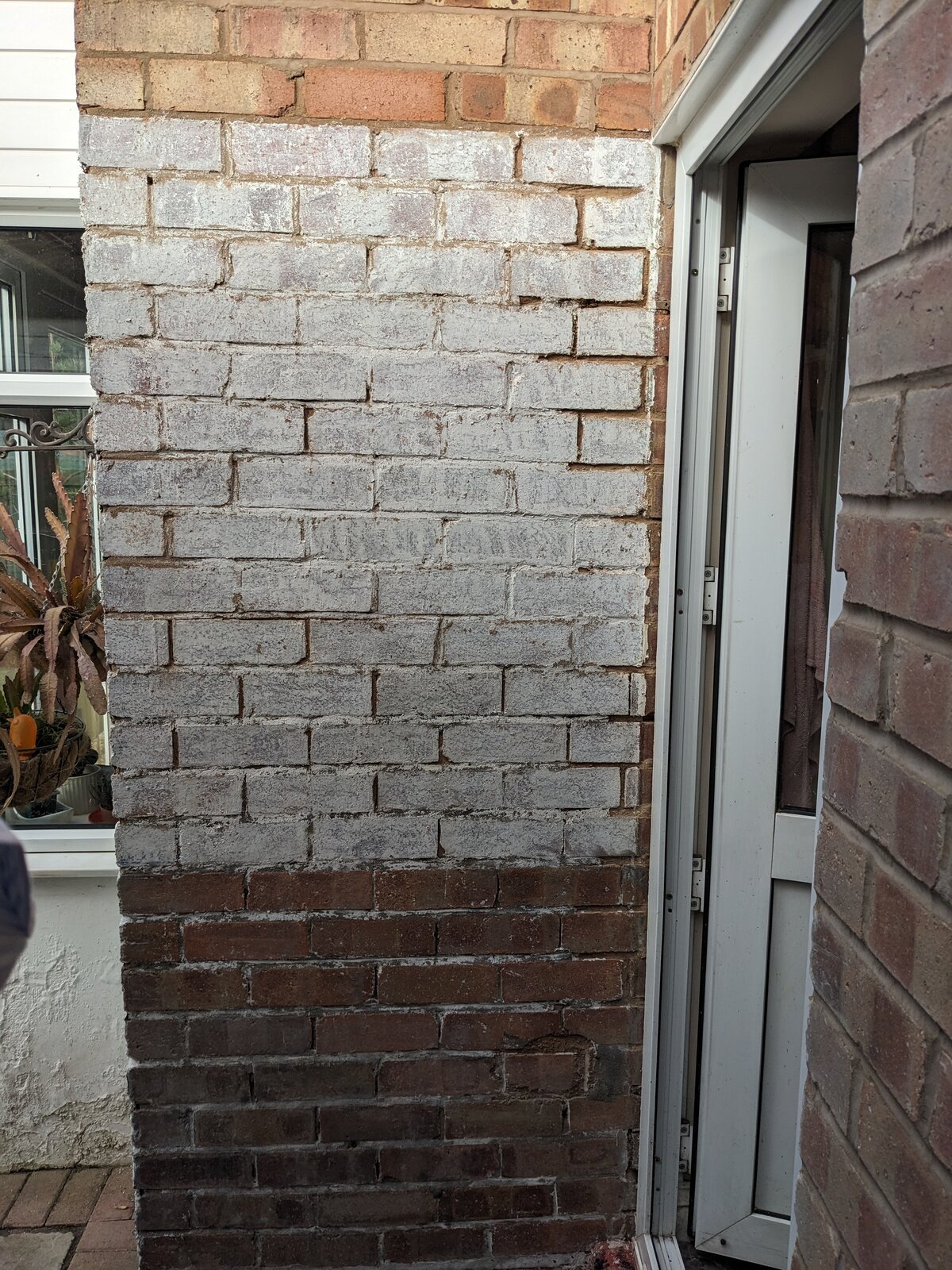

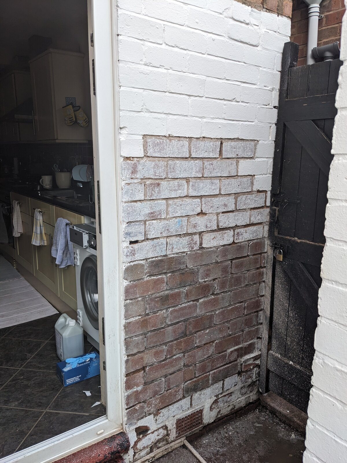

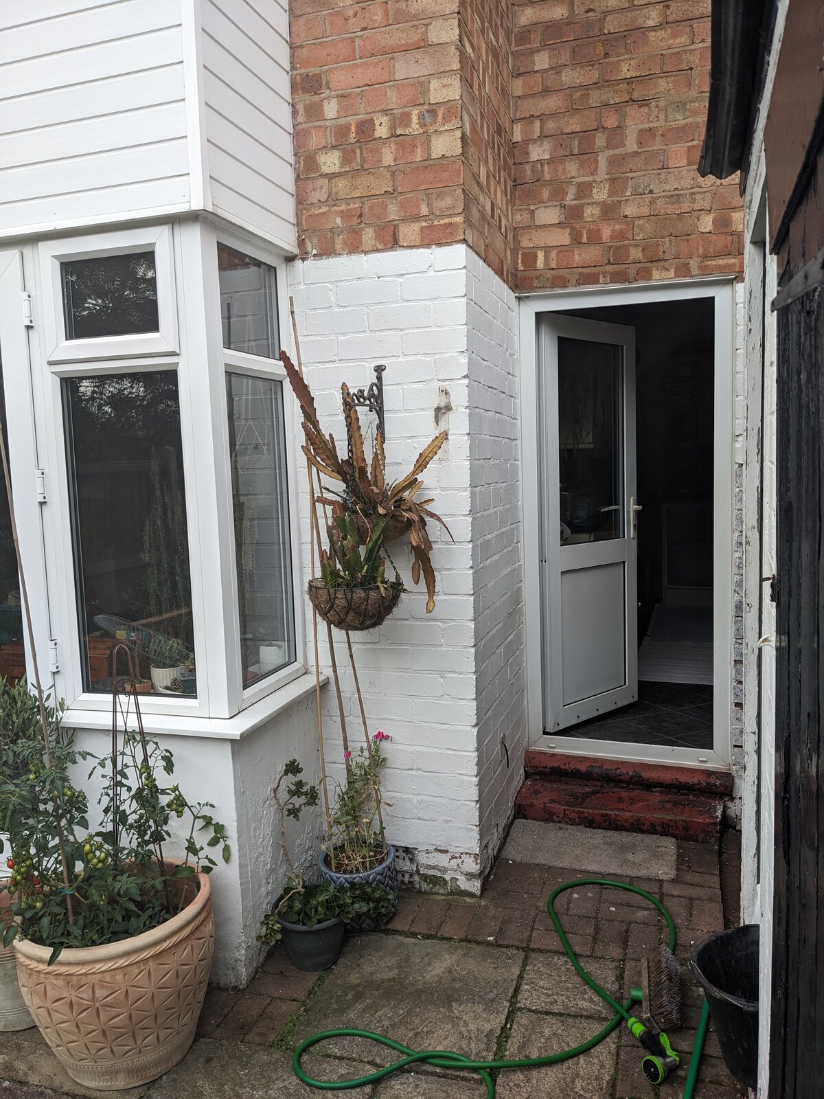

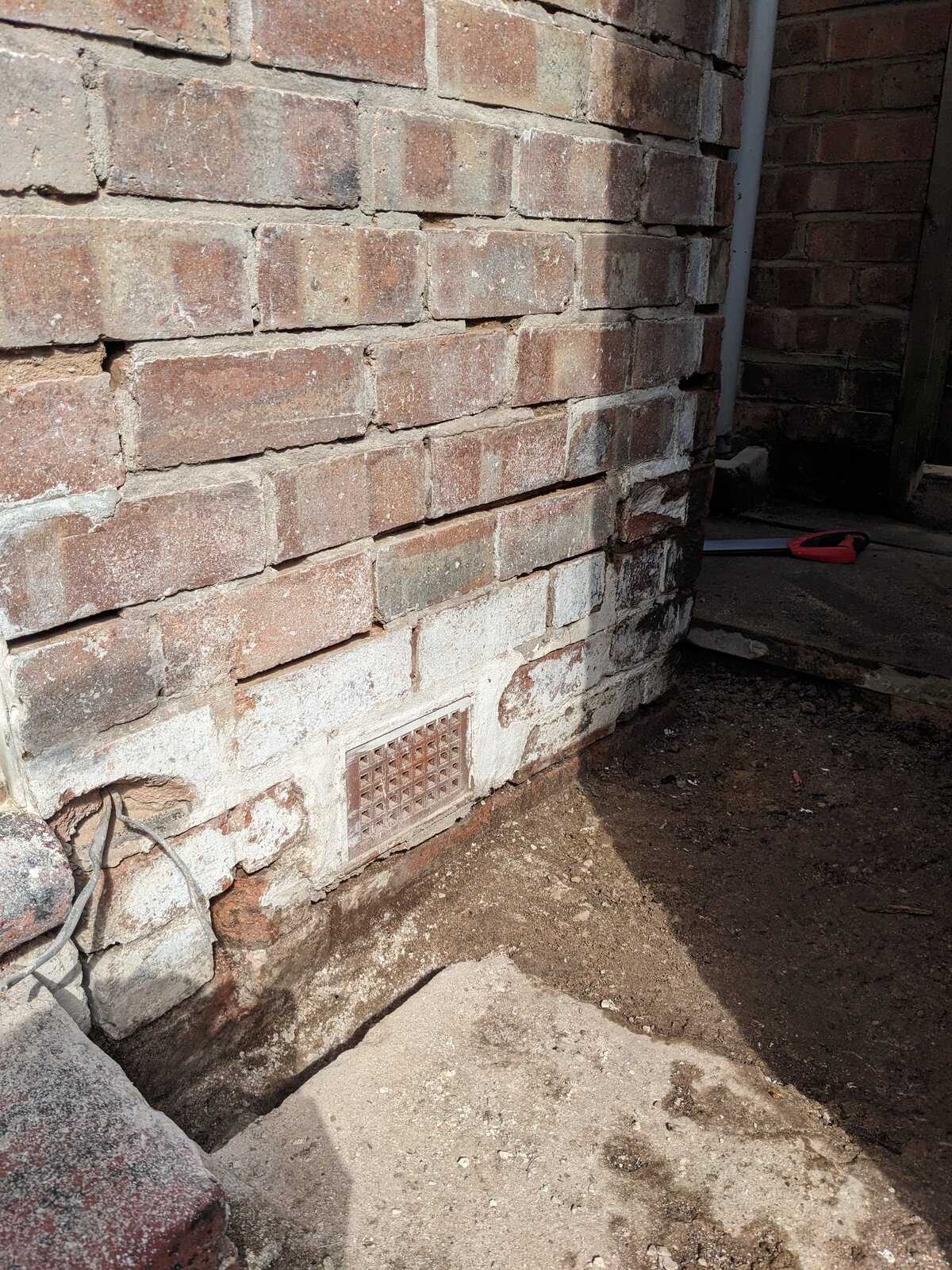

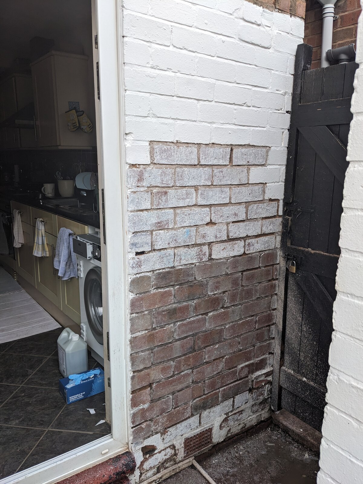

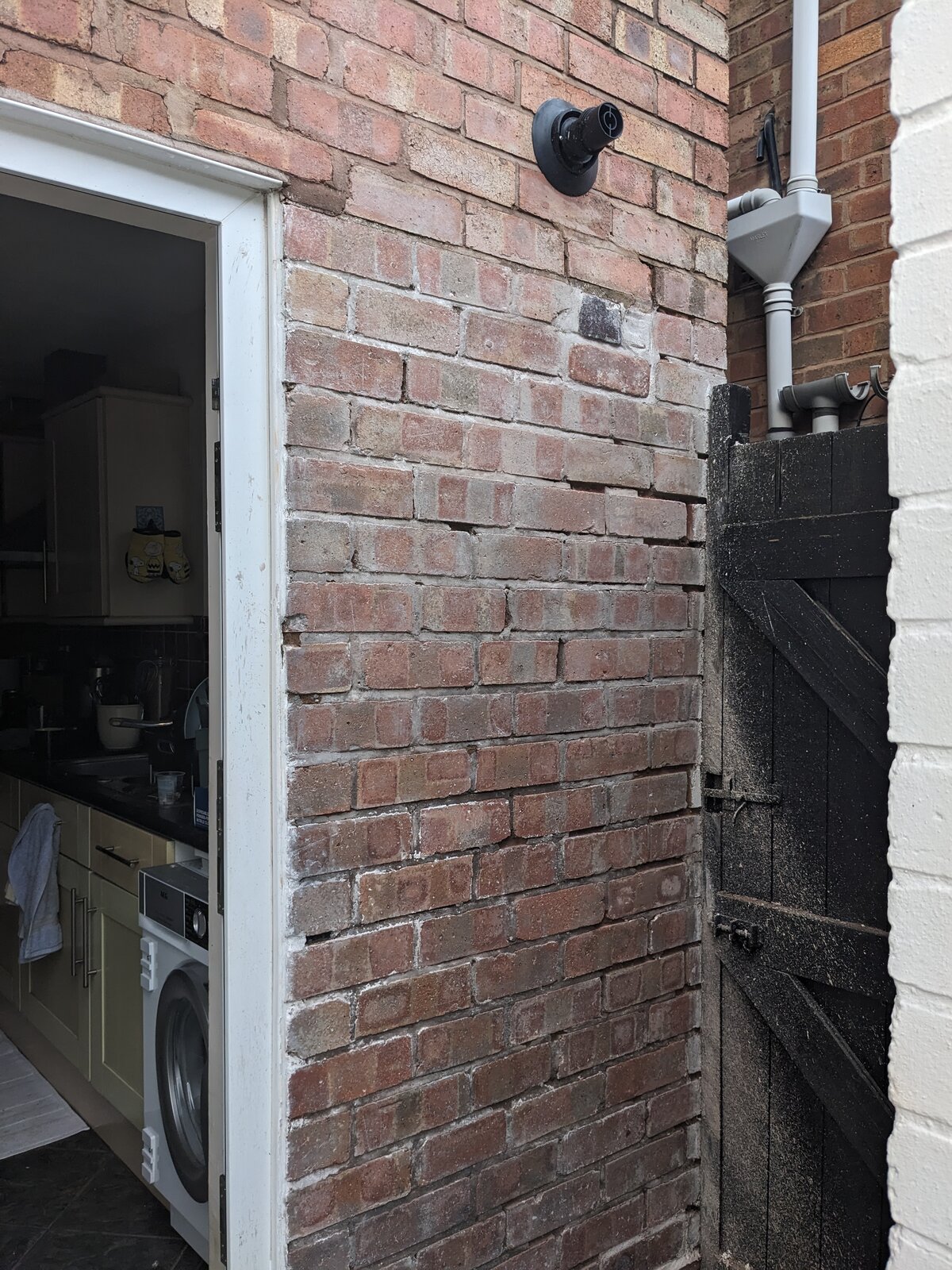

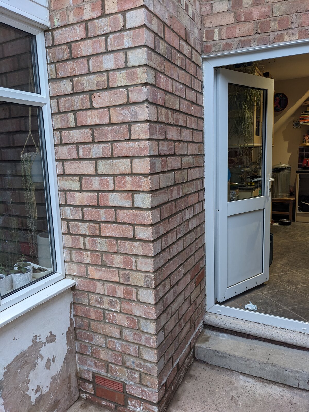

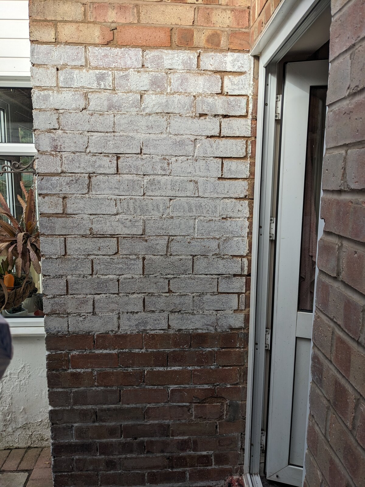

What is going on with this brick wall? (Repointed?)
16 Oct 2024
6
Why are the bricks white? Any reason besides decor/hide imperfections?
Mortar looks new?
Anything to be wary of here a buyer?
It shouldn't be, but that assumes it's a simple joint repair, not more involved roof work if the roof is nearing life end.
Best get a survey done to advise.
Thanks - Roof is tiled (maybe from the 70s) so it’s the not original but obviously can’t say if it’s in good working order or not

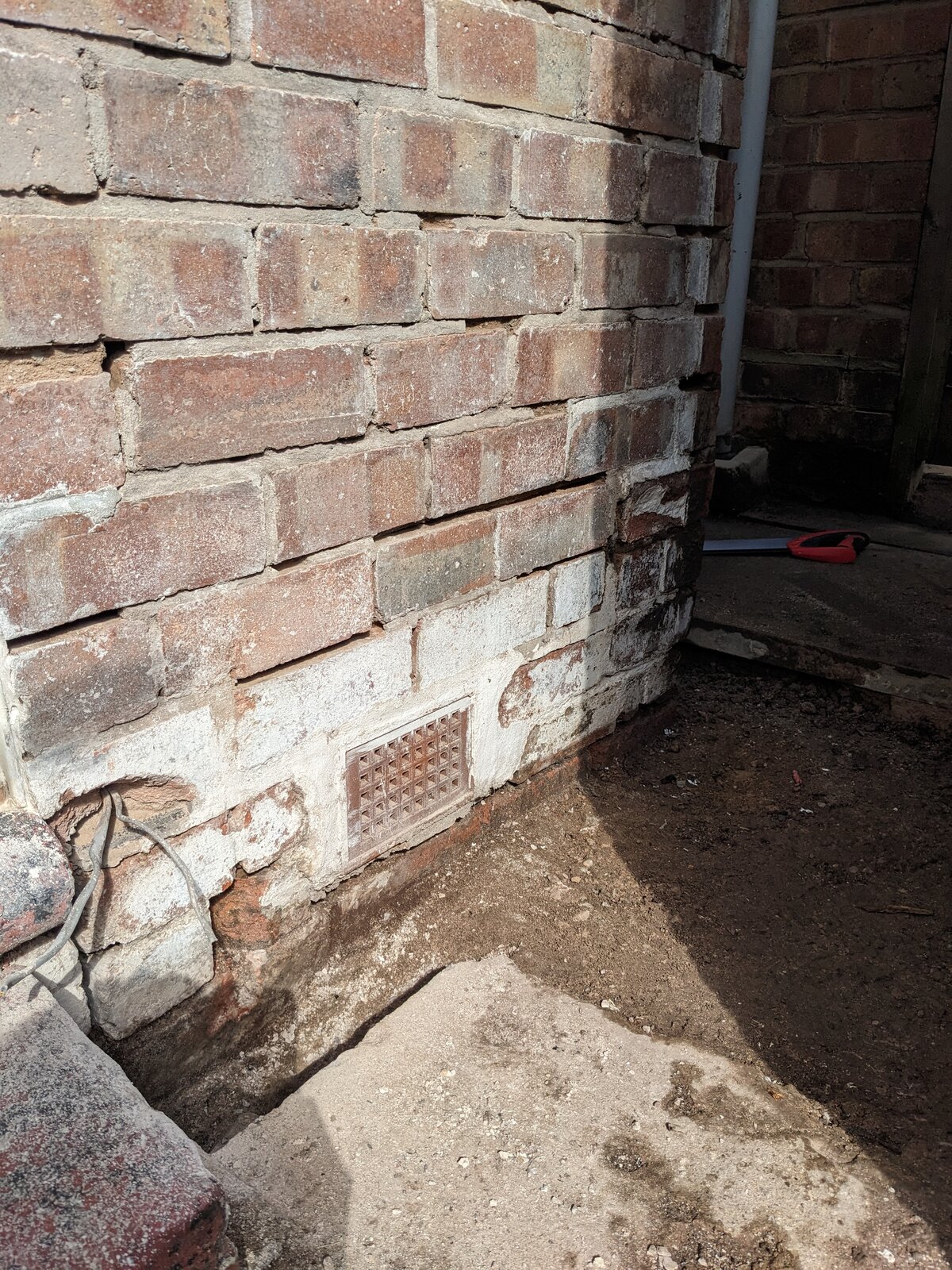

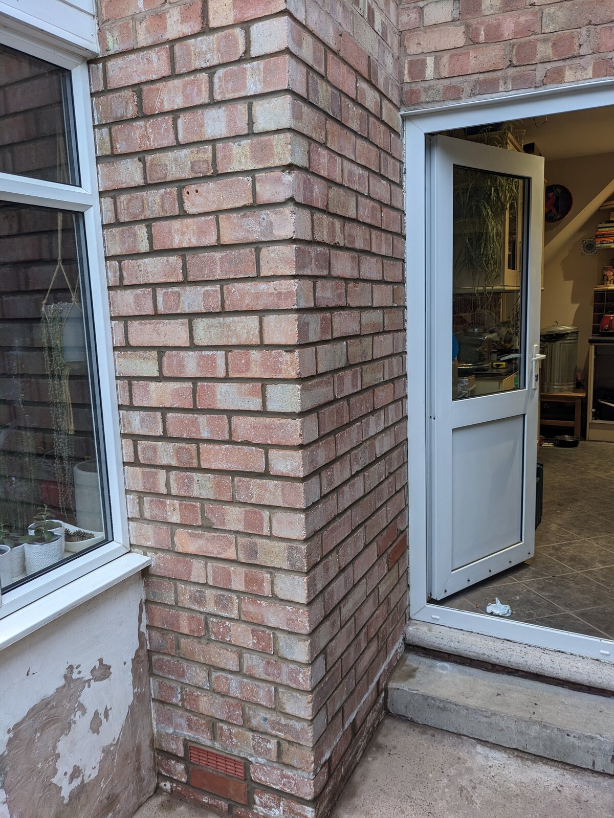

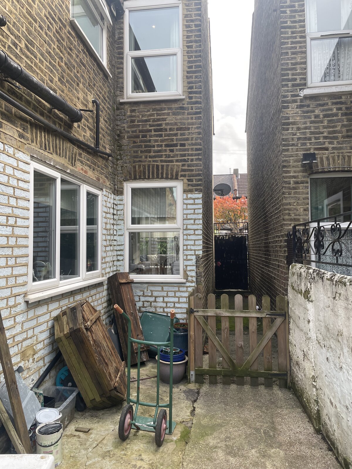

I bought a house with painted walls at the back, it took me weeks of work to strip this unsuitable non breathable paint from a brick wall done by previous owners which was hiding badly deteriorated brickwork and terrible quality pointing.
It is the height of laziness to paint over a brick wall to hide imperfections instead of getting it repaired properly. That pointing being proud will make it a nightmare to get off as well.
