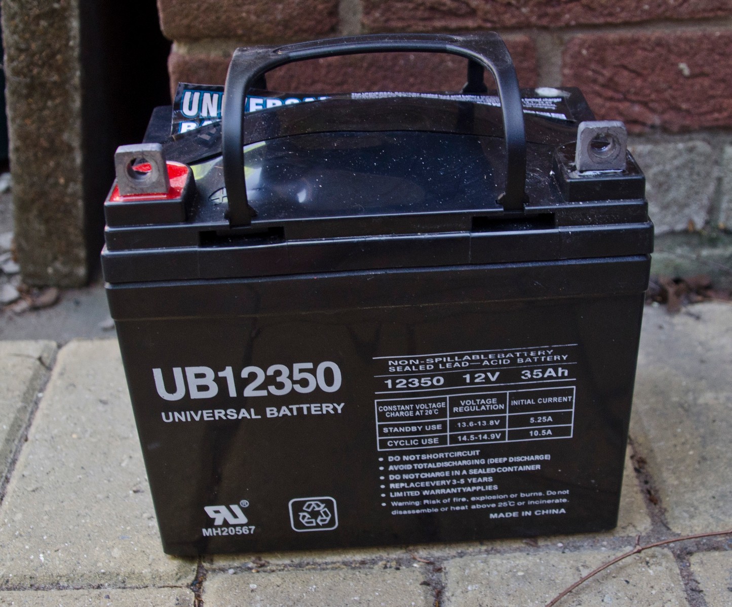

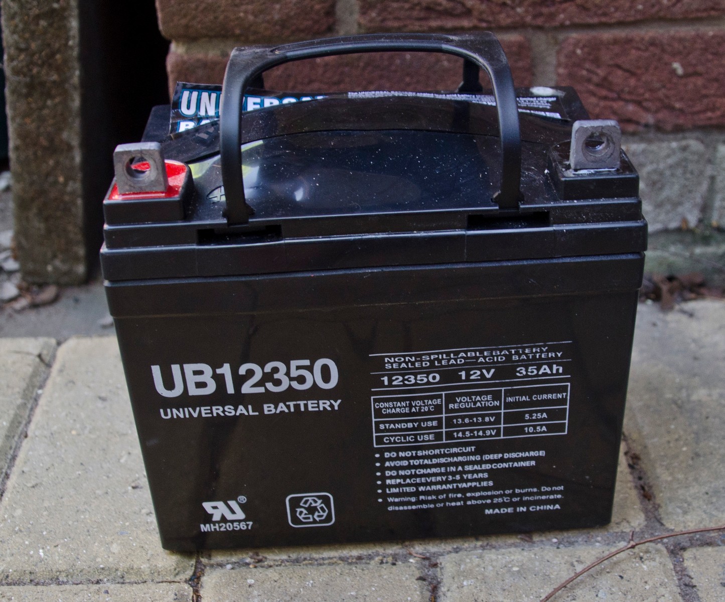

I use a so called smart car battery charger, the main reason is once it reduces from 3.7 amp to 3 amp to 0.8 amp it will not return to 3.7 amp. It will move between 0.8, 0.1, and zero, but will not return to 3.7 amp without pressing a button, and after having a mobility scooter battery fry when a cell went down, having an automatic charger not return to max output is good.
But it is not really that smart, it just measures the voltage, and at set voltages it reduces the charge rate, so left on charge the battery alternates between 12.8 and 14.4 volt, once it hits 14.4 volt it turns off or down, until voltage drops to 12.8 volt at which point it turns on or up, so in the main battery sits at 12.9 volt, and once every few days it charges to 14.4 volt, which is better for the battery than being held at 13.8 volt.
It is a battery charger which I can switch on and forget about. And it can be used on valve regulated lead acid, or absorbed glass mat is the other name.
I was really surprised to see the damage to the good 35 Ah AGM battery when the other one of the pair had a shorted cell, the charger was only 4 amp, but it still damaged the battery case due to over charging. DSC_3936.jpg this was the good one of pair, not any more.
What is odd to me is the cheap Lidi battery charger has the safety feature and will not return to full charge rate, but the far more expensive CTEK one will return to full output. Although that does mean it can be used to maintain caravan batteries while caravan in use.
The much larger version used in the narrow boat (35 amp output) had a timer built in, and would reduce from 14.8 or 14.4 volt to 13.4 volt once timer had timed out. But that charger was not called a smart charger, it was just called a stage charger, although the little 3.8 amp chargers are really stage chargers, they have got that label "Smart".
