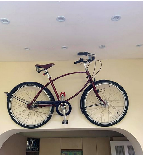

Many people seem to think the only down light is a MR16, clearly from your link you actually mean down lights in general not just MR16 lamps. However buying a lamp which does not say how big it is, it only says how far it goes into the ceiling is not some thing I would do, however my son has found some really cheap MR16 lamps and has filled the ceiling with them, no fire risk as no room above, but the work involved in wiring up would cost a fortune if your paying some one to do it, and it actually used more power than the LED taken down, it was 22 watt now 9 x 3.5 watt. OK must admit it looks better, this Kitchen bike.jpg is not my idea of looking good, and my daughter in law is not too happy either at what my son has done to her bike.
