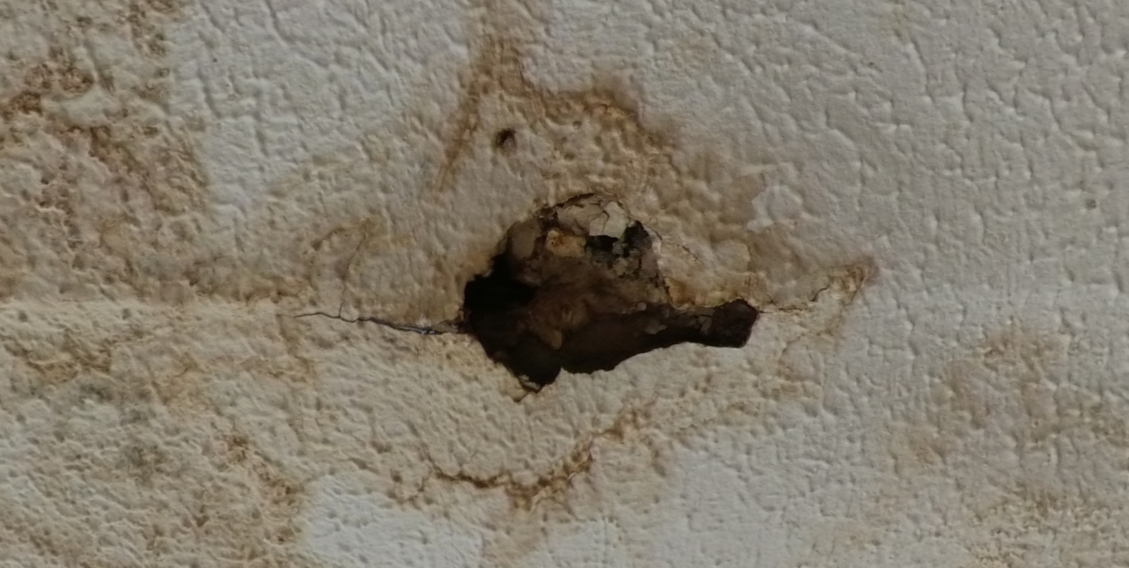

What is the brown colour in this damp ceiling?
28 Dec 2008
161
Southampton
We're looking at purchasing a house that has a flat concrete slab roof. (actually all the houses are all concrete slab in the area).
The asphalt roof needs replacing.
But is it normal for rotting artex to be this brown colour?
Could just be water stain from a leak. Or, more concerning, perhaps stain from rusting rebar in the concrete.
At some stage the Artex will have to be removed so that the background can be examined.
The Artex removal will have to be done by asbestos removal specialists.
At the same time the asphalt will also need removing so that the surface of the slab can be examined.
Slab roofs were often installed in the thirties & fifties but Artex only began to be used much later so perhaps the Artex was applied to cover up damage as the slab began to fail?
I work in the Building Trades and I'd hesitate before buying a house with a concrete roof - however, I do understand the desire for a home at a reasonable price.
Usually, it means the property is a fixer-up, and fixing up costs have to be realistically faced - typically, that slab roof has outlived its expected life.
The brown is all the crap in whatever material the water went through to get there.
You don't need to be a specialist to remove textured coated ceilings. It's non licensed work, so just need to be asbestos aware and remove it (the plasterboard) in an approved way with little disturbance.
