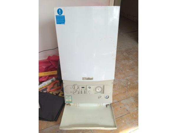

What is the model no of this boiler please
Have you looked for any stickers on the top of the casing or on the back of the electronics 'box'?

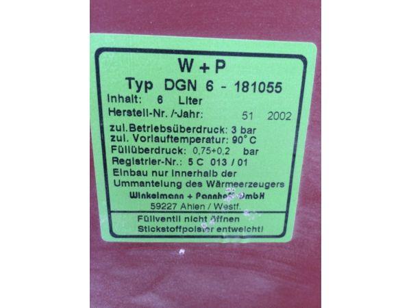

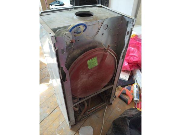

I think that the green sticker in your photo is for a 6 Litre expansion vessel. Your photo of the label has a reddish background, which would be likely for an expansion vessel. Is this the same label as the one at the bottom left on the boiler ? The layout and writing look different. Perhaps it is just a service label stuck on the boiler, yes ?

Yes I see 3 images. I was just wondering what the label was at front bottom left of the boiler below the 2 knobs.
andytw
Undo the two quarter turn screws at the front on grey panel on the back of this is a data badge,
Is it so you can list correctly on fleabay
