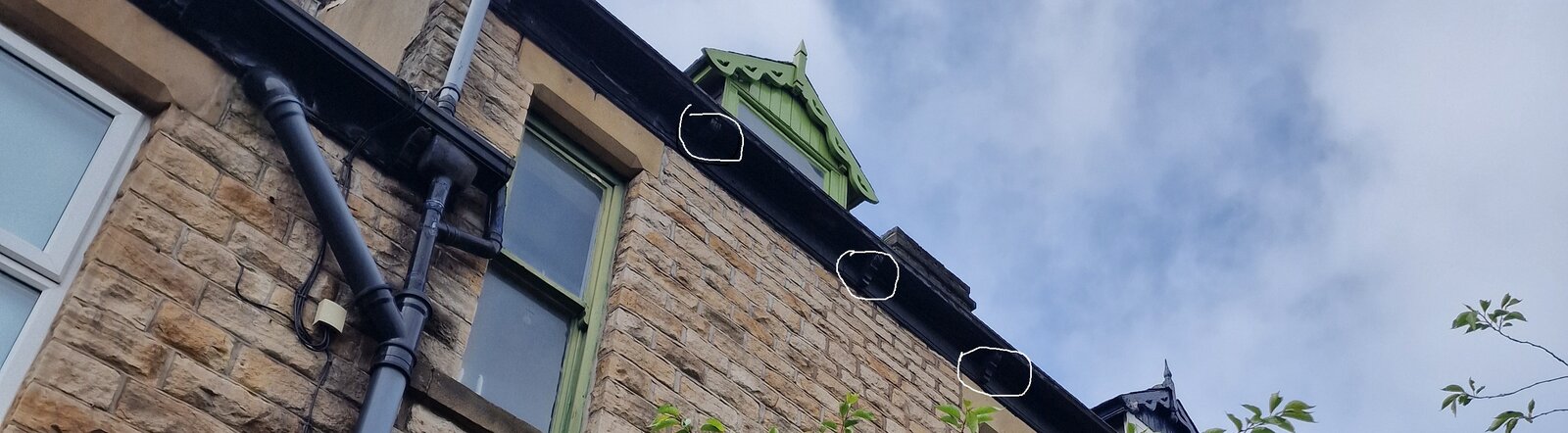

Hi,
My house has wooden wedges rather than plastic brackets to hold up the guttering. Do you know what these wedges are called and where I can buy them?

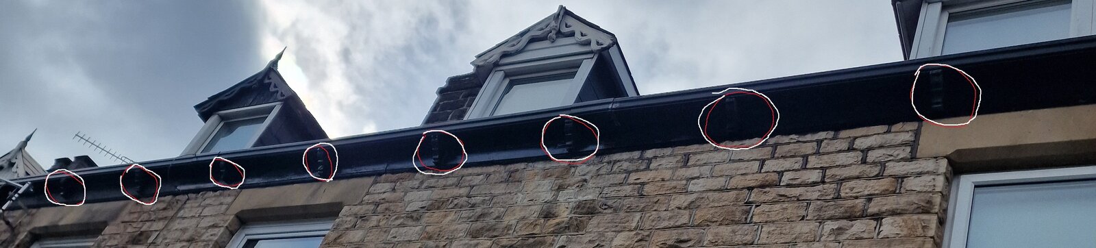

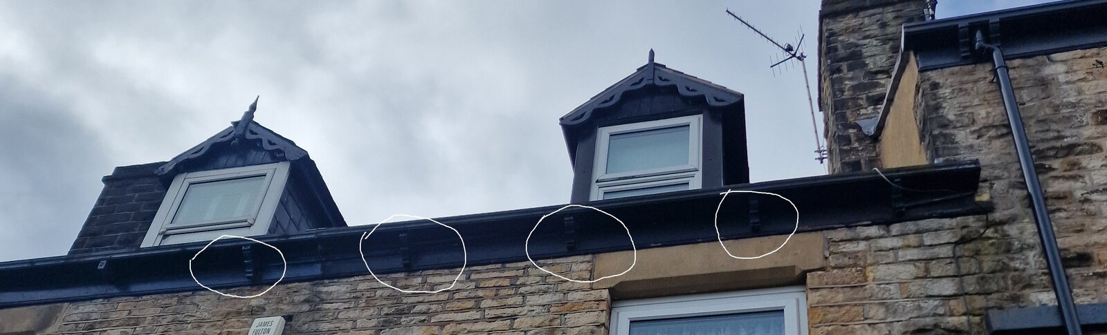

Here are photos of examples of what I'm referring to

They look like carpented / wooden wedge-shaped blocks, but I don't know what they're called.
ahh ok not what i thought
extension off floor/roof timbers perhaps ??
A joiner can make them up for you or take one into a joiners workshop and ask them to make copies.
I had two corbels fall off, but don't remember this happening. I believe the guttering was good when I first moved into our home. I need to get scaffolding up and get a bracket put up to hoist the guttering where it sags ever so slightly. A roofer added one bracket already, but couldn't get to the sag because of sloping ground. The guttering has a square (not round) profile when you look along its length. What sort of bracket would be best to use for this? Also, do corbels have a mechanism where they screw into the guttering as well as the wall/facias to stop the guttering from sliding away from the roof/wall?
