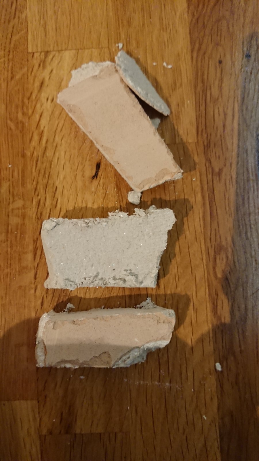

I've found this board used for a ceiling in the original part of my 1930s bungalow. It looks similar to plasterboard but there is no paper facing on either side and there are shiny speckles in it. The back is grooved.
Is this an old form of plasterboard or something else? I'm hoping the fibres aren't the dreaded asbestos. I'm guessing not because there aren't any fibres coming out of the board.

Suggest you Google "Vermiculite" that material does have the "shiny bits" visible.
There appears to have possible some cross contamination between Vermiculite and one of the forms of Asbestos, again Google Vermiculite and the date your property was constructed?
If it were me I would be getting the material tested.
As for not being able to see "Fibers" simply put, you will not see them to locate and identify Asbestos, you have to use a Microscope, the fibers are Nano-Meters in length and diameter.

You can't see asbestos fibres unless under a microscope, but that does look look like AIB (Asbestos insulation board) and this may well have a smooth side and an indented side with something lie a basket-weave or tiny grid-like pattern.
If it snaps easily then you are OK, its a fibre board. If it difficult then it may be an asbestos board.
I would treat that with caution certainly get a sample checked, a lot of the "asbestos replacement boards" did have shiney mica bits in them it but that is by no means a reliable way to identify it.
OK thanks all. I'll stop work until tested.TThe material is hard and snappable whereas my reading says AIB is soft and friable?

Woohoo, the report came back today and no asbestos. Glad I got it tested, better safe than sorry.
Any idea what else it might be? Cement board? It's harder, stronger and slightly thicker than plasterboard and not paper faced.
Good news! Lots of asbestos replacement boards around, might be masterboard I think that was one of them.
