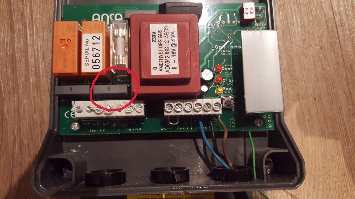

It's an electric garage door, does anyone know what the component circled in red is? Secondly, does anyone know how I'd fix it as the component has come off the circuit board at one end.

It is a plastic film capacitor. You will need to solder it in. If it has been forced off of the circuit board, the board may be damaged which may be very difficult to repair, as this board has at least 2 circuit layers.
There is also mains voltage at this point and in this area of the PCB so great care must be taken to ensure that any repair does not cause any safety hazards.
Thanks freddo. The break seems to be in the leg of the capacitor, so hopefully someone can carefully melt the solder and remove it then add a new one.
Any idea if I can pick up the matching component from anywhere? I've emailed the manufacturer but feel it's unlikely they'll supply one...
If the leg has just snapped the PCB will likely be fine, however some skill is needed to prevent damage when unsoldering the leg and the other leg of the capacitor.
It looks like a standard part, you will need to match the component ratings and capacitor type exactly. They will be printed on one of the larger sides of the capacitor. It will likely be a class X (or possibly class Y) capacitor and will probably marked X2 or similar on it. The replacement must be the same specification.

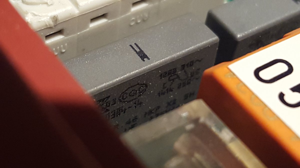

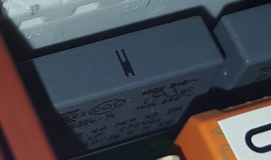

Thanks Freddo; it definitely has an X2 on it. Other components are in the way so I cannot see all the markings, but this image shows the legible bits:

It appers to be an Epcos MKP style X2 rated capacitor. I can't tell you what value it is as that (important!) information is hidden behind something in that photo!

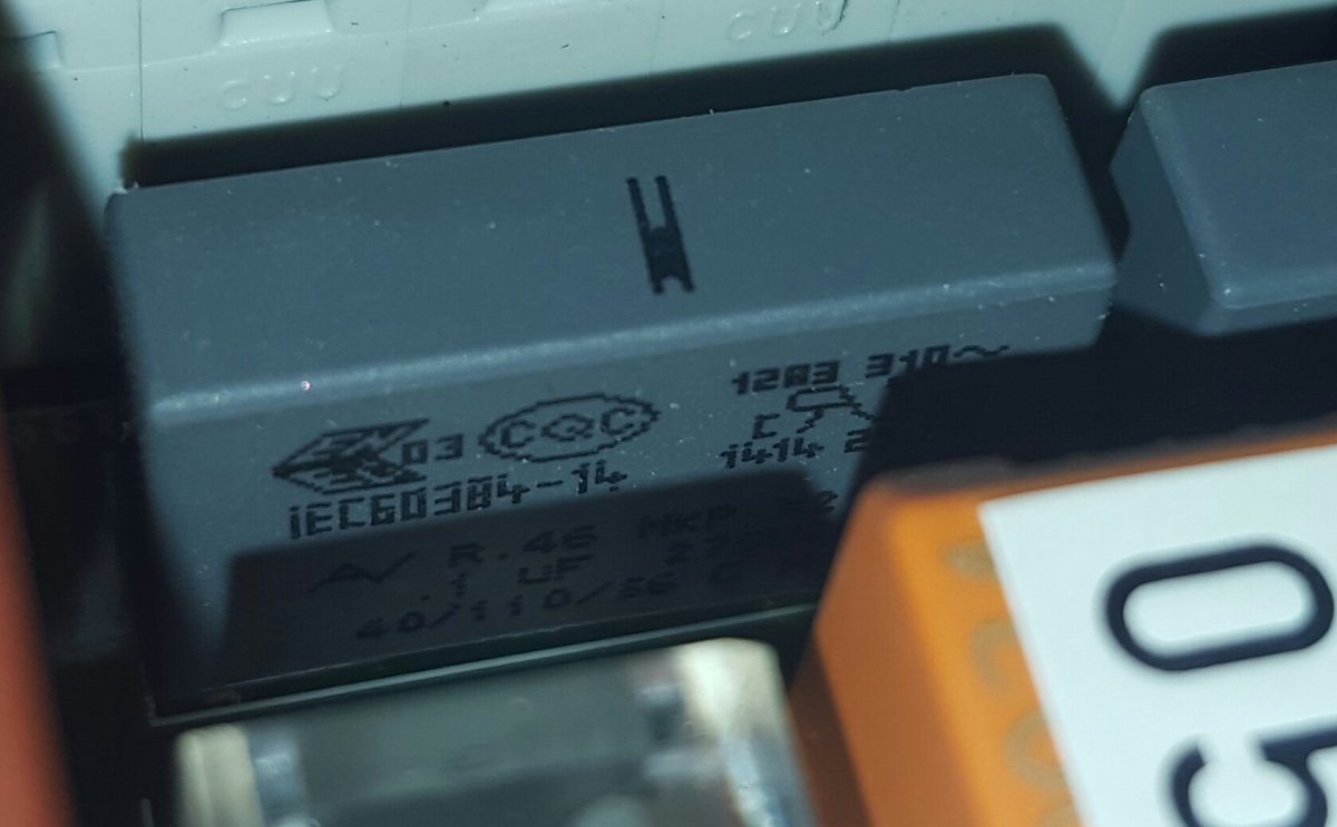

How are these photos, any better?

Yes it's rated 0.1μF (100nF). It is available from RS, part number 875-2245 here. (Ignore the photo it has a different rating)
I was wrong it's made by Kemet not Epcos.
