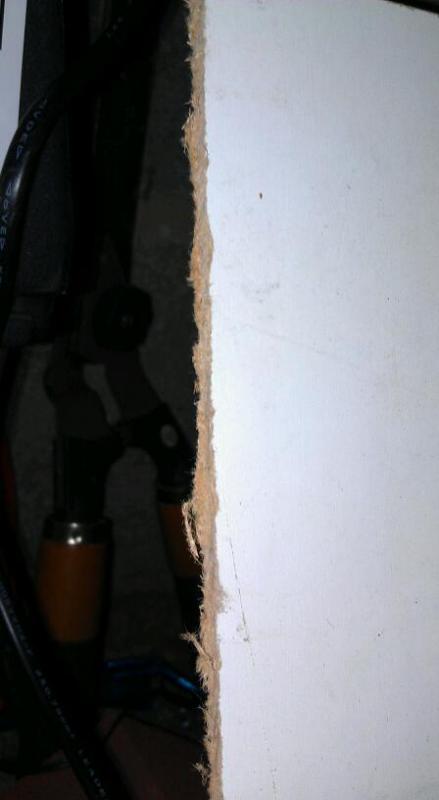

I have moved house and I was clearing out the garage that the last owner had left and behind the wood I found a small pannel, white in colour and with a brown material inside that looks like fibre. I thought it could be asbestos insulation board. I have attached a picture so you can see

softboard is soft and white on the face hardboard is hard

I have been looking for pictures of soft and hard board but I can't seem to find any that show the fibres like in the picture. Is the fibre just wood or does it have asbestos in it?
It's just glorified cardboard. There's no asbestos in that.. You'll find the same thing at the back of every kitchen cupboard.

Softboard – The surface texture for unfaced natural panels is open and fibrous. Paper-faced
or fine pulp overlaid softboard have smooth or lightly dimpled faces, or a slight mesh pattern
on one or both sides. The colour of most boards is various shades of light brown, others are
cream or off-white. Some panels are covered with a white primer or bleached pulp for painting.
Softboards with enhanced durability and moisture resistance are produced. Currently these
enhanced properties are imparted by impregnating the fibres with a bitumen emulsion; a spray
coating on one or both surfaces may also be applied. The same characteristics can be imparted
with the inclusion of phenolic resins. Typical bitumen impregnated panels are dark brown to
black in colour.
