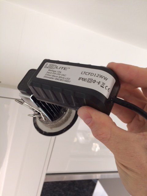

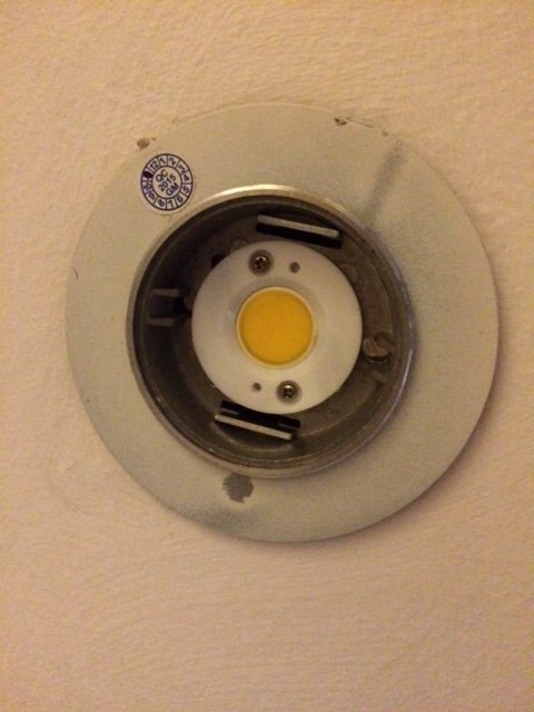

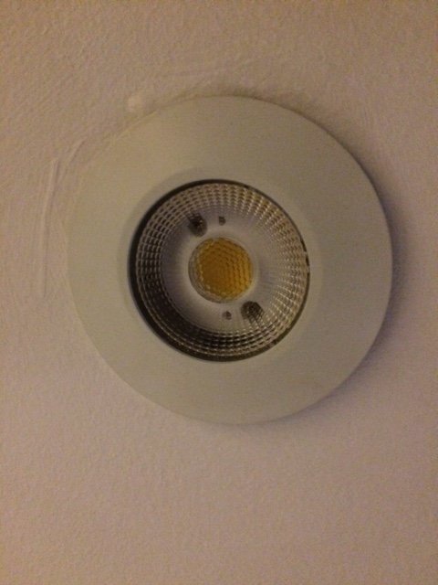

I've got a downlight in the kitchen that's been flickering. I've opened it up, and it looks like there are torx screws in there (please see the photos).
1. What kind of downlight is this?
2. Can I replace the bulb in this unit myself?
Thanks!
Ernst

The LED shown in your fitting suggests it is highly likely there will be a constant current driver unit between the 230v switched supply and the light fitting. There will be a driver for each of the fittings, so substitute a known working driver to the suspect LED and confirm which is faulty.
The yellow coloured silicone covering the leds often discolours when the leds fail, and yours appears to be ok, hence the need to confirm the condition of the driver.
If required replacement leds of that form factor are available from RS components amongst others.
Hi Raykf
Thank very much. I've popped out the unit and found it here: https://www.tlc-direct.co.uk/Products/LTCFD12WW.html
It looks like it's been discontinued I'm afraid. Does't look like the driver can be replaced easily either. If anyone knows what the latest version is of this unit, so that I may find a replacement, that would be very much appreciated.
http://www.primelight.co.uk/product...-dimmable-constant-current/voltage-led-driver
These can be configured for 12 Watt operation.
One of these units would be electrically suitable, however the physical wiring arrangements would require modification.
Your principal choices are to replace with a complete new fitting or modify the existing fitting to accommodate a third party driver as above.
