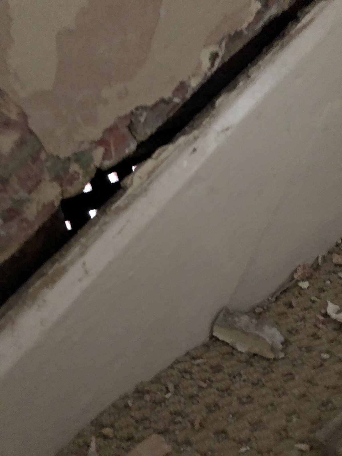

What kind of filling or materials do I need for this type of gap between stair stringer and wall
9 Jun 2020
27
There’s a big gap between the stair stringer and wall, where I can now see my bricks and outside my house. What should I use to fill this gap in. Also if it helps, some cement that has come off has fallen in between the gap of the stair and walls, so there must be some space there too. Please help!

It could be a good idea to have the plaster made good between the stringer and the wall, before using a length of timber moulding pinned on to make it look neat......just an option before chucking a load of filler in.

Expanding foam/insulation and plaster or a timber cover strip
But you need to sort that air brick out. Where is it venting to, where is the liner?

I’m not sure where the air brick is venting to, but it’s at the top of my stairs. There’s no vent at the top of my stairs as it was just covered by the plaster. I didn’t think it’d be venting for the underfloor as it’s too high up, so really unsure what it’s venting to.
If your picture is of the top stair riser and the landing edge then the air brick is probably trying to vent under your upstairs floor.
Can you post a shot from further away to put it in context?
I’ve used foam to cover the gap. You’re probably right, the air brick is probably venting to the upstairs underfloor. Good thing I didn’t block off the air brick.

Upper floors are not ventilated.
The air brick would either be ventilating a wall cavity - in which case you would not see it from the inside, or the cubby hole under the stairs in which case it needs a wall liner.
