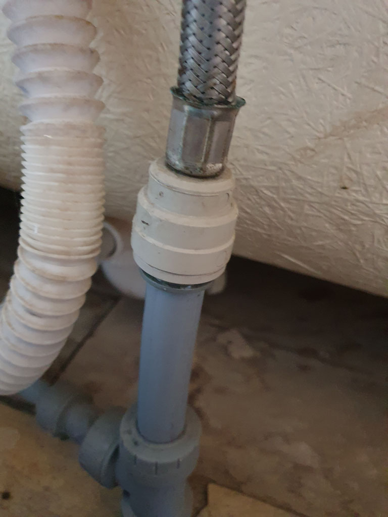

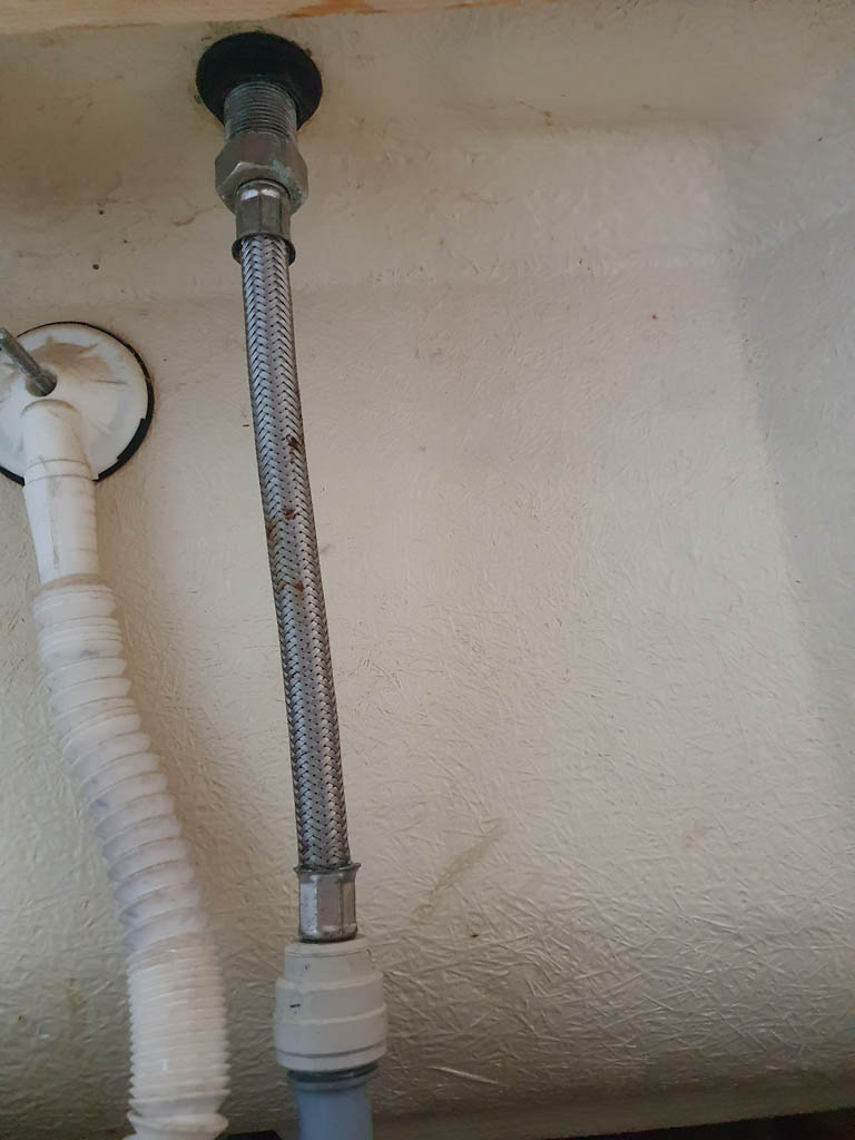

What kind of tap flexi hose connection is this please?
28 Dec 2009
70
Devon
Hi, as part of this thread:
https://www.diynot.com/diy/threads/black-bits-in-bath-from-hot-water-tap-and-shower.613095/
I am replacing the flexi hose that goes to the hot water tap in the bath as I think the rubber may be failing inside. I am getting a replacement hose but I don't recognise the bottom attachment that connects it to the plastic pipework, the ones I see have metal connectors both end. Anyone know what I need to get please as planning a trip to screwfix/toolstation soon! Two pics here:
Dan
Hi Dan,
just search or ask for a push fit flexible hose tap connector, or use a compression ended type.
