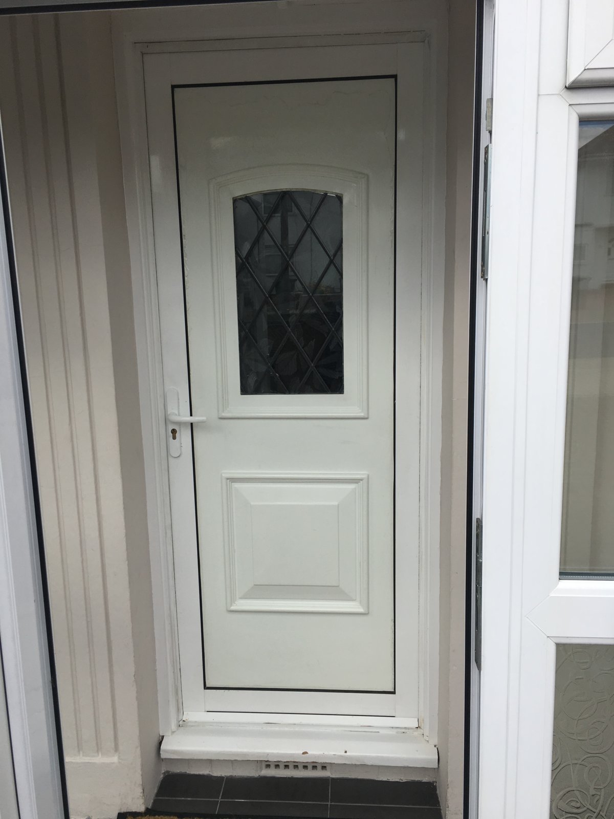

What kind of UPVC door is this ?
21 Aug 2019
310
9

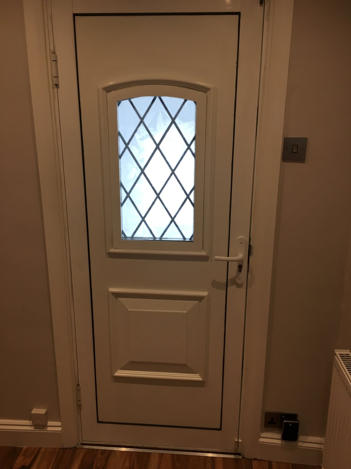

Hi need help I need to replace the UPVC door panel on this door what kind of door is it what is the specific name and also where can I buy replacement door panels as the panel is cracked and faulty thank you
The panel will have different names from different panel companies .... Vista Panels call it a Victorian for example , whereas Hallmark Panels call it Bicton ( I think ) . They are known as infill panels and either a local double glazing firm could get you one or you could go direct to one of the online suppliers. Im pretty sure Vista Panels will let you order online. You will need to know the size and the thickness of the panel
Hope that helps
Looks like an aluminum door to me which makes things trickier.
Will be a wrap around panel glaze so you will need to remove and dismantle the door slab, Also the panels will be trickier to find from non trade sources.
