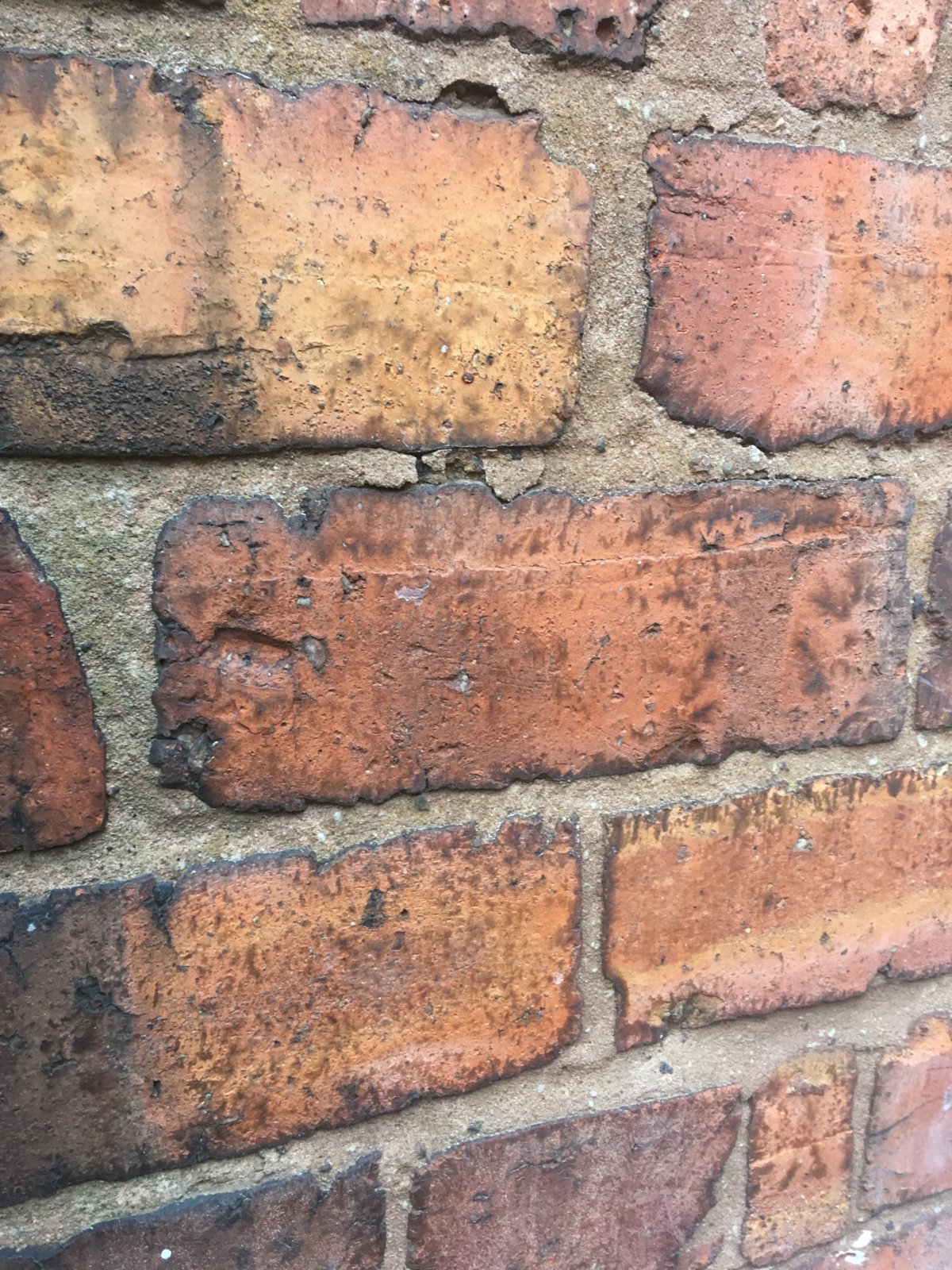

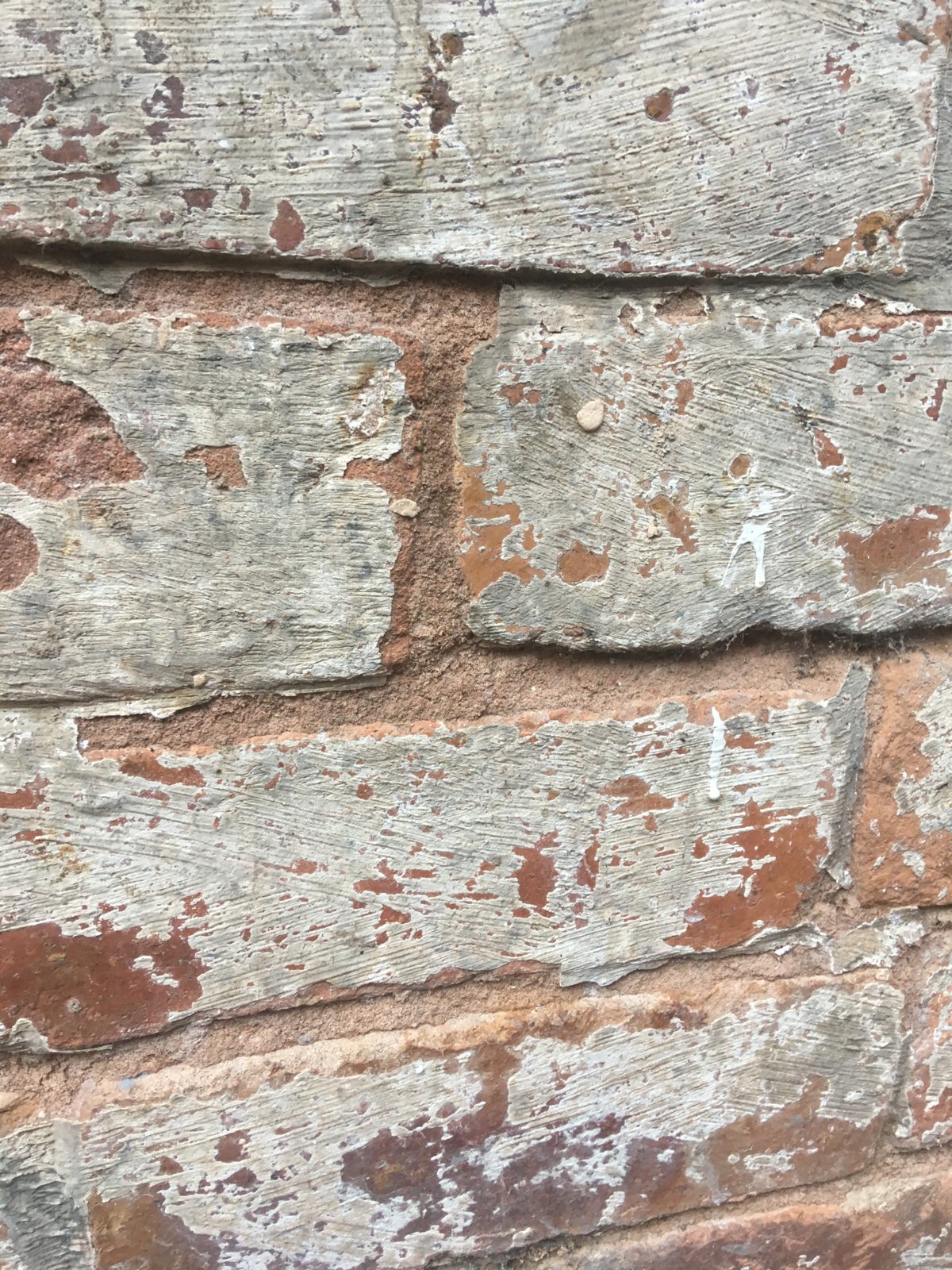

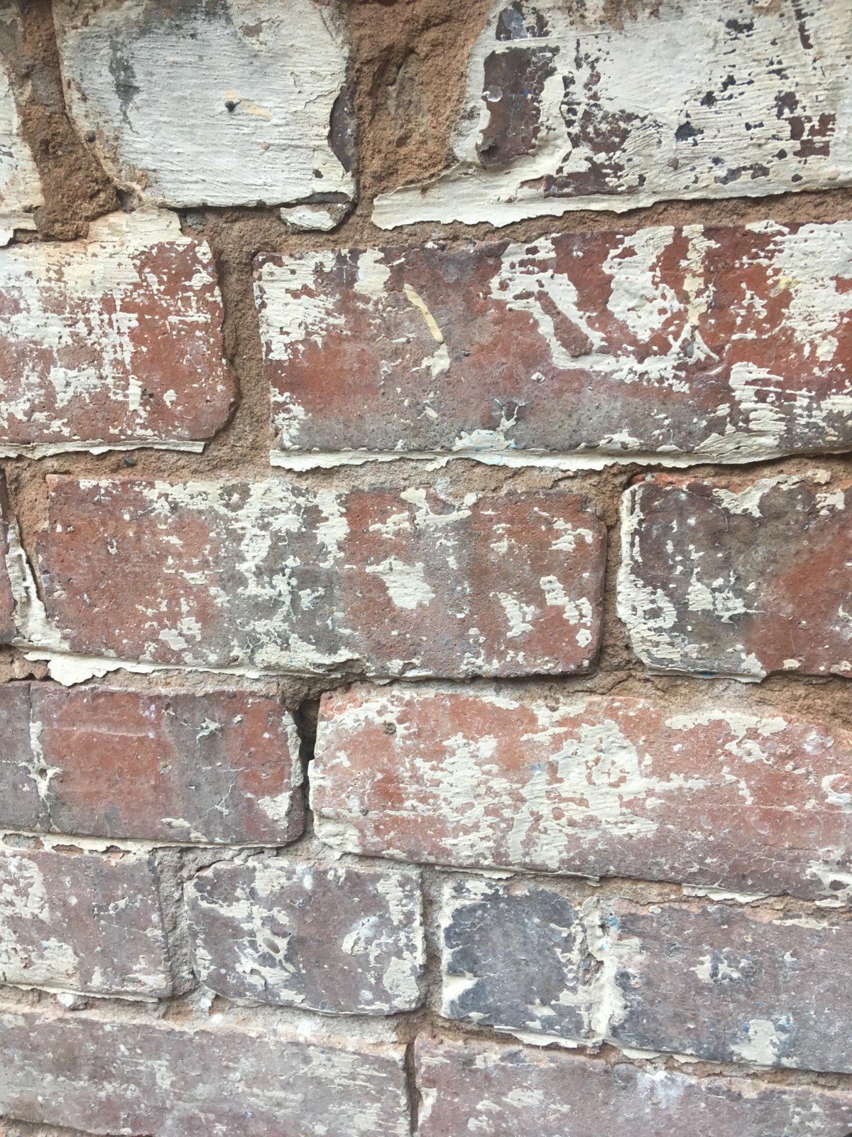

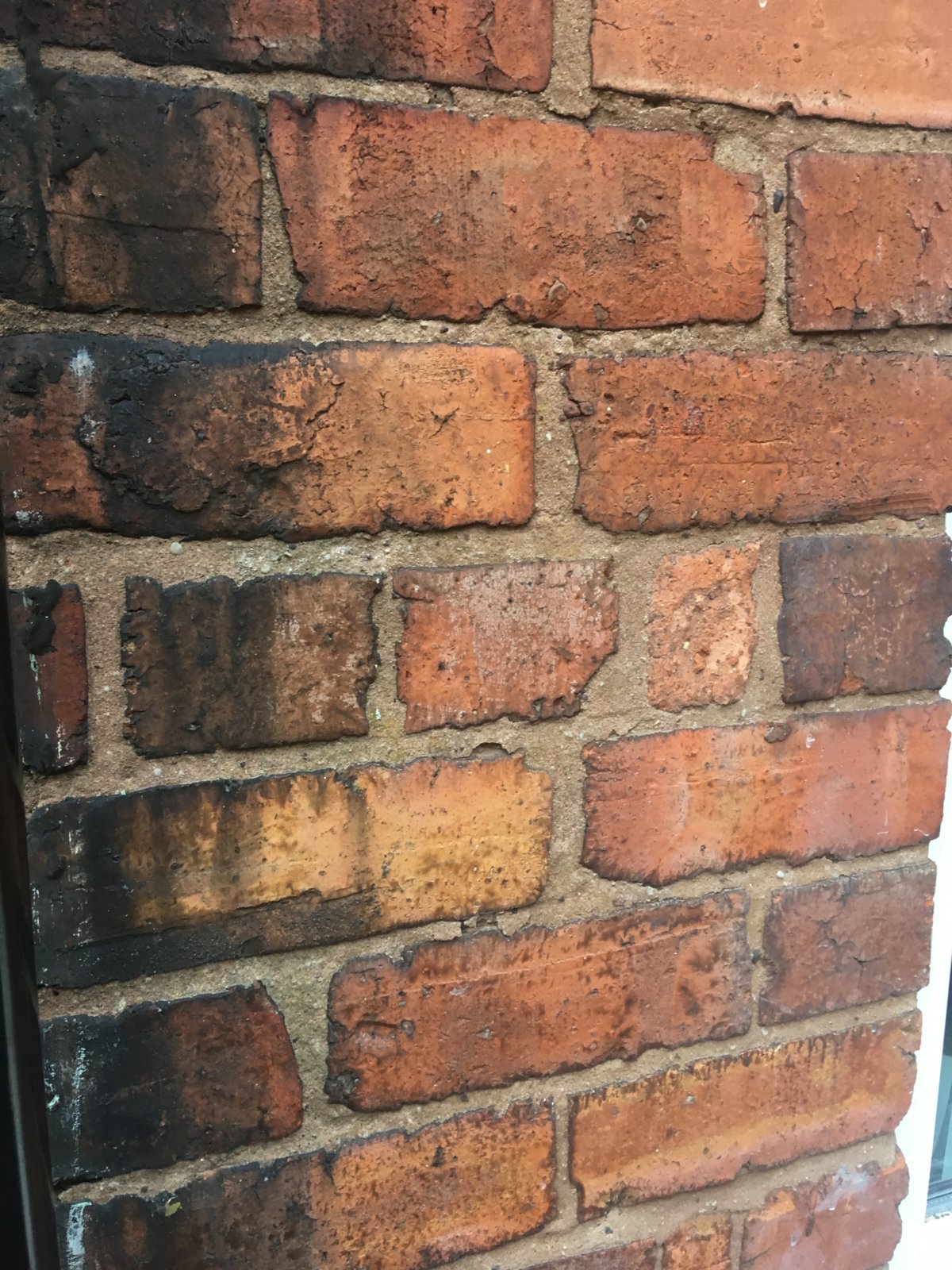

Hi there,
Having repaired my underground drainage, I’m looking to repoint the wall. It’s been suggested to me by a builder quoting that the mortar is cement based but my terrace house was built in 1890 so I expected it to be lime. Ive taken a few pics, and I appreciate it’s difficult to tell by pictures alone, but is anyone able to confirm if my mortar is lime or cement please? The pics are all the same wall so I’m hoping it’s all the same type of mortar.
Also, as an add on,in a previous post, I asked about cleaning the bricks off or painting.. If it’s lime mortar I’d rather try and clean the paint off the bricks than paint as I’m guessing breathable paint is costly. Again, I know it’s probably even more difficult to tell what paint it is on a picture but can anyone suggest a method of cleaning the bricks please. We are looking to move soon so it’s simply for appearance to sell so hope not to fork out on a sand blasting type firm.

Looks like it may have been over pointed with cement.
If you can see white flecks in it then it's lime. If you scrape some out and put vinegar on then lime will fizz or have bubbles.
Ok Stuart. Thanks. Am I right I’m thinking from the year the property was built and the type of bricks then the mortar should be lime?
The chances are that the original will be lime mortar. Although OPC was around at that time, it wasn't until the 20's and 30's that it started getting popular to gauge into the mortar.
Brilliant, thankyou, and do you think that although the house has stood for years having been pointed in cement it would be better to re do it in lime?? Particularly the lower parts?
