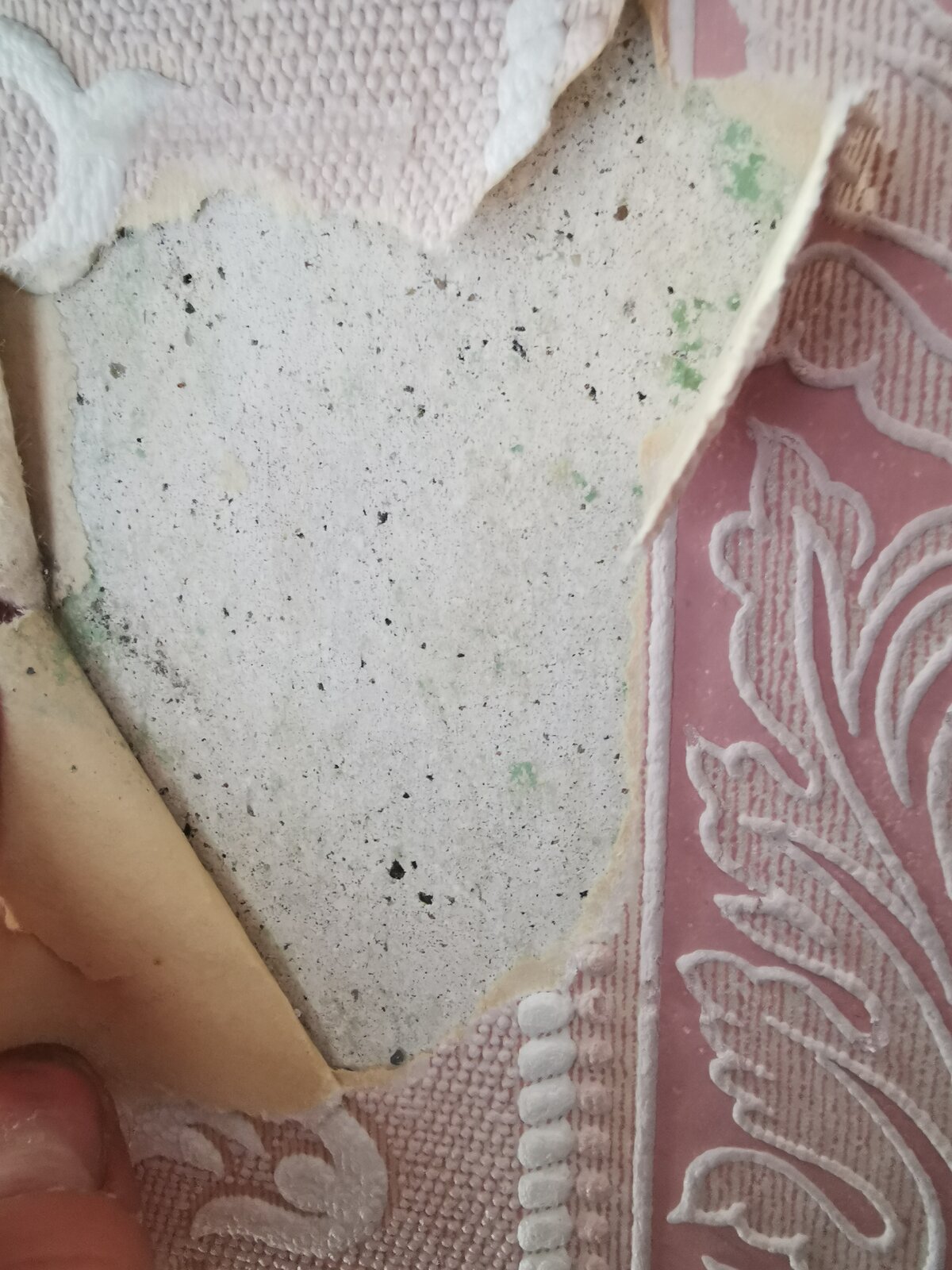

Hi all
I have just moved into a new property and the walls are in pretty good condition. The property is ex council stone built terraced I believe constructed in the 1920s
Is anybody able to tell me what type of plaster finish this is? It's a slightly off white with speckles. It has a smooth finish and seems harder than lime plaster when I scratch it?
Reason I ask is if it is indeed lime plaster I would then consider a breathable paint. If it is more modern, non breathable then I may just opt for normal emulsion
Thank you very much

Solid wall house vs cavity? Probably being 1920s so lime
Thank you it's just because it looks in very good condition but who knows. Maybe someone skimmed using the right product in later years which is extremely rare! Not sure if it's worth going for breathable paint as I've found other sections are gypsum
Look at image here and identify If you have a cavity.
If you have solid walls you can't use modern plaster
I'll guess that is lime mixed up on site. Local quarry sand

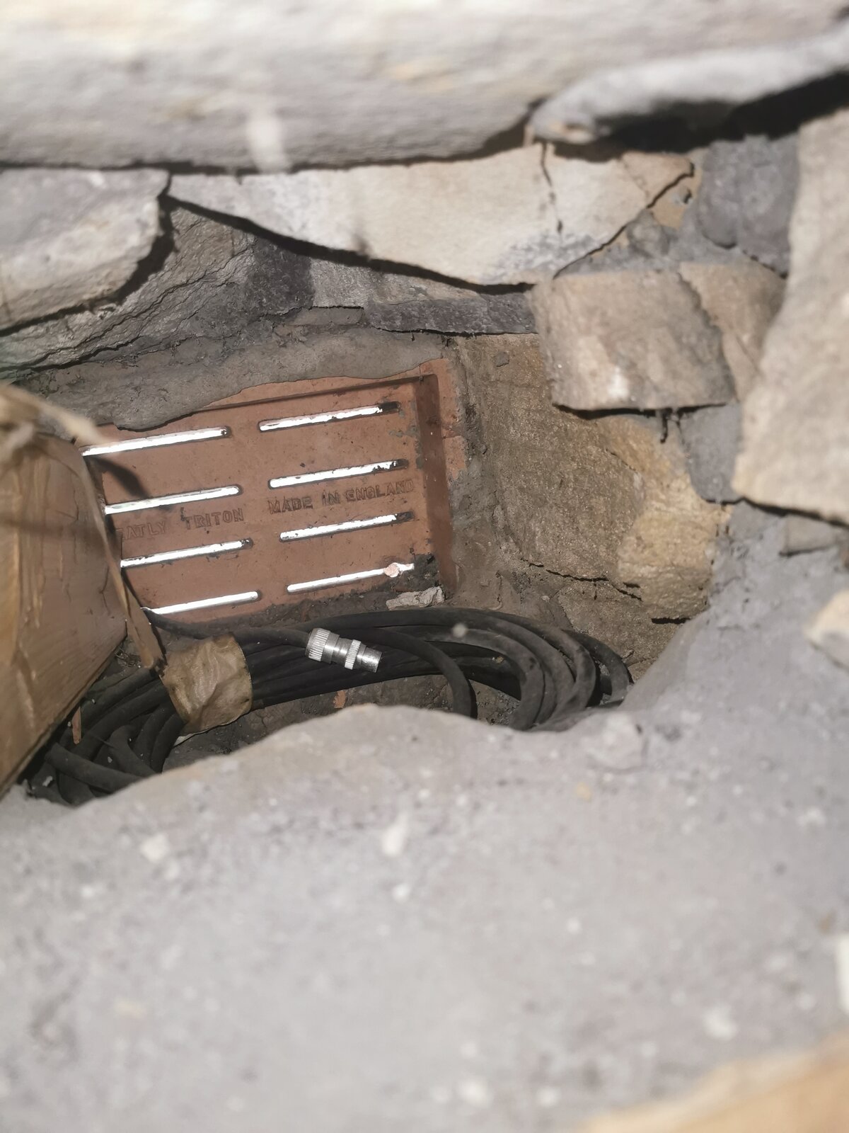

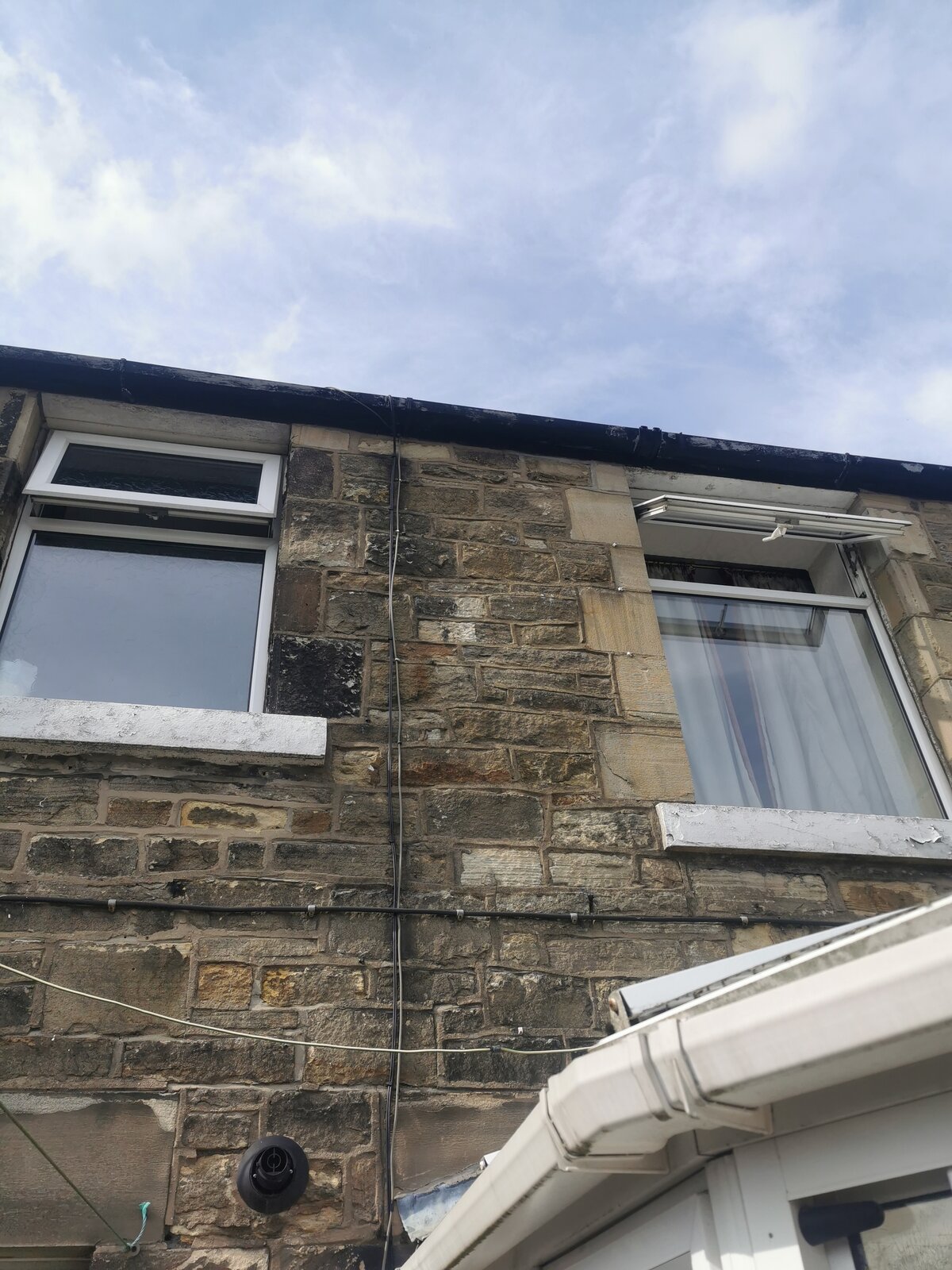

I think that it's solid wall. Here is a bic of the exterior and I have gone in through and airbrick and there wasn't a straight cavity that I could feel. Don't really want to be smashing off all the gypsum in places but will see. Seems dry on the walls

Think you need to treat it as lime.
Mixed up in 1920s using local quarry hence it looks like it does. Maybe
If there's no damp showing on your walls then leave the plaster/render alone.
FWIW: next time you point the stone exterior hack off all that strap pointing to a, say, 20mm to 25mm depth and re-point with a 4:1 sand & NH lime mix.

Top man thank you for responding. It's much appreciated. I think I might opt for the breathable paint also as I don't want to be sealing up the walls for the remainder of the plasters life
