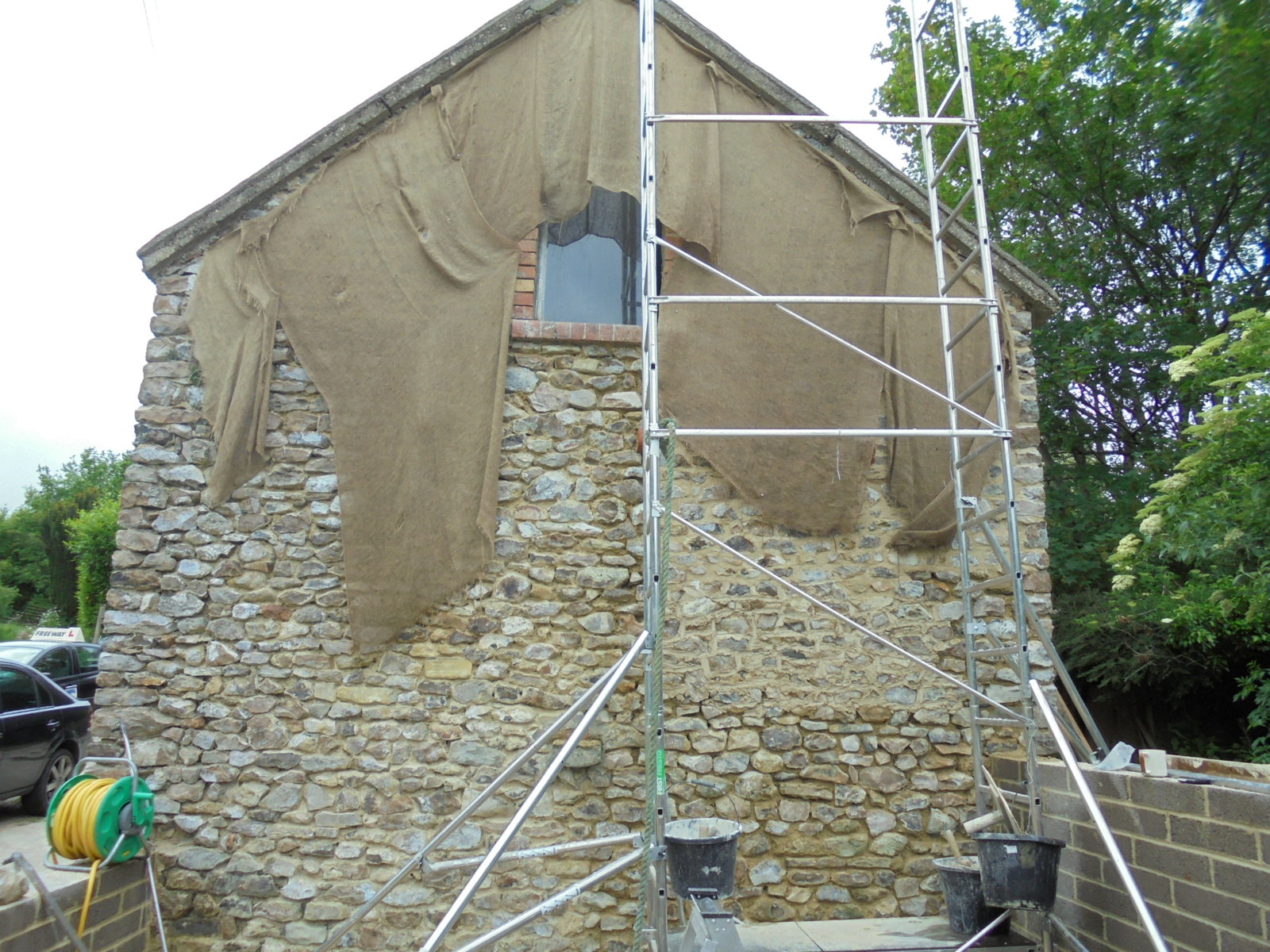

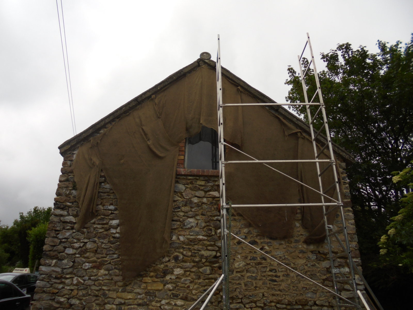

I'm repointing a barn with NHL3.5 at the moment, but you don't add cement to the mix. Just let it mix for 20 minutes and fatten up for 20.
Then cover like this and keep damp for a week.

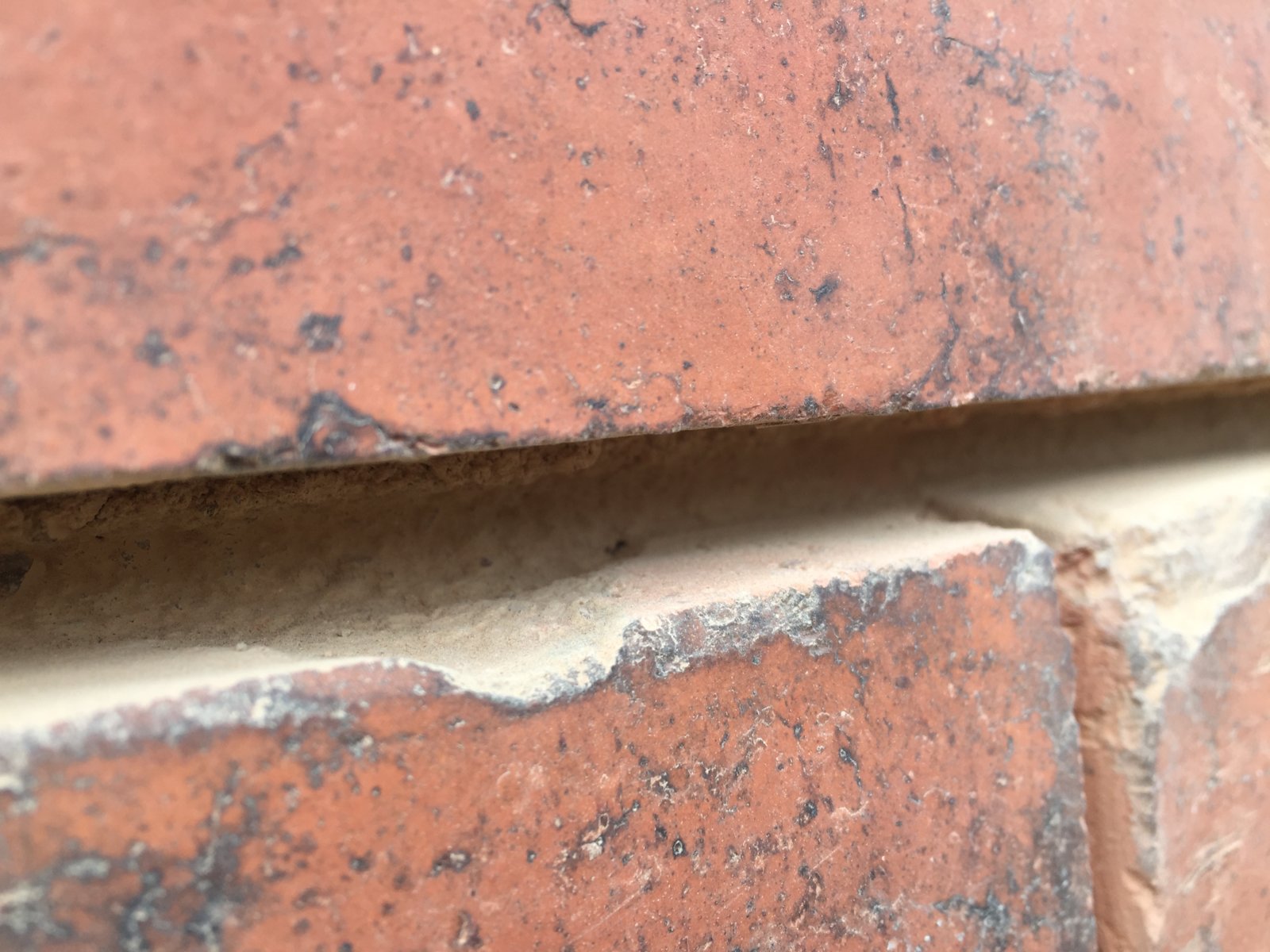

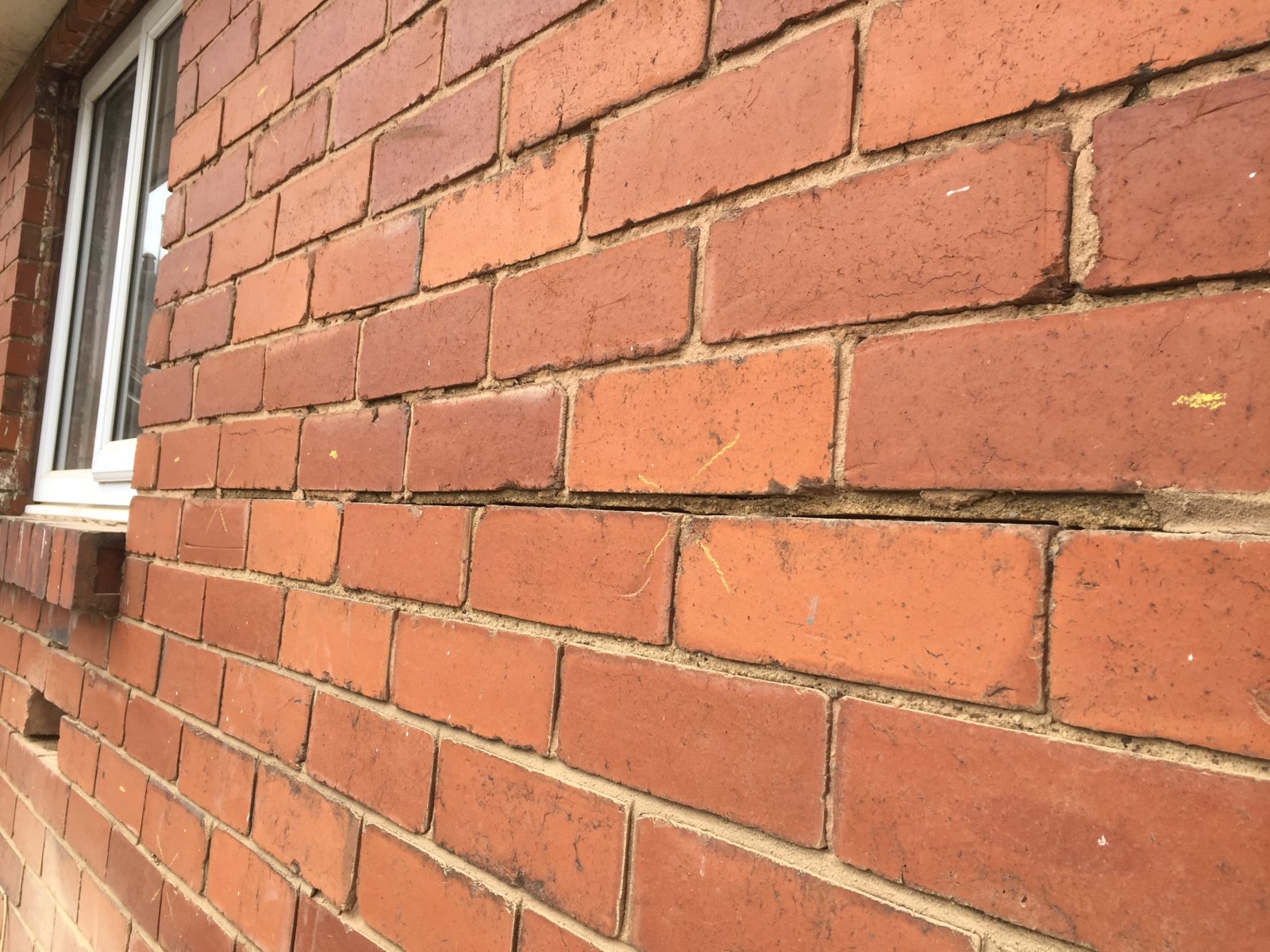

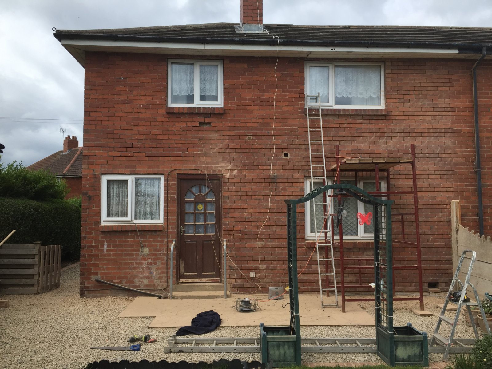

I have nearly ripped out the pointing on the back of the house today. Here are some pics. The rear is by far the worst as i think it gets the full sun all day and gets the rain as well.
The pointing is almost sand. I am going into it fully with my small grinder. So minimum i am in is 25mm, maybe 30mm in many bits.
2 bricks to the right of the top right bedroom window just pulled out after i had chased around that area. I have cleaned them out fully and just left in place for now. I also have some blown ties and they have pushed the bricks out a touch in one or two places. So i am going to fit some cavity ties in the odd place.
I am leaning to a 6:1:1 mix to include some lime to hopefully give me more flexibility.
