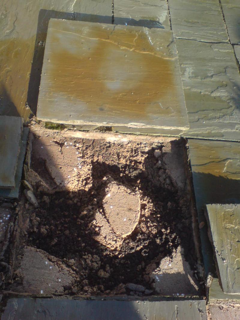

prices seem ok. What exactly does he mean by a wet/dry mix? The slabs should be laid on a full bed of wet mortar, and finished with a proper pointed joint, not just a dry mix brushed in.
Thermo is spot on..............have a look at my post today(with photo's) to see what happens 18months on if the slabs are laid on dabs
