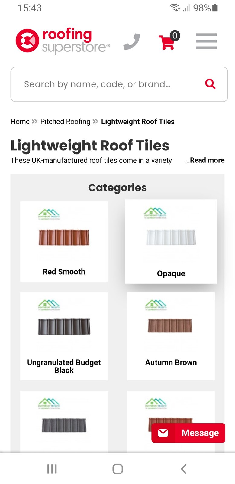

I have two lean to extensions and a conservatory. They are of a low pitch, around 15 degrees.
I would like to have them reroofed. Currently they are in cedar shingles, which I understand is a lightweight product.
According to the survey I had done:
  • The lean to extensions comprise "75mm x 50mm rafters at approximately 400mm centres"
  • The conservatory comprises "100mm x 25mm rafters at approximately 400mm centres"
One builder suggested Redland Cambrian, however I'm in a wooded area and I've read stories - for example, here https://www.diynot.com/diy/threads/low-pitch-cambrian-tiles-leaking.464038/ - of the channels becoming blocked with debris and them leaking.
Another suggested Marley Thrutone, but they don't look suitable for the pitch of the roofs.
Would my roof structures support a heavier product than cedar shingles? Does anyone have anything suitable in mind?
