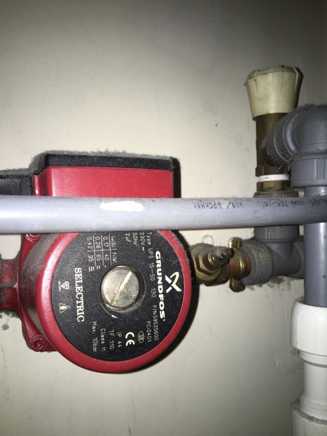

Hi Guys -
I have read other threads about the complexity of replacing the pump oneself but was wondering how hard it would be to replace mine specifically? I've attached a picture.
Basically, it makes a very loud grinding noise when its running. Not sure if the whole pump needs replacing or just the head. Any advice would be massively appreciated.
If it's too difficult to do for someone with limited plumbing skills, please advise which pump to buy so my plumber doesn't gouge me.
If you cant see the picture, the pump says: Type UPS 15-50 130 P/N: 59525600, 230V~, 50Hz, 2 uF (some weird little sign, not uF exactly), PC:0401, Selectric.

You should be able to just change the head

Is changing the head quite simple? How can I tell if I need to change the whole thing rather than just the head?

Provided:
1. There is another gate valve on the pipe immediately to the left of the pump
AND
2. Both gate valves actually work
Then you should be able to change the pump yourself.
Isolate electricity supply to pump and the junction box where it is connected.
Shut both gate valves, unscrew pump nuts, remove pump. Install new pump with supplied new washers. Don't use any lubricant / silicone on washers, particularly if they are rubber. New pump must pump in same direction as old pump (arrow on side of body shows direction). If it doesn't, as supplied, remove motor and impeller by undoing 4 Allen bolts, rotate body to get correct direction and replace bolts.
Remove connection box cover from old pump, disconnect wires. Connect wires to new pump. Done.
I'd personally use the equivalent Grundfos pump. Can't remember what its called but something like UPS 15-50/60. Somewhere in the region of £100 to £120
Possible snags:
a. One or both gate valves don't shut off. Give up and pay a professional to do it.
b. Pump nuts very stiff. Get assistance to hold pump body, and the body of the gate valve (each in turn). You'll need decent spanners / grips.
c. If there is any risk you'll cause a leak where either or both gate valve join the pipe-work, get a professional.

Thanks - gonna test the valves but if they're not great will call a pro.
