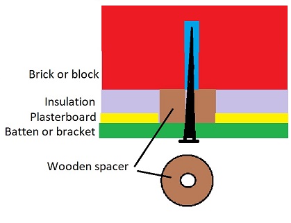

If the plasterboard is fixed by dot and dab to the brick then there could be a significant space between plaster and brick. Over tightening the screw may result in the plasterboard cracking. Fitting a spacer as below removes pressure from the plasterboard.
Green is the cabinet, and gray ( insulation ) is the significant space
The spacer does not have to be round.

I did recently purchase a box of Corefix dot'n'dab fixings. £20 for 24 fittings though. They have a metal sleeve that helps distribute the load in to the wall. The plug is sufficiently long enough to ensure that you do not distort the plasterboard as you tighten the screw. The downside is that the collar sits slightly proud of the plaster.

What plasterboard?
but you do need the plug to be pushed into the brickwork,
Whenever I have pushed a plug deep into the brickwork, the screw invariably pulls it out. There have been times when I have used two brown plugs to create a super long plug....
In all seriousness I don't think many people, including the people that design things intended to be fitted to walls take that in to account. Any gap between the fitting and the wall, by definition creates a cavity and runs the risk of pulling the fitting out of the wall as the screw is driven in, or as hinted by @Bernard, might lead to distortion.
