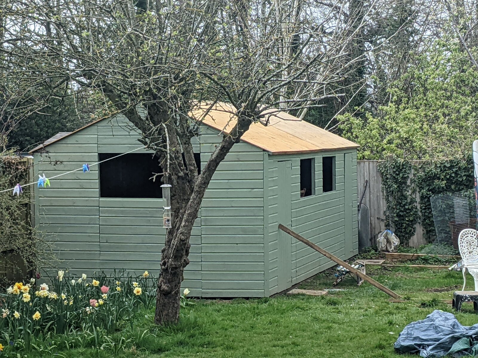

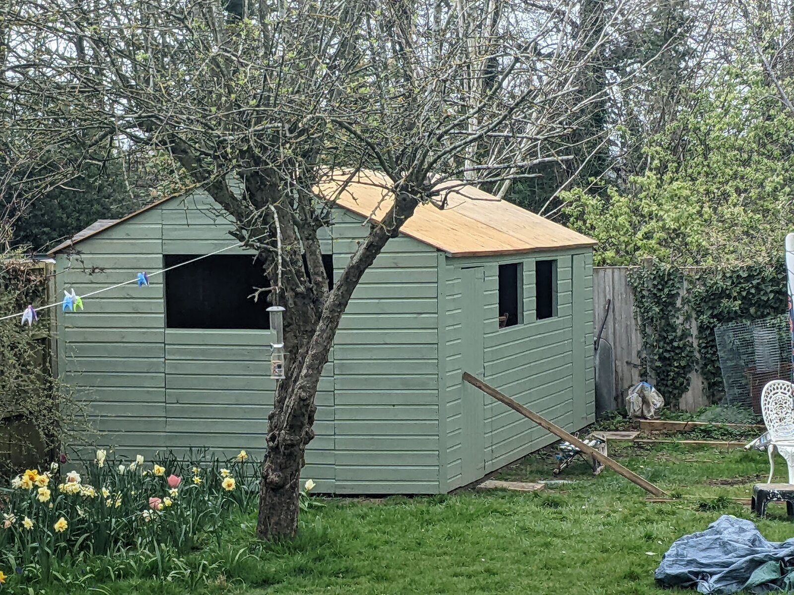

If you look on eBay, there is a company selling "seconds" EPDM offcuts. You would have to buy the adhesive but the trims/upstands can be replicated with cheaper timber or other materials. Easy to fit and 50 year lifespan.
Another recommendation for EPDM. My new shed roof is 10m x 3m and I used a single sheet of EPDM. It weighs 65kg, so was somewhat of a problem getting onto the roof but is vey easy to lay and completely impervious to water. I haven't used any adhesive - partly because my shed may have to be de-constructed (planning) and secondly because it doesn't really need it.
This is my second EPDM project. Back in 2003 I fitted a L-shaped EPDM foor over my (previous house) pouch/garage/extension that was perfect for 20 years and still going strong. That install was more comprhensive with underlay felt, flashing in with silicone and proper upstands. The latest one is just laid straight on the ply shed roof. I'm still um-ing and er-ing on the fixings as "proper" trim is very expensive - for the moment it is just held in place with a few screws
