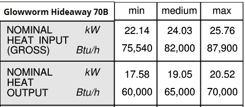

Without knowing much about your property, I would guess at no more than 21kw. I base this solely on your old boiler having a 20.5kw rating.
If the boiler you have provides adequate heating then choose one with a similar output power to the boiler you have. Input and output powers are different
