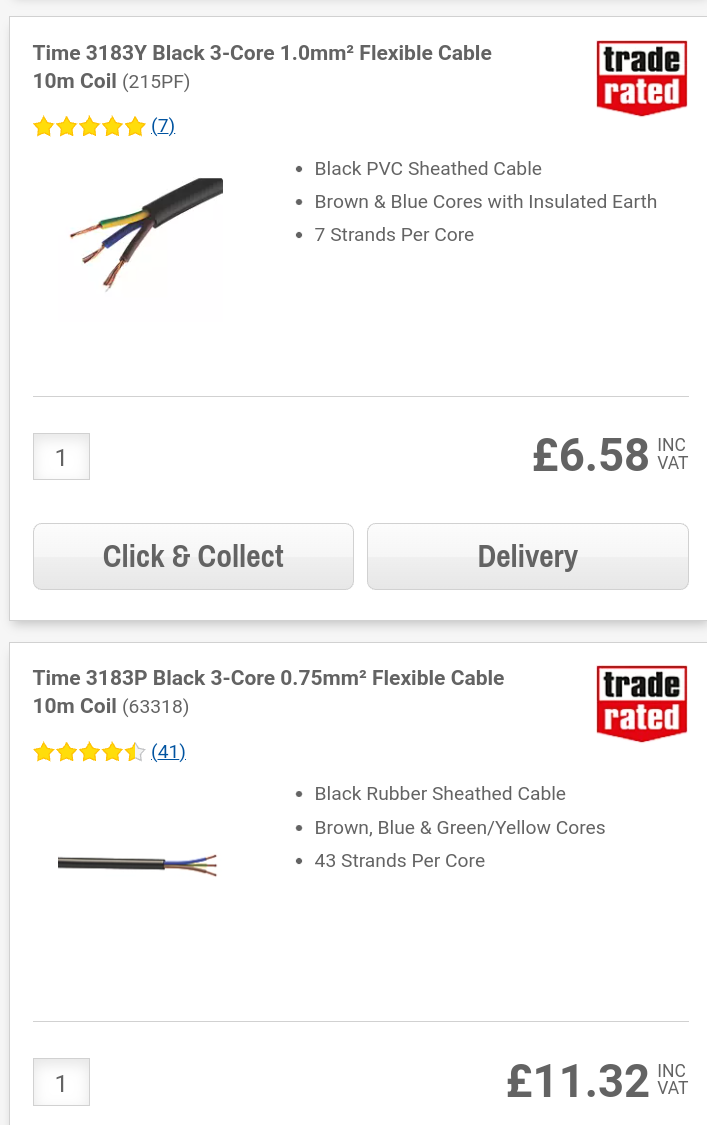

I plan to wire a flood light direct to a plug (with 5amp fuse).
Part of the cable may be exposed to the sun
Would 2 core + earth 0.75 black flex cable be sufficient for this job or would I need something else?
@RandomGrinch oddly Screwfix sell the 1mm cable cheaper than the 0.75mm cable
I am assuming this is due to number of strands per core? 7 vs 43
Anyway, is it okay to use the 1mm cable which has 7 strands per core?
