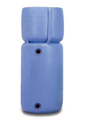

You could get a combination ('fortic') cylinder to save having a header tank.
I am still concerned that one 3kw immersion heater will be insufficient to produce the amount of heat needed.
you might have a better idea there with that mogget - maybe a heatrae FBM cistern type?
on the fbm type - do these vent back to the cistern? no need for G3 installer??
I meant something like this

Immersion heater will have a very long recovery time for this application where water use could be quite intensive.
