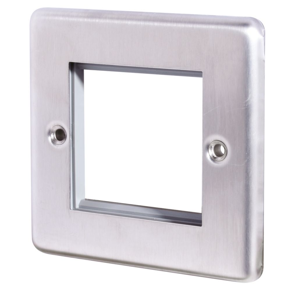

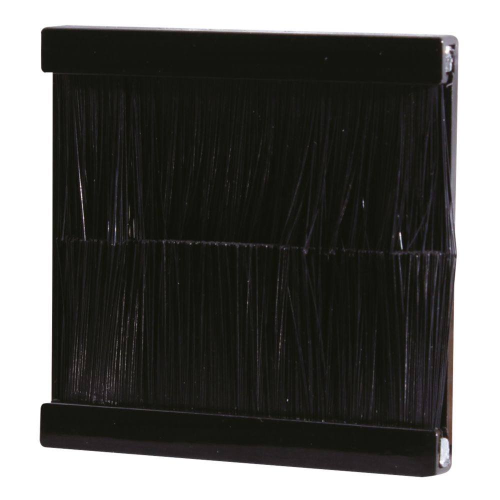

I think although having no break in cable is electrical best, having a pair of cables just coming out of the wall looks cheap and nasty. LAP do a grid system of switches, sockets, and brushes which can be used to make it look neater. These
ae235
brushes fit into these
ae235
see here and here allowing the inside at least to look neat. There are also standard TV and F type connectors which fit the same system, you can mix and match.

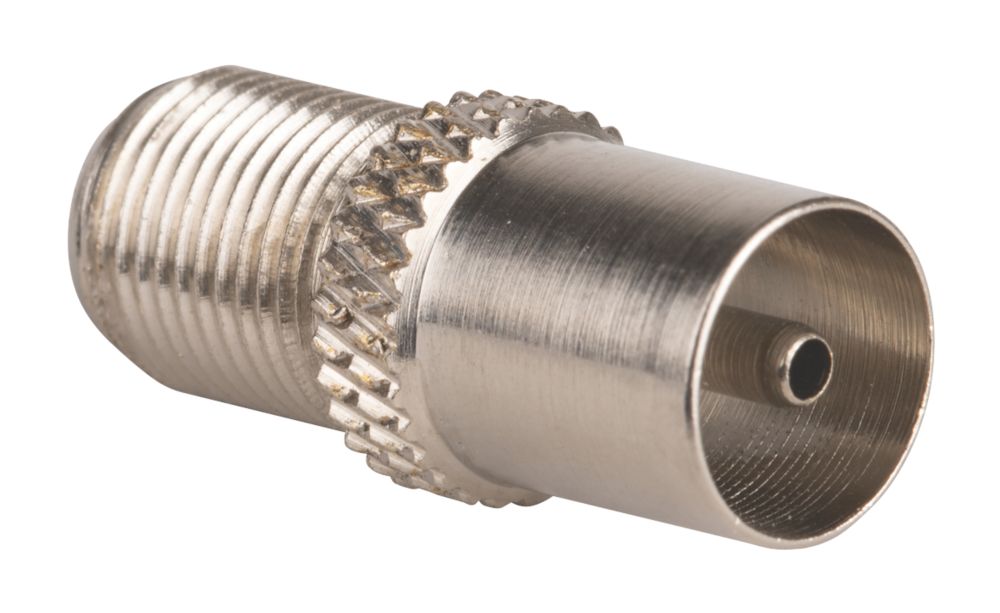

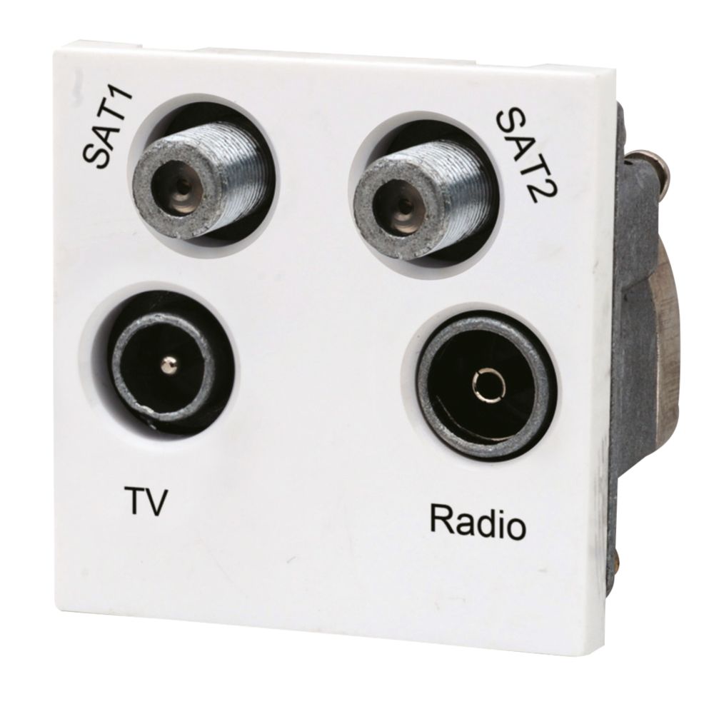

I use TV and F type simply to identify which system, satellite or freeview, it does seem the standard TV connector has two thicknesses of centre pin, using these
ae235
I have found some of these
ae235
have too thick a centre pin, not a clue where they came from in first place, but there are the easy way to adapt leads for F type or TV.
