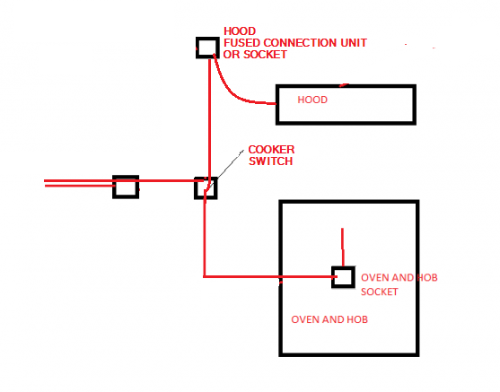

Hi there, thanks for your time.
So Ive had the first fix electrics installed in my kitchen the electrician is coming out to fit the second fix sometime next week on a labour basis only I'm supplying or rather buying the sockets etc ready for him to wire up and sign off.
Ive attached a rather rubbish paint diagram of the sockets I'm unsure about.
So the cooker is going to be hard wired to a socket directly behind the cooker. From there it will run to an isolation switch above the work tops. From there is runs directly to the consumer unit.
The hood is going to be run via a 3 pin plug to the socket above again with an isolator above the worktop. The hood wiring is apart of the sockets wiring ring.
My thinking is behind the cooker I will require,
MK 45A Cooker Connection - http://www.screwfix.com/p/mk-45a-cooker-connection-unit-white/16686#_=p
The hood socket Im presuming will just require a standard 13a single socket as its via a 3 pin plug - http://www.screwfix.com/p/mk-13a-1-gang-dp-switched-plug-socket-white/14790
Im struggling now as to what isolation switches I need. I cant seem to find any 45a single socket isolations switches made by MK.
For the hood isolator is this okay -
http://www.screwfix.com/p/mk-13a-dp-switched-fused-connection-unit-with-flex-outlet-white/13479
The socket will be 13a and the isolator 13a so presume this will suffice?
Any advice appreciated folks. Im hoping to pick all the bits up tomorrow. The sparky isnt on the end of the phone on weekends otherwise Id have asked him.
Cheers!
They do not make one. If you want MK, then this: http://www.diy.com/departments/mk-logic-plus-32a-white-single-switch-with-neon/189595_BQ.prd
is the only one in a single plate size.
It's not clear what cooking appliance(s) you have - the diagram states oven & hob, the description states cooker.
If it's a cooker, the single outlet plate can be used. If you have a separate oven & hob, a dual outlet will be required. MK do not make them either.
The hood connection can be a single socket, an unswitched type would be preferable if there is another isolation switch elsewhere.
The 13A FCU can be used, although a 20A switch would do just as well as you already have a fuse in the plug for the hood.
Or use the FCU (with 3A fuse) and a flex outlet plate for the hood.
Nope, can't find MK one - buy another make for all accessories.
https://www.toolstation.com/shop/p12273?searchstr=cooker switche
http://www.screwfix.com/p/lap-1-gang-45a-dp-cooker-switch-with-neon-white/49779
Yes
You will fit a 3A fuse. You don't need both.

Hi guys,
Thanks for your replies sorry if its confusing. To explain more, as I said the extension is being done legit through building control however Im trying to do the first and second fix on a show string so I fixed all the back boxes, had an electrician fit the cables etc ensuring they were all ran in the right zones and he said once the plastering is done buy all the sockets and he'll come to wire them and sign the lot off. Thus why I'm sounding all a little vague here.
Flameport, thanks for your input. Looks like MK is out the window, I only intended to use them as the rest of the house double and single sockets are MK however for the isolation switches it doesnt really matter. To confirm the cooker is an all in one type so only has one cable.
EFL, again sorry for the vagueness. The cooker will be hard wired and now going from both of your advices its going to be hard wired to a 45a switchless plate behind the cooker, from there it will run to the 45a cooker isolation switch you posted.
The hood will run to a 13a 3 pin plug, I would use a switchless one however the hood already has a plug attached. From there to the 20a switch flameport recommended.
EFL your recommendation to run the hood to the same isolation as the cooker is a great thought however now its all been plastered etc I dont want to have to chop into it to move the cables as like I said the cooker is wired directly... from the consumer unit with no other cables involved on its own switch on the CU. So having the 2 isolation switches next to each other will do.
