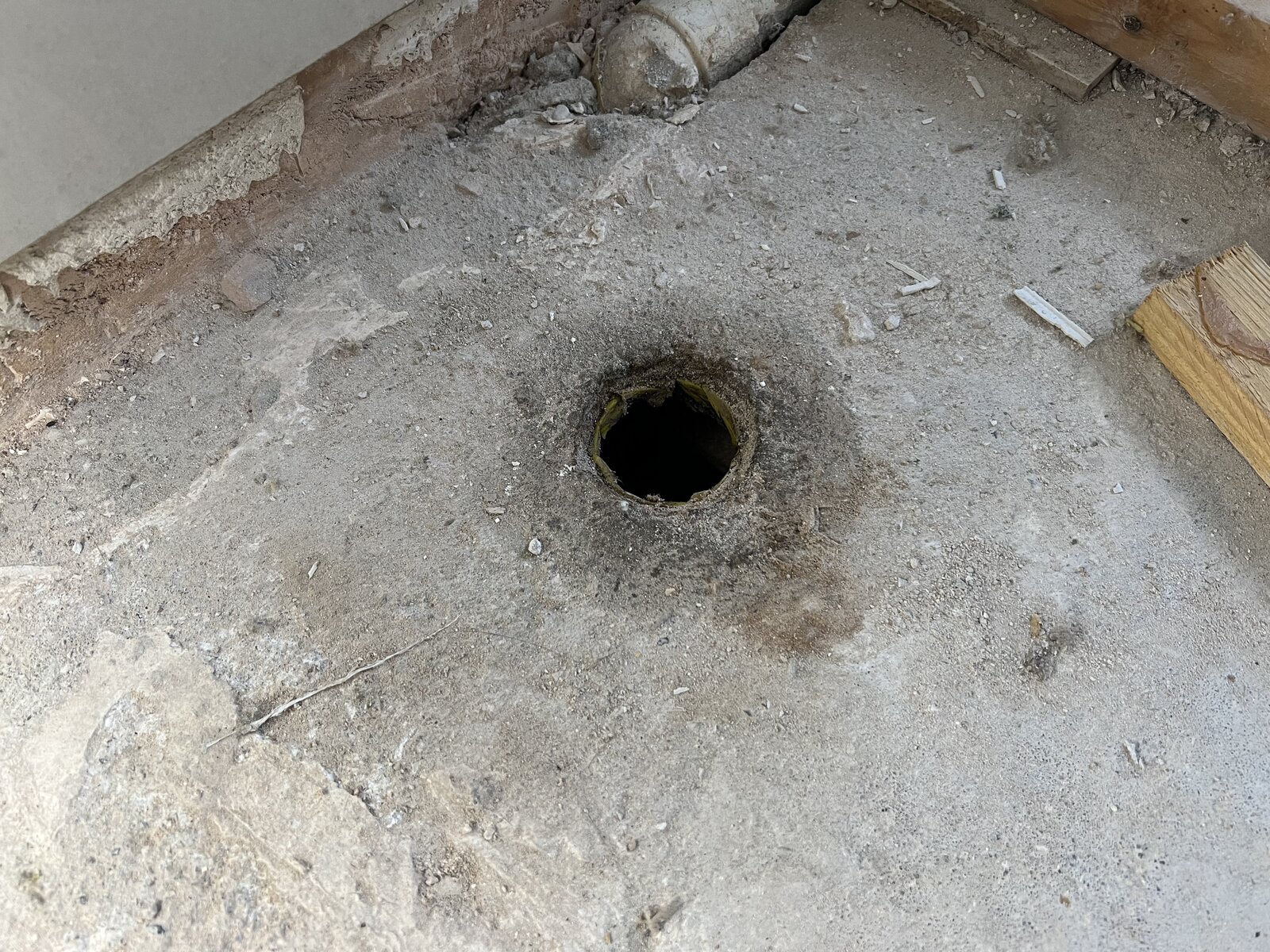

Hello again,
On changing the bathroom suite, I have found the bath drains in to this hole, with the sink draining into a similar hole beside it that leads to the same drain.
The bath waste pipe came out with ease, which leads me to worry that the bathroom floor could flood in the event the drain backs up.
Has anyone any advice on what sort of fitting would better suit, or whether it all needs to come out and get replaced (and if so, with what).
Any advice welcome.
Cheers,
Adam

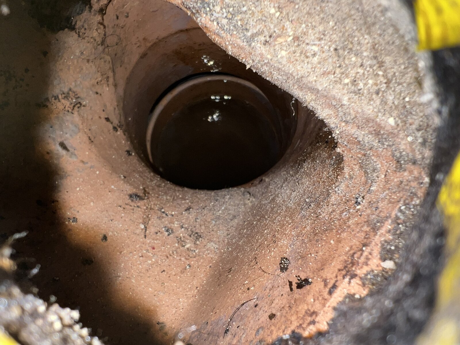

What sort of Drain? A bodge sort, thats what. Looks like an open Hopper with pipes going in the top thats just been buried. Needs digging out and the correct arrangement putting in, either fit a sealed screwed down lid onto the hopper, with pipes connected via bosses, replace with a bottle gully and again, sealed lid and connections via bosses, or direct connections to the drain with the appropriate adapter.
Is it just wastes going into it, I cant tell if thats a rainwater downpipe at the back of the bottom pic.
Thanks (again) @Hugh Jaleak.
It should just be bathroom waste - but as per the missing manhole cover, who knows with this extension!
The rainwater drains some 4 odd metres away, but could well link-up..

When you've removed the recessed internal cover, & after clearing it out please pic down the manhole to show inlets and outlets.

Thanks @tell80 for the pointers - I ended up having a local plumber out with a CCTV camera, as per my other thread, the sink drain had become blocked.
That was full of fat and detergent, and luckily his rod pushed it through, with the camera showing it running free after.
He looked at this drain and concluded it’s an external pot that shouldn’t be there, as per the thoughts with others on this thread.
So to get myself out of trouble we’re going to refit the bath temporarily until we can get a builder in to dig the sub-floor and do the whole bathroom. I’m guessing I’ve been lucky for the last 11 years that it hasn’t backed up and flooded the bathroom!
