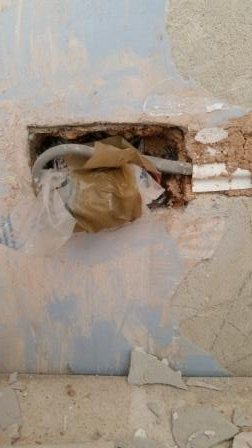

On inspection I found that all sockets in the kitchen were spurs (new colour cable) which I found a little strange and wasn't able to work out the cable routes (skimmed and painted walls).
I also discovered that whilst there was a circuit breaker labelled up "kitchen" only two sockets were on this breaker with other sockets being either on the upstairs or downstairs circuits - how confusing was that?

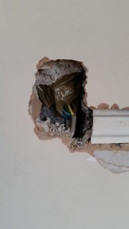

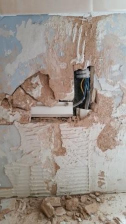

It was only when I started refurbishing the kitchen (removing the kitchen units etc.) which exposed unpainted walls that I realised that what they had done was simply to connect into the old socket locations insulating the joints with any old rubbish they could find before burying in plaster as the photos below show.

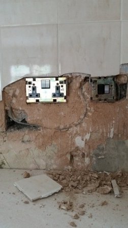

My favourite is the second one where they wanted to connect the spur to the socket. As you can see, rather than link the two in the shortest most direct way with a piece of cable 4" long they have embedded in the wall a piece of cable 10 times as long taking a nice curved route.

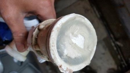

The last photo shows that they were masters of more than one trade as they needed to cap off part of the kitchen waste and rather than use a proper fitting they simply shoved a piece of polystyrene in the end of a joint and siliconed it - brilliant!
I am pleased to say that I now have all sockets on one completely re-wired circuit and absolutely no polystyrene in my waste system!
