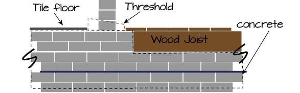

Many, many years ago when I was young and (more) clueless,we removed a flat-roof toilet/shower attached my pitched-roof kitchen extension (probably built in the 50s or thereabouts - the flat roofed bit appeared to be a coal store and maybe a pantry or something originally).
We left the existing exposed slab foundation and decked over the top of it. I'm now planning to get the whole extension refurbished properly and have realised that leaving the slab exposed was a very poor idea as it's one big slab under both the external bit and the pitched roof part and I've had the concept of "wicking" explained to me.
It's actually not caused any problems as far as I can tell - there's no damp or anything, but I do want to make it right. What's the best thing to do? I've had the following ideas:
1. Demolish the external bit of foundation - but won't that compromise the integrity of the entire slab?
2. Dig a channel between the external part of the slab and the brick walls and install a linear drain - it would have to be about three bricks deep to get below the slate DPC
Any advice? One builder suggested option 1, the others never mentioned it as a problem at all.
