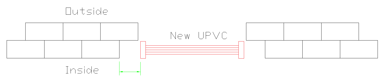

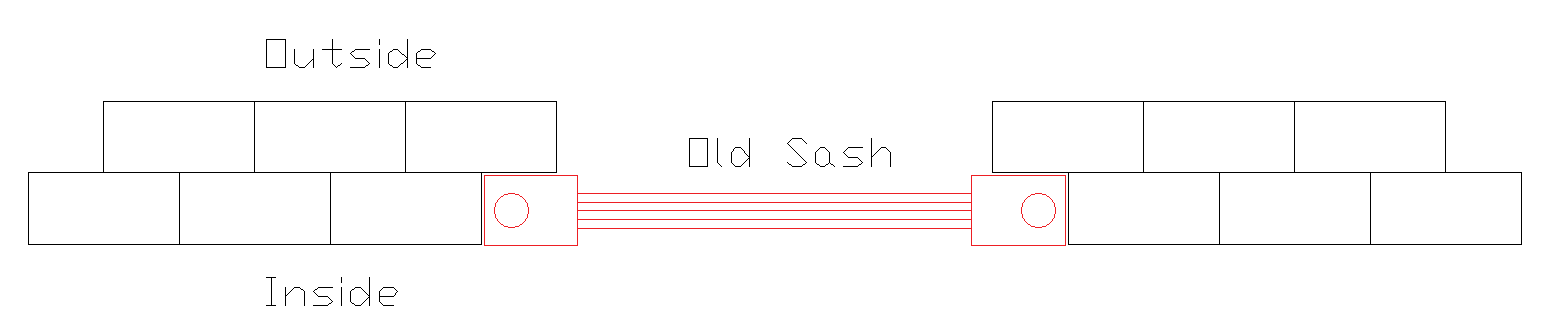

There is an excessively large section in the old sash windows where the weights were located:
When I remove the sash and come to put in the new UPVC windows, I'll have a large gap to fill in:
I do want to keep the location of the windows from the outside rather than fit the new window further towards the outside.
What is the normal procedure for filling the gap shown in green? I was contemplating bricking it in but I'd have to wait for the brickwork to set before installing the new one and that means having a window out overnight (not a good idea around here) and it does seem overkill especially if there is a simpler way...I cannot imagine I'm the first to do this so wondering how window installers deal with this.
I used to run 2 lengths of treated 4x2 screwed together down each side top to bottom, single one across the top, the side bricks will be somewhat jagged so timber will need plumbing up before screwing, position it so that with plasterboard it just catches the edge of the window, fit a new window board, foam any gaps and then plaster board
