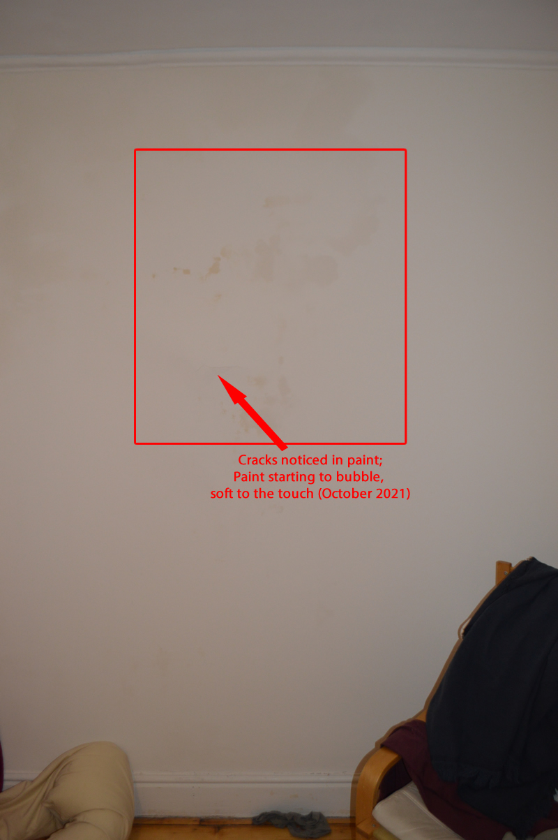

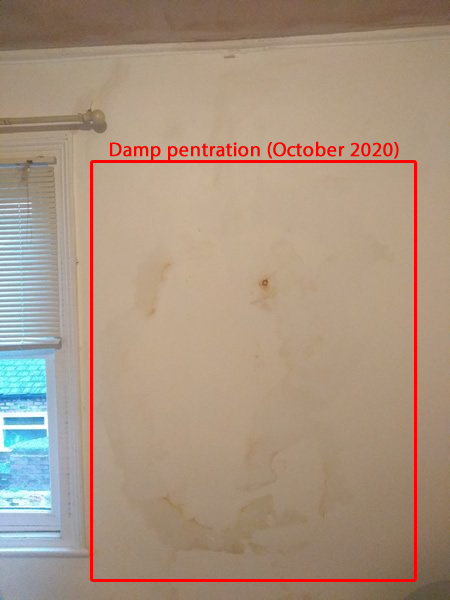

  • Photo #1 "BedroomDamp". The back bedroom wall was showing obvious penetrating damp. This was ongoing for about 1 year (roughly since Oct 2019)

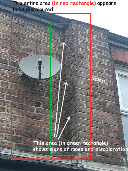

  • Photo #2 "Outside_wall". We discovered the damp was penetrating from the outside wall due to a leaking roof and primarily a leaking gutter; both were repaired in March of this year, 2021.

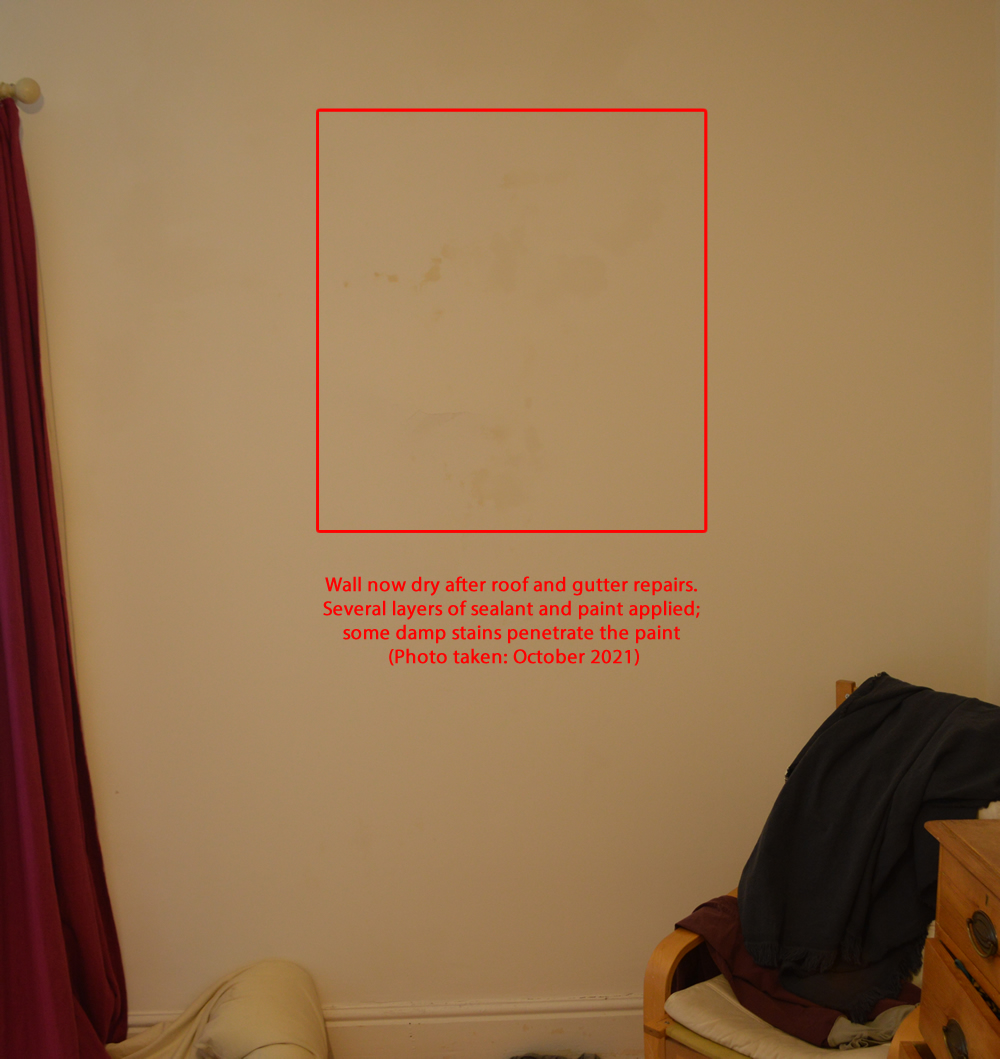

  • Photo #3 "Oct 2021 Damp stains". After these repairs (March 2021), we let the wall dry out for a few months. The wall was clearly drying successfully. I then applied several layers of paint (in May/June 2021), however, covering the damp stains was difficult. I applied both water and oil based Zinsser primer, however, I could not seal all the stains.
  • Photo #4 "Oct 2021 Paint cracks". Just this past week (11/10/2021) I noticed a crack in the paint.

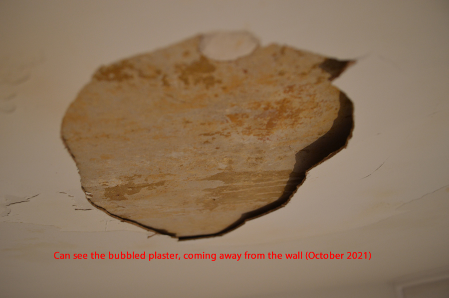

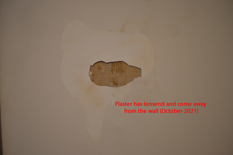

  • Photo #5+6 "Oct 2021 Loosened plaster"/"Oct 2021 Bubbled plaster". The paint appeared to have bubbled, or more so the case that the plaster has loosened from the wall and was soft to the touch.

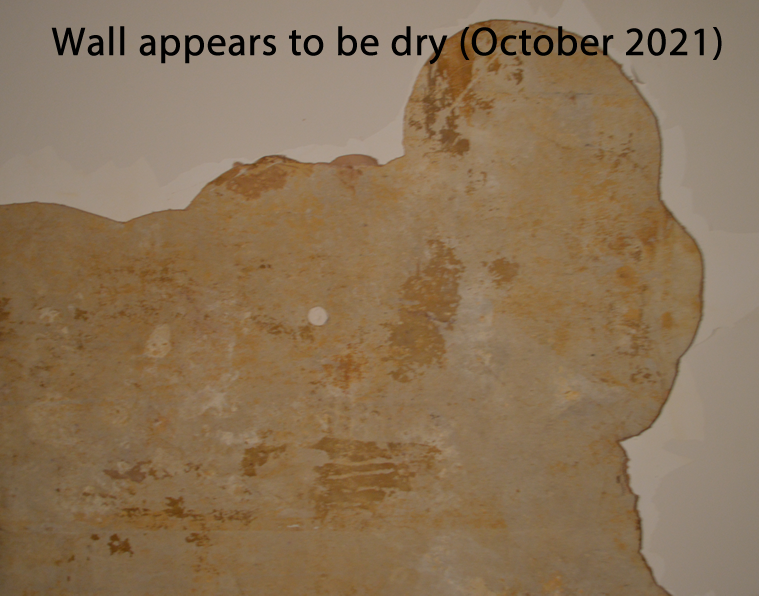

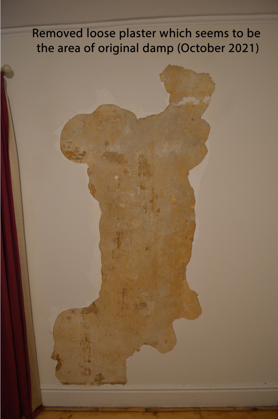

  • Photo #7 "Oct 2021 Plaster removed". I stripped back the loose plaster which eventually/evidentaly aligned to the original area of damp. The plaster in the top section remains loose and still needs to be removed. (It resembles a map of Italy!)

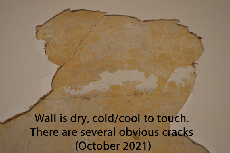

  • Photo #8 "Oct 2021 Wall cracks". The wall appears to be dry, however, there are several cracks while the wall is also cold to touch. There is also a musty damp smell.
  • Photo #9 "Oct 2021 Wall dry". Since the wall appears to be dry, I reckon there is no further damp penetration, however, several questions remain: What is causing the plaster to bubble? Does the wall require time to dry out properly? Or should I simply replace the wall as the damage has been done.

macoadh, good evening.
Looks as if the main wall is oF solid construction, no cavity.
Is that an old unused chimney ?
Suggest you try to have a good look at the cap on the top of the [chimney?] and is there a vent at the vase of the [Chimney?]
There appears to be an air brick vent that [in the images] comes over as if blocked off with a white material? if so that could suggest that someone has historically had issues in the same area as now? Is that air brick sealed up?

  • That chimney needs to have a vent somewhere near to the bottom and another near the top to allow it to dry and stay dry.

That must have been a chimney at some stage in it's history - my guess would be that your utility was once maybe a wash-house and that the chimney served a coal heated copper boiler for washing clothes in. That would make the house pre-1900 -ish.
I have zero faith in damp surveys, they will always find some and offer an expensive solution which hides the issue rather than fixes it - better to fix it properly. I would suggest the chimney needs to be able to breath, to dry out naturally. That needs a place for air to enter, rise and get back out taking moisture out with it. Usually that means a vent where the fireplace was at the bottom and a cowl to allow air out of the top. As you already have an air brick near the top, that just needs un-sealing and a second one added near the bottom of the stack - but please wait for other comments on this, because I am not a builder.
Also keep in mind that it can take months of good weather, for such brickwork to be finally completely dry.

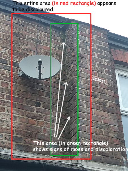

macoadh you have a external chimney breast that use to have a stack, the stack has been dropped to below the OG gutter and some kind of cover put over the remaining chimney breast. Do the gutter and fascia run continuous over and above the chimney breast cover?Pics showing that area would help. why did you have work done up there?Whatever was done is allowing water to drip down, your moss and green rectangle.
With the semi-blocked air brick you have no through ventilation in the flue.you need one high air brick that needs replacing and one low ventwhere the redundant fireplace used to be. PIcs of the ground floor chimney breast would help.
The soot is bleeding through the chimney breast bricks - seeall those dark bricks and affecting the wall on either side. Its also bleeding chemicals into your beedroom wall. thats probably the damage you show in the above pics.see. you have a solid wall so maybe its getting soaked?.
Yes, I believe so. I will add this to my todo list and take photos asap. It is very difficult to get up there for a bird's eye view, as the outhouse cuts out the simple use of a ladder. The roofers we employed had to climb over the roof from the front of the house - not something I can say I am confident/brave enough to do.
Contrary to the damp survey, I believed there was water somehow flowing from on high and soaking the sides of the chimney (as I have suggested in the photo above). We had roofers check this for us, and yes, there was water getting through the joint in the gutters. The roofers also found several broken slates just above the cap of the breast - they were concerned that the roof wood work could be seen through these cracks. The roofers repaired all these breakages and/or replaced the broken slates. I used to be able to see daylight in the loft but this has disappeared now; so, I believe everything is well sealed now (or so, I hope).

Best practice in the bedroom is knock off all plaster floor to ceiling/cove back to brick and render it with a sand and lime render.
theres dark shadows or stains showing on the ceiling in pic 1.
