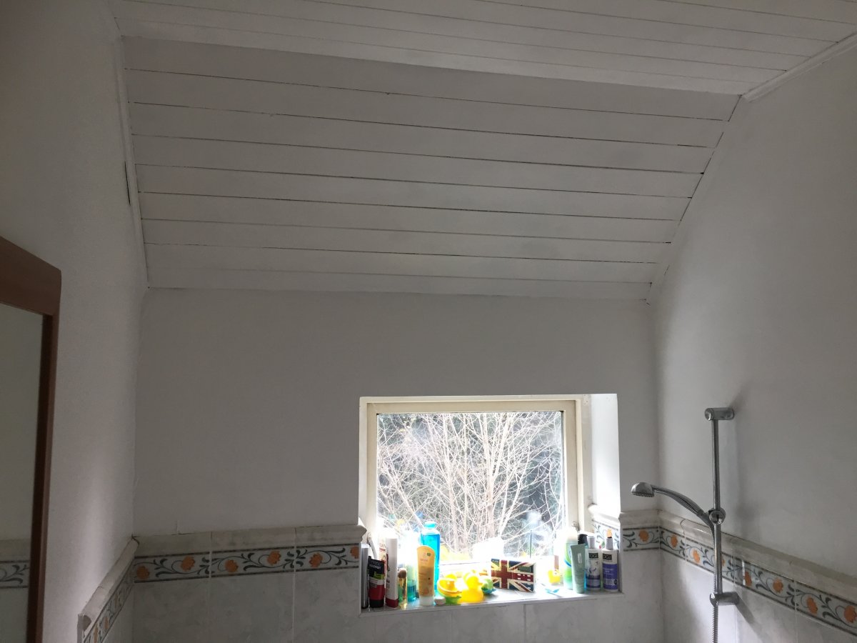

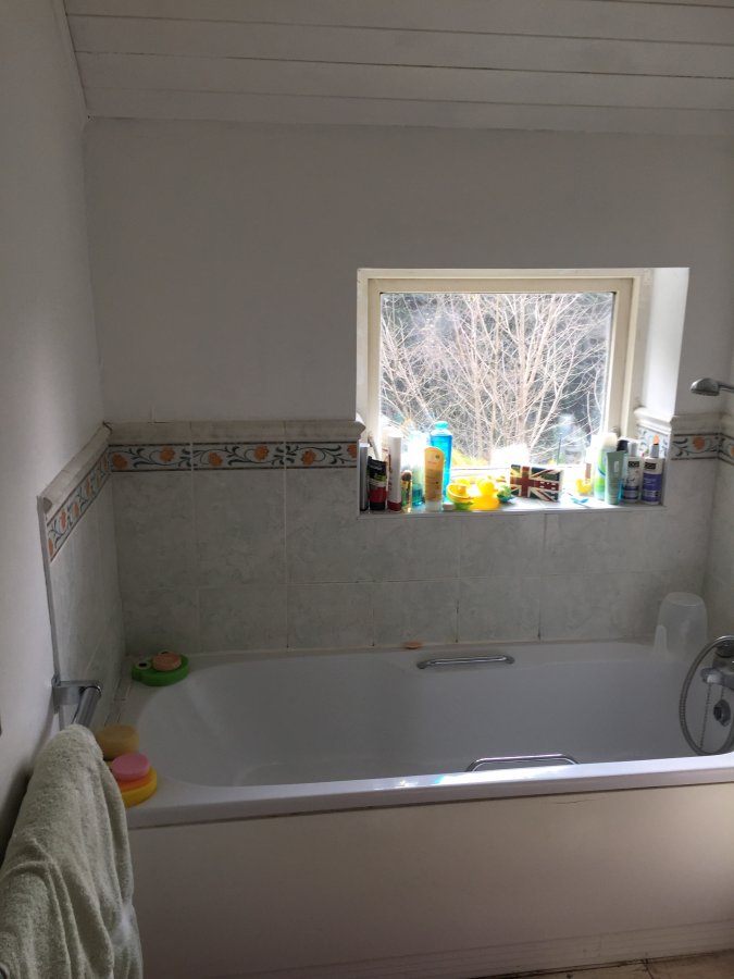

Has anyone got any opinions what would be best for the sloped ceiling area in this picture? There will be a shower going on the left hand side with a p-shaped bath. Tiles on the verticals and sill etc, but unsure of what to use for the slope? Possibly tiles? Or shower panel?

If the shower head is going to be below the height of the lowest part of the ceiling, Id just paint it with a water resitant paint- as seems a shame to loose the tongue and groove detail. If the ceiling is going to get wet I supsect you need to use a shower panel, as tiles would be a pig to put up (unless you tiled a board and them mounted that, but would be heavy)
