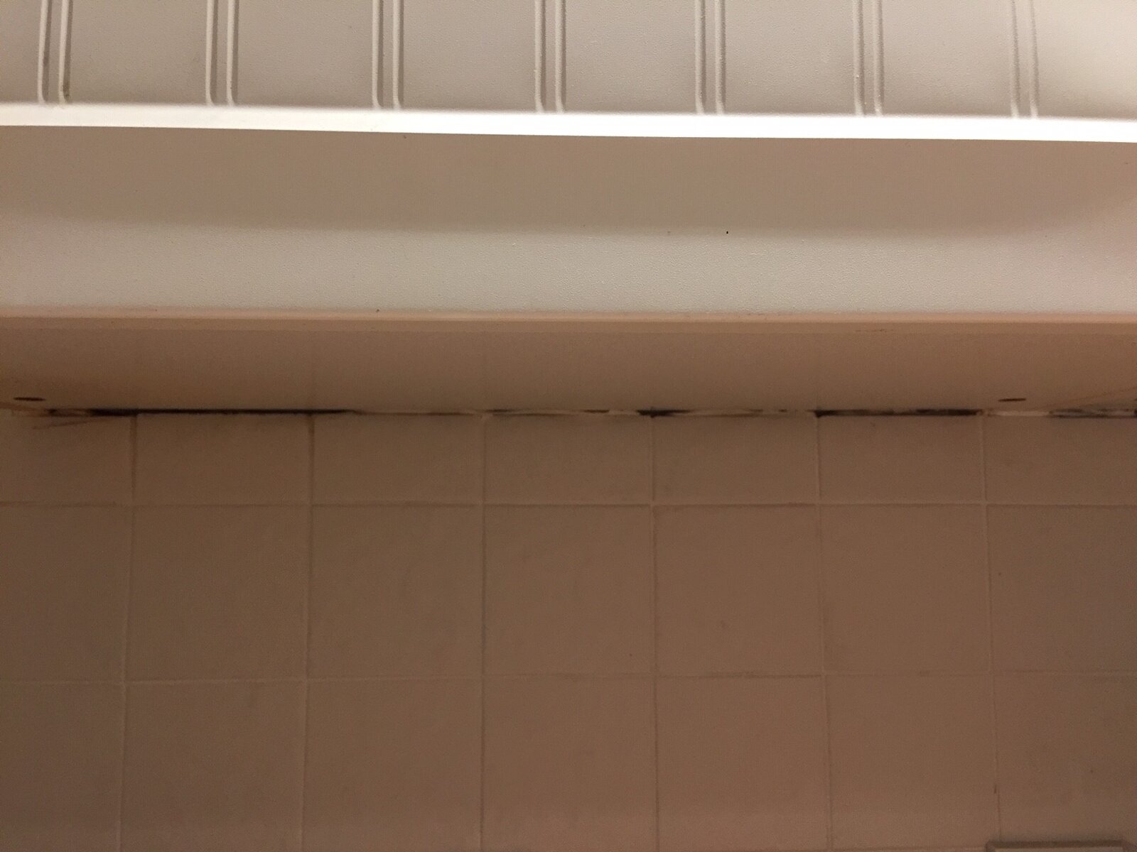

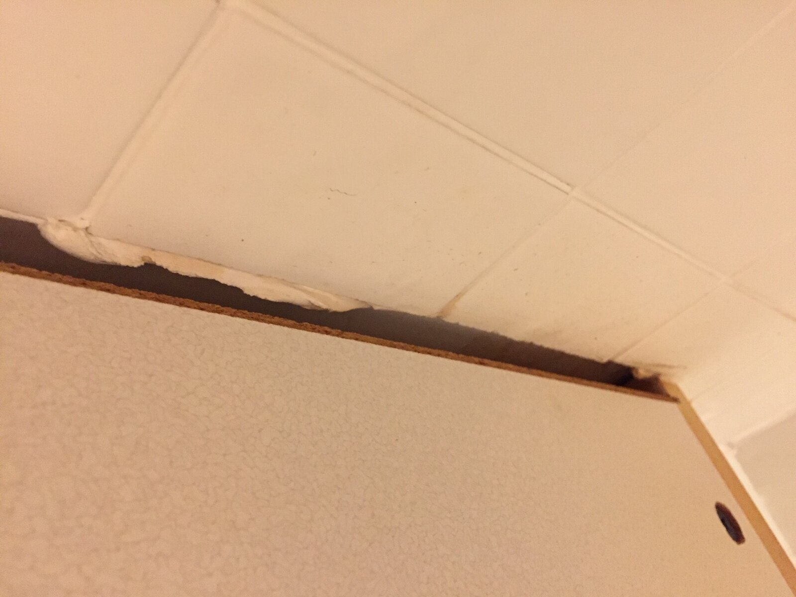

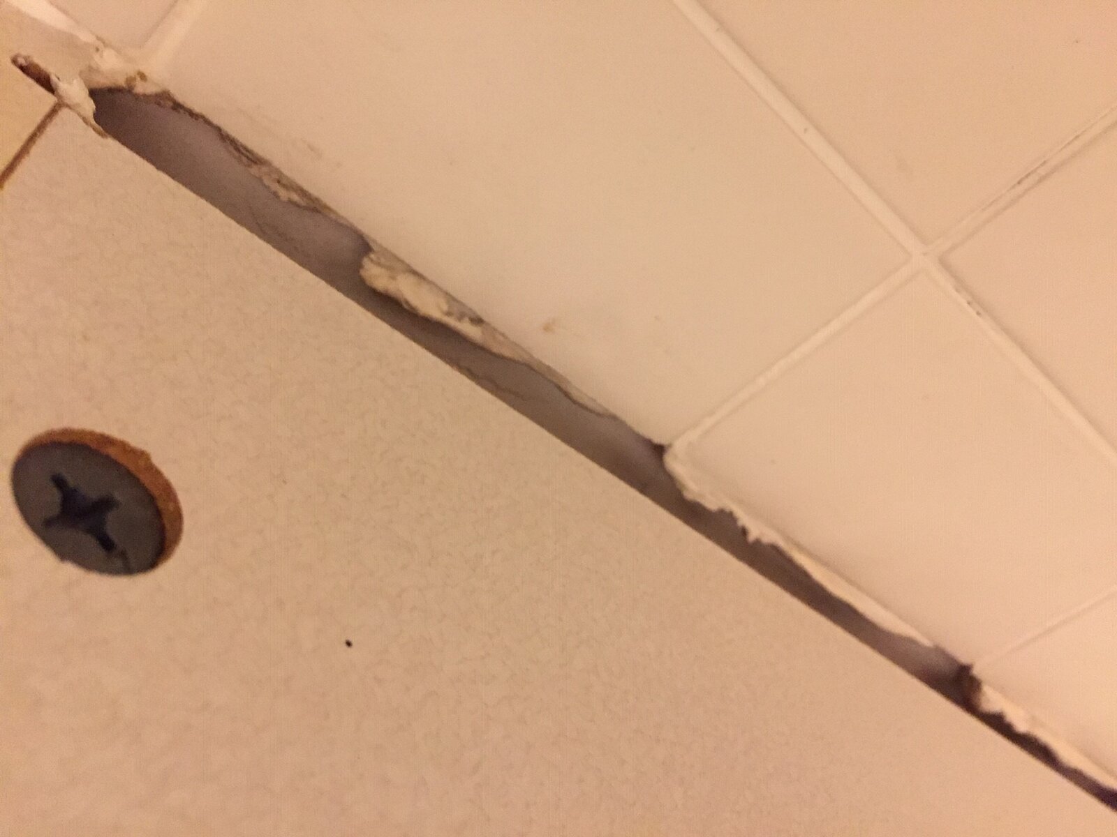

Hi all, we are repainting the old kitchen in the house we moved into a year ago, and I'm wondering if there is anything we can do about the big gap between the kitchen cabinets and the tiled wall? It's quite a big gap so not sure if caulk can be of any use, though seems like the previous owner did try that? Thanks!

Eventually figured out that the Gap is from the Bottom of the Wall Cabinets to the Wall Tiles. :)
Can you see it from where you would normally stand? I can't in my Kitchen.
If not, you could leave it.
Might be able to fill it with Silicone
Or silicone/glue something like this in to cover the Gap
https://www.wickes.co.uk/Wickes-PVCu-White-Quadrant-17-5-x-2500mm/p/162617

Thanks a lot! My 6ft partner never complained about it, but me being 5ft tall told him that I look at it all the time! :unsure::unsure:
I am about 6ft and we have trims/lights under the Cabinets.
It would annoy me if I could see it !
Should be able to tidy up easily/cheaply enough.
For the joint between wall and cupboards I 'd recommend Plastic beading or Scotia both of which are easily available. Once that's in place you could add a 'Pelmet' to the underside of the cupboards, say about inch&1/2 (35mm) deep and have strip lights behind it for more light in the kitchen working area.
Or you can use a piece of matching cornice, if you can find it.

Much cheaper from Eurocell,com - I don't have a gap, because I trimmed the worktop to be a very tight fit to the wall, but I don't like silicon to tidy it up. Instead I used the quadrant from Eurocell, stuck in place with sealant, then the surplus cleaned off. In addition, I used it around the bath - It makes for a nice easy to clean surface.
