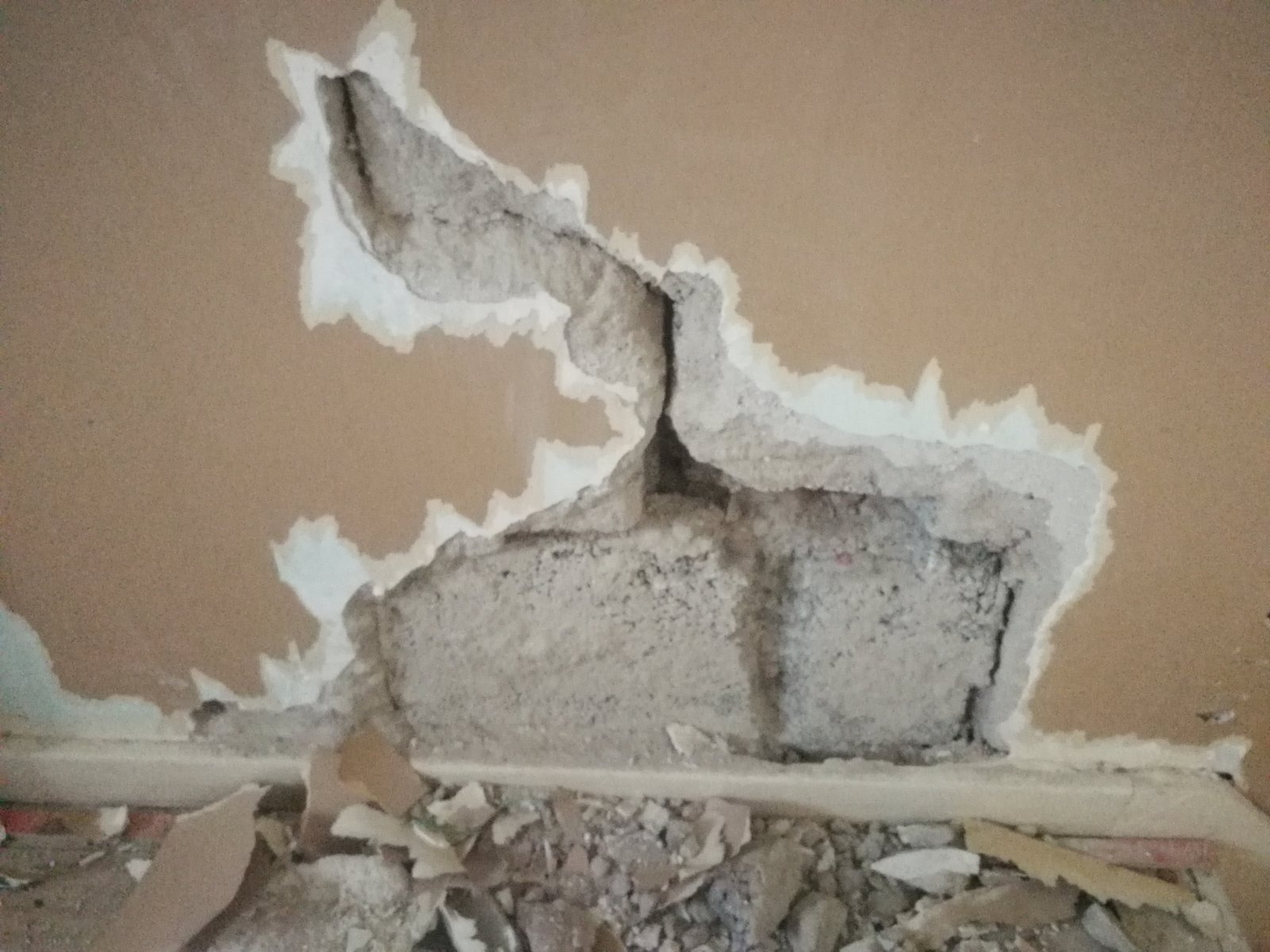

Hi all,
I am looking for some guidance on what to patch this with, there was an electric socket here previously.. However a radiator is being fitted here now and socket being fitted in another location as part of rewire.
Most of it just fell off the wall when the face plate was removed! Approx 50cm by 45cm.
Thanks.
square off the patch - dont mess with the blocks - and go over it with any Easy-fill or One Coat plaster patching material.
Can you buy ready mixed stuff to fill this with? Lot of people I asked locally have said to use bonding. Thanks.
Ready mixed is expensive. Get a small bag of bonding plaster and small bag of skim and make a brew. Sit and watch the 100's of clips on youtube on how to mix and apply
