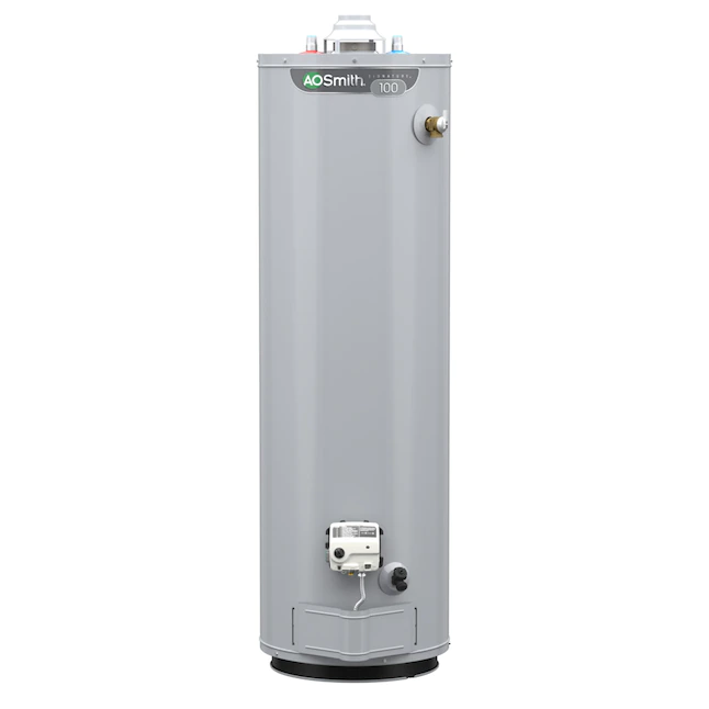

My installer said this sort of thing is popular in America now. But presumably a bit smaller.
https://www.plumbnation.co.uk/site/andrews-ecoflo-ec380-740-condensing-water-heater-natural-gas/

Old technology is the futile effort of attempting to heat a decent amount of hot water on demand either by using an electric piece for a useless 4 litres/minute, or a grossly oversized gas boiler.
The fact it's favoured in America is all you need to know.
It will be an inefficient heap of junk, and at nearly £9k plus a lot more for installation it has to be the most expensive option available.
I realise now that's a commercial one. I think this is a proper domestic American one. It does sound awful! Only $600 though.
