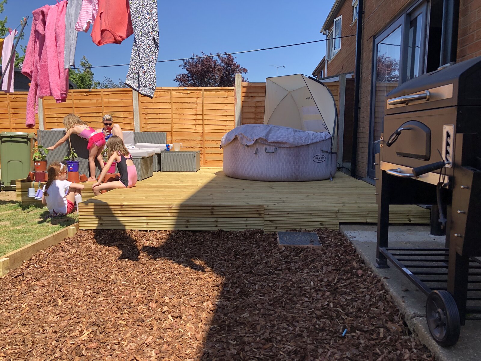

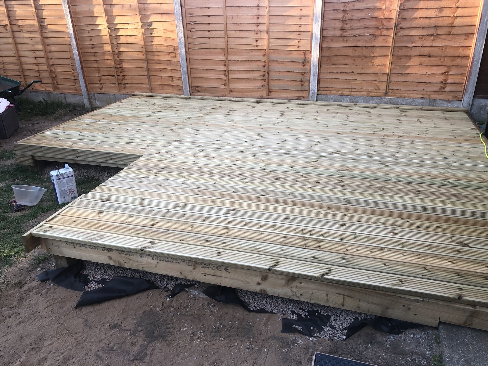

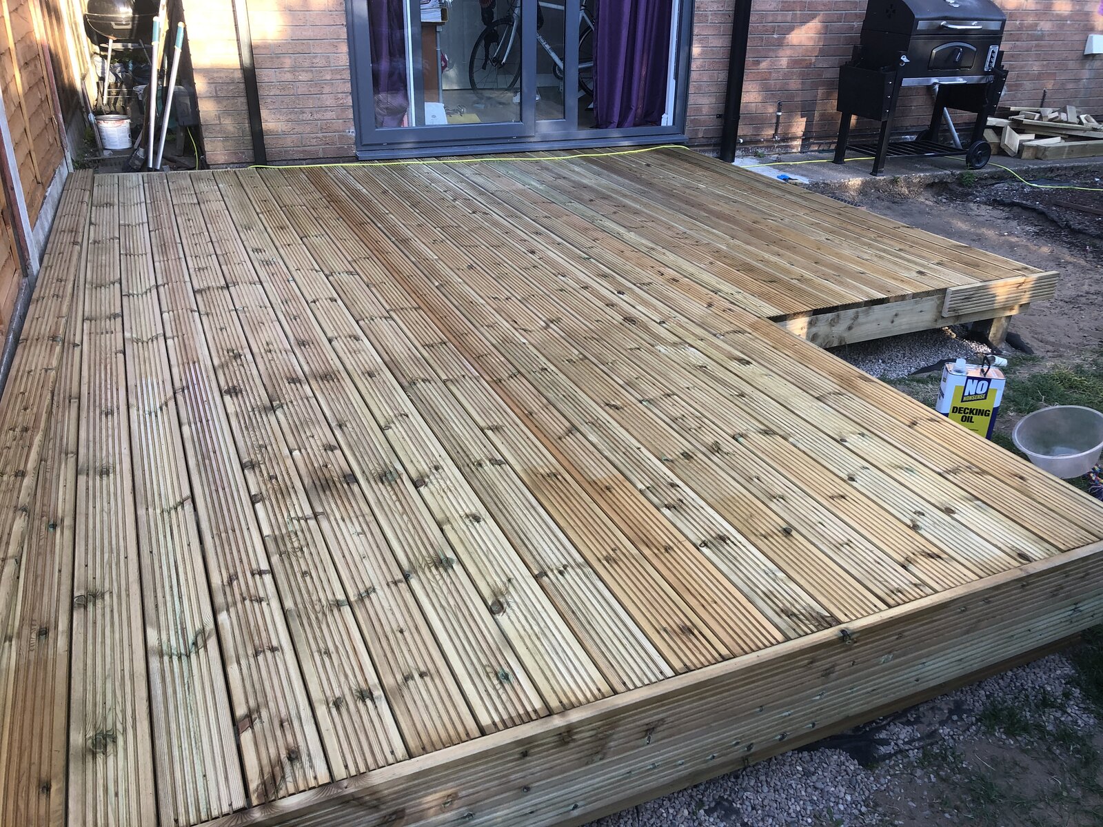

I have just finished something very similar and used cheap pea gravel.
Thanks, getting hold of material has been a challenge! To be honest this is only the second deck I’ve laid as a diyer, my idea was to use pea gravel to stop water pooling. On the first deck I did I just used weed matting. Out of the two I’d go for sub base, ballast may hold water.
You need to make sure it’s something no plant can grow in. Pea gravel is good. Ballast may just hold enough organically and moisture for weeds to take hold. I’d go big size as once weeds take hold under a deck it’s a pain in the a***
