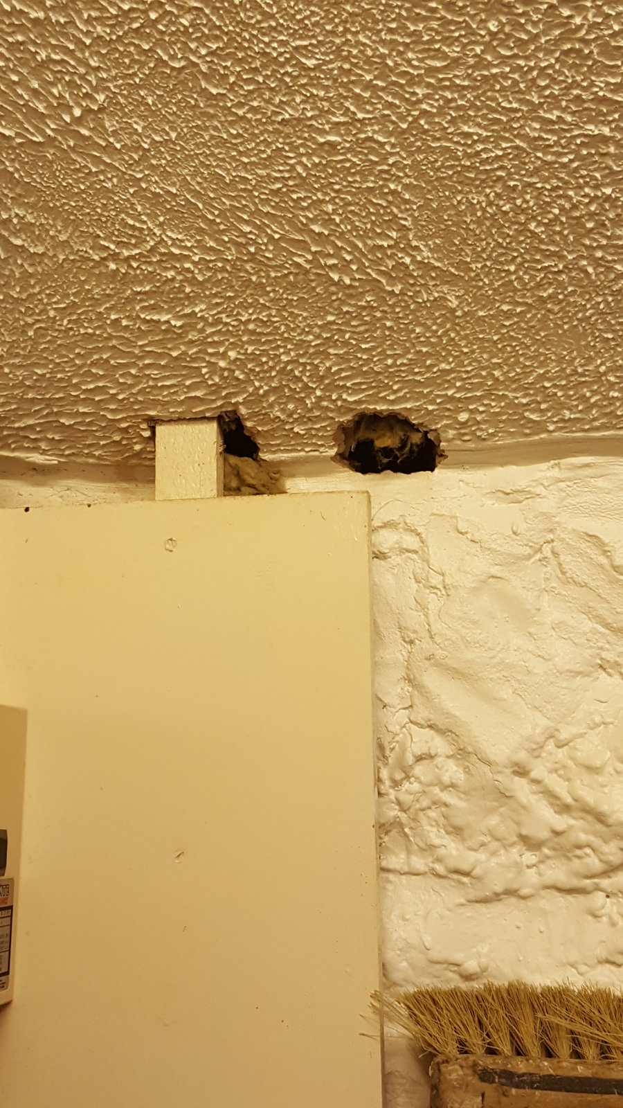

I have been staying in an old farmhouse which has a barn converted to a games room. In the corner or the converted barn near the ceiling I saw some insulation and wondered if anyone can suggest what type it is whether asbestos or other?
Hope the picture uploads well, this is my first post.
Thank you.
I do not seem to be able to down load your pic ?? old asbestos lagging used to be put on in a wet form and then coated with a paint/sealant on site ?
it did not come in sections ? if this makes sense ?
As above, looks like Rockwool [No Asbestos Content]
But?
There is generally a but somewhere?
The Artex is a different ball game, do not disturb the Artex, to any great extent.
