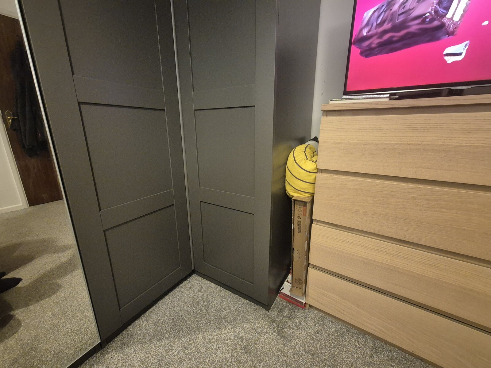

Hi What type of paint do i use to paint the drawers to match the wardrobe?

Laminate on drawers?
Benjamin Moore stix primer then scuff-x
220grade sand and clean first
