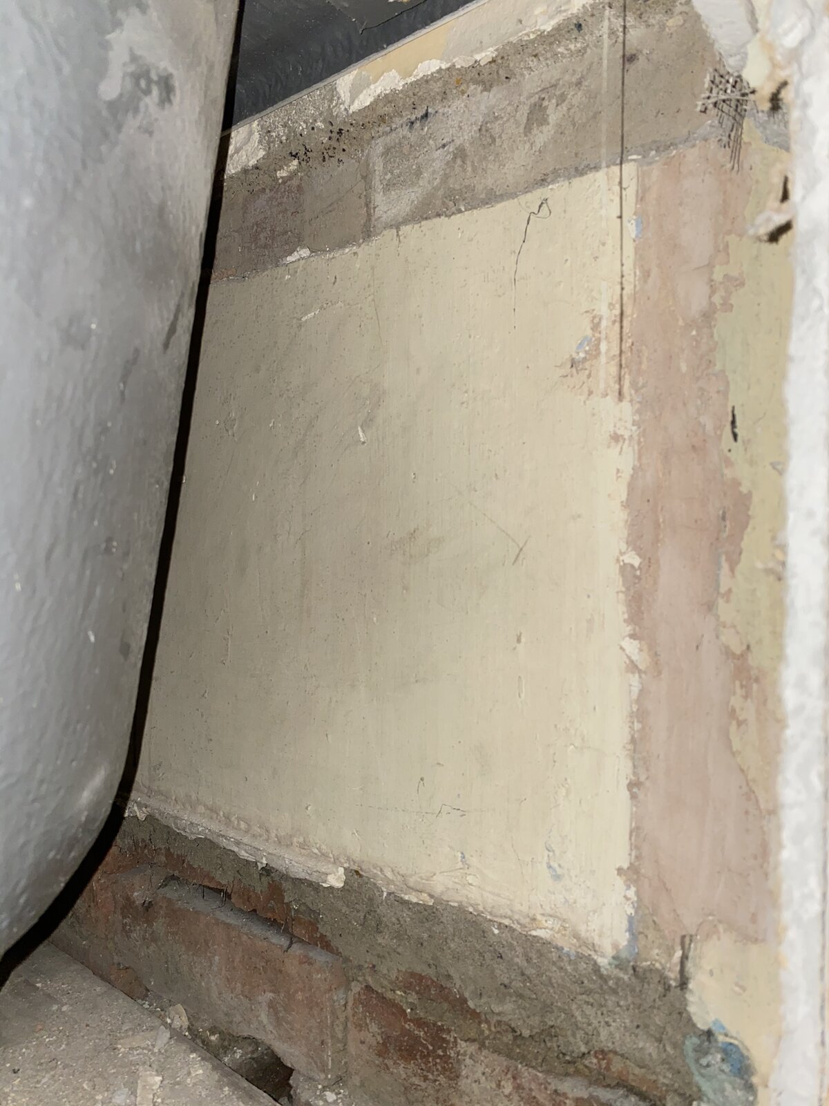

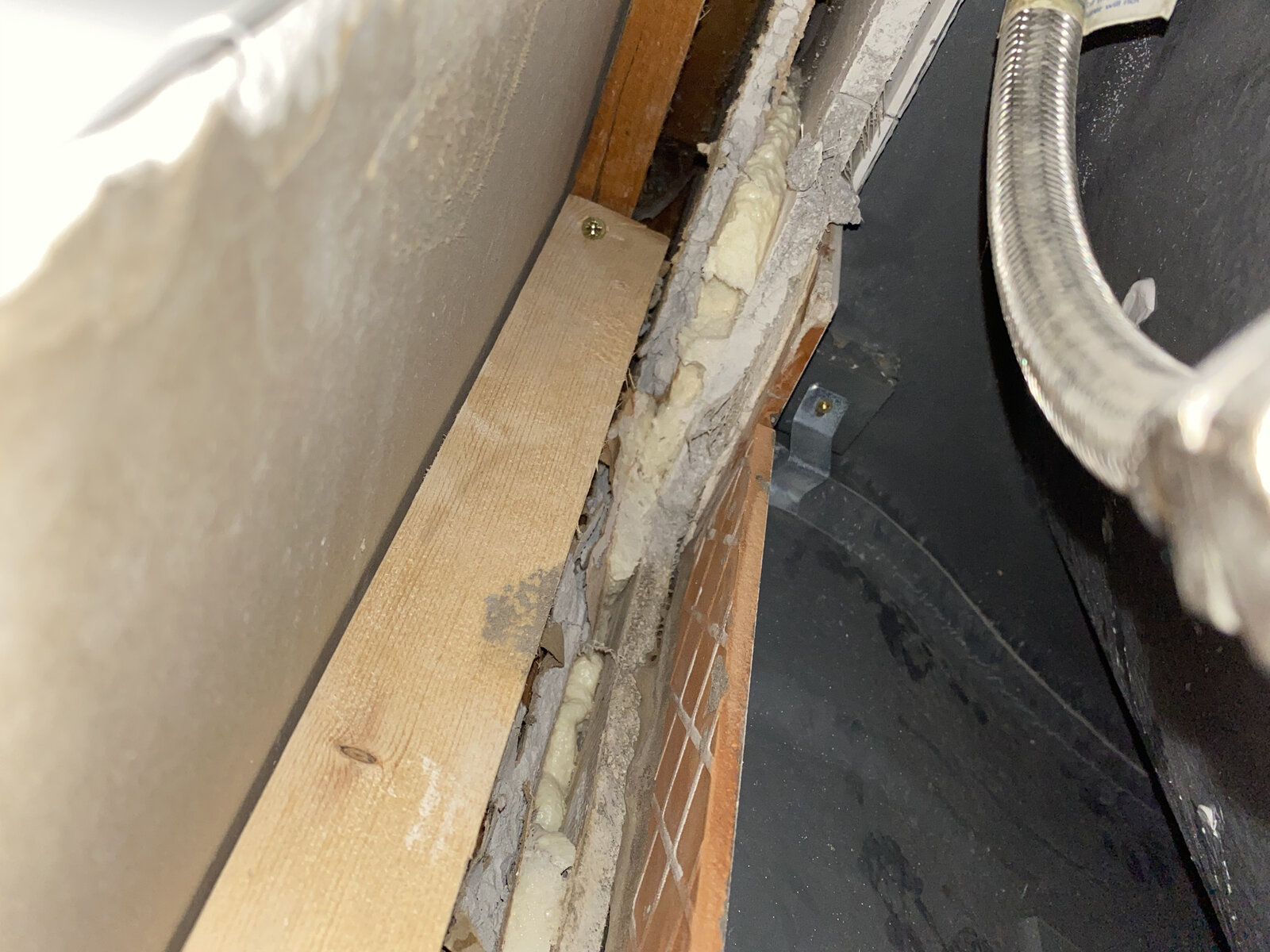

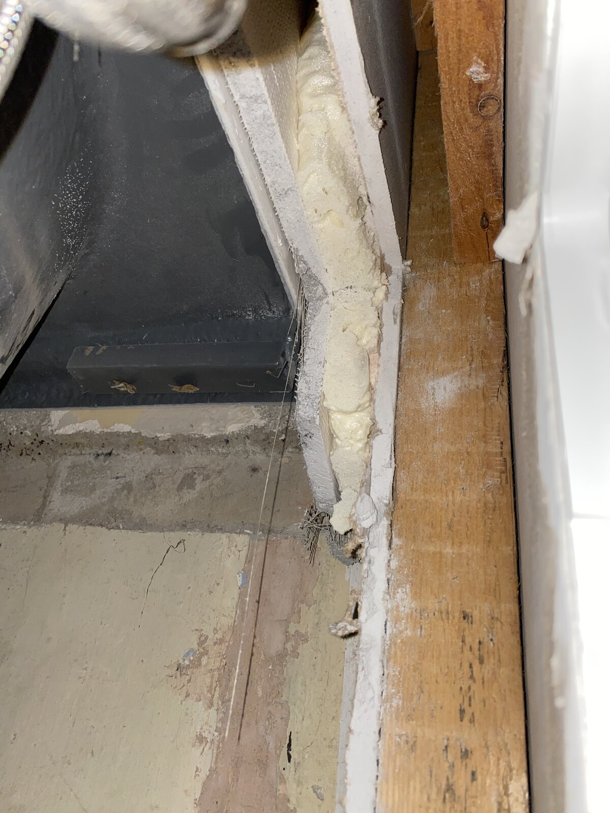

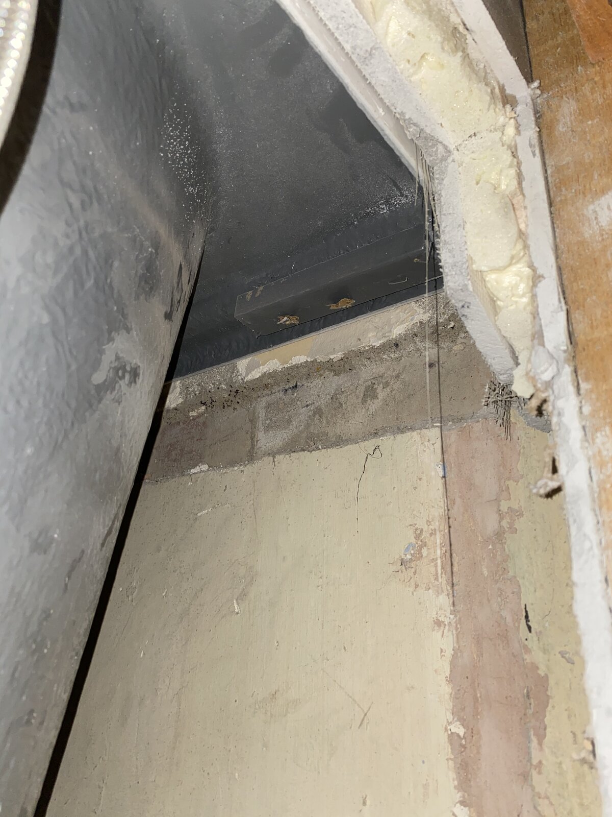

Hi
have been looking behind the bath inside the cupboard underneath (possibly could have been a boiler in there previously, but house was renovated 2013 approx) and found these plaster boards and plaster on the adjoining wall.
could someone tell me what they think the substances are? I am worried the frayed parts could be asbestos. House is 1910/20s. Looks like original lime plaster on the brick wall but not sure what the different layers of plasterboard are?

the frayed bits look like scrim tape.
looks like normal plasterboard to me
