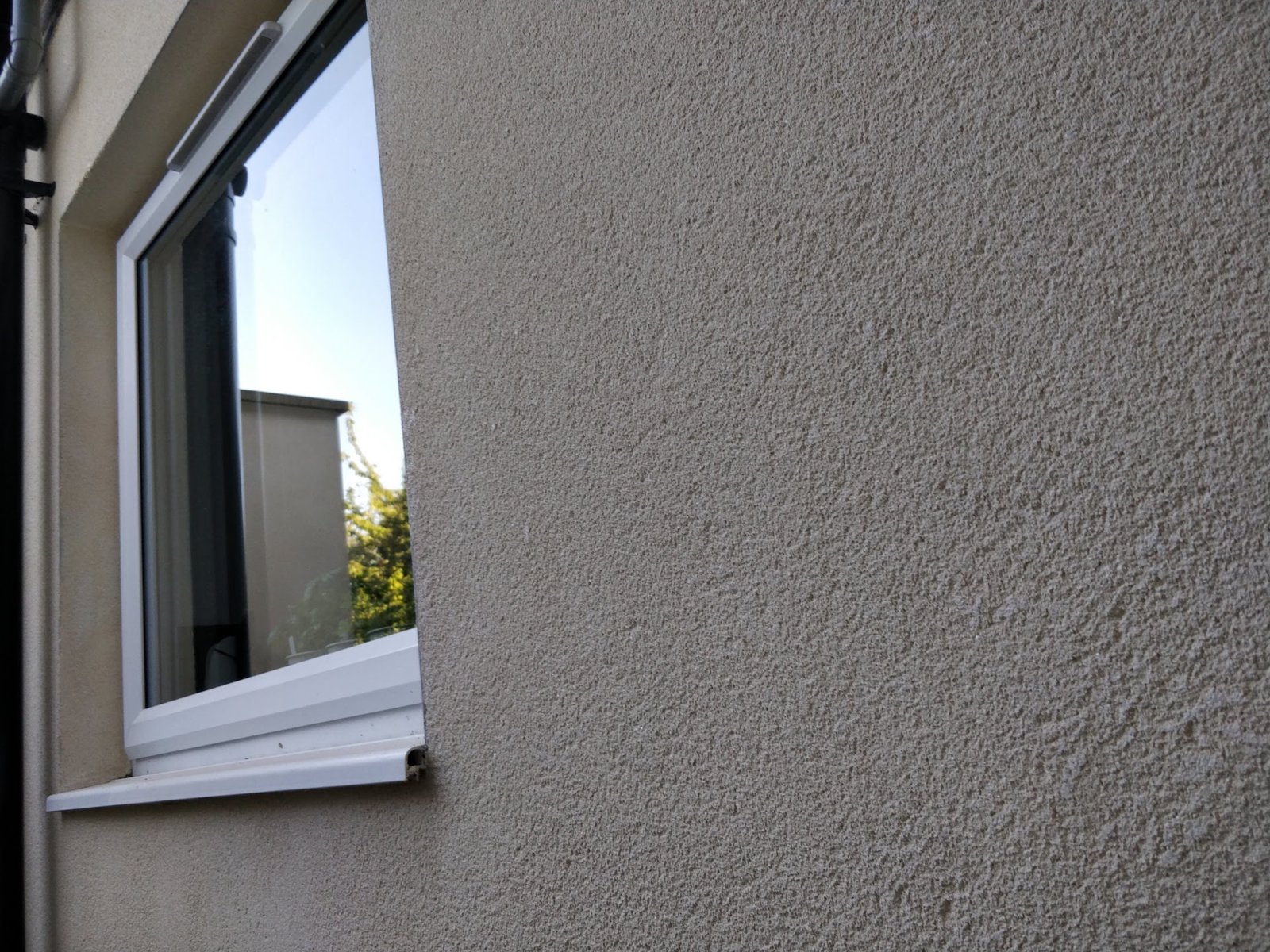

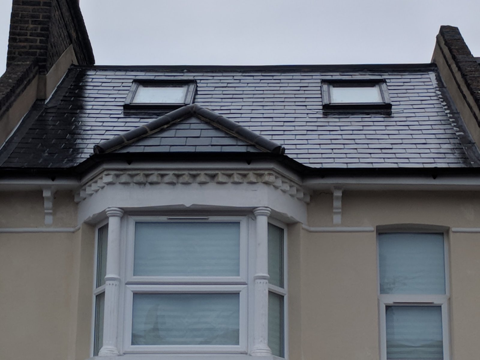

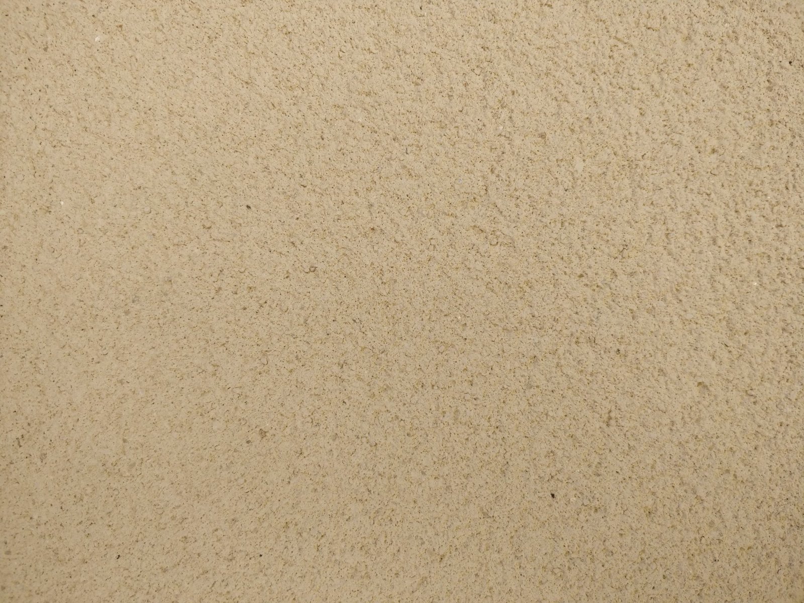

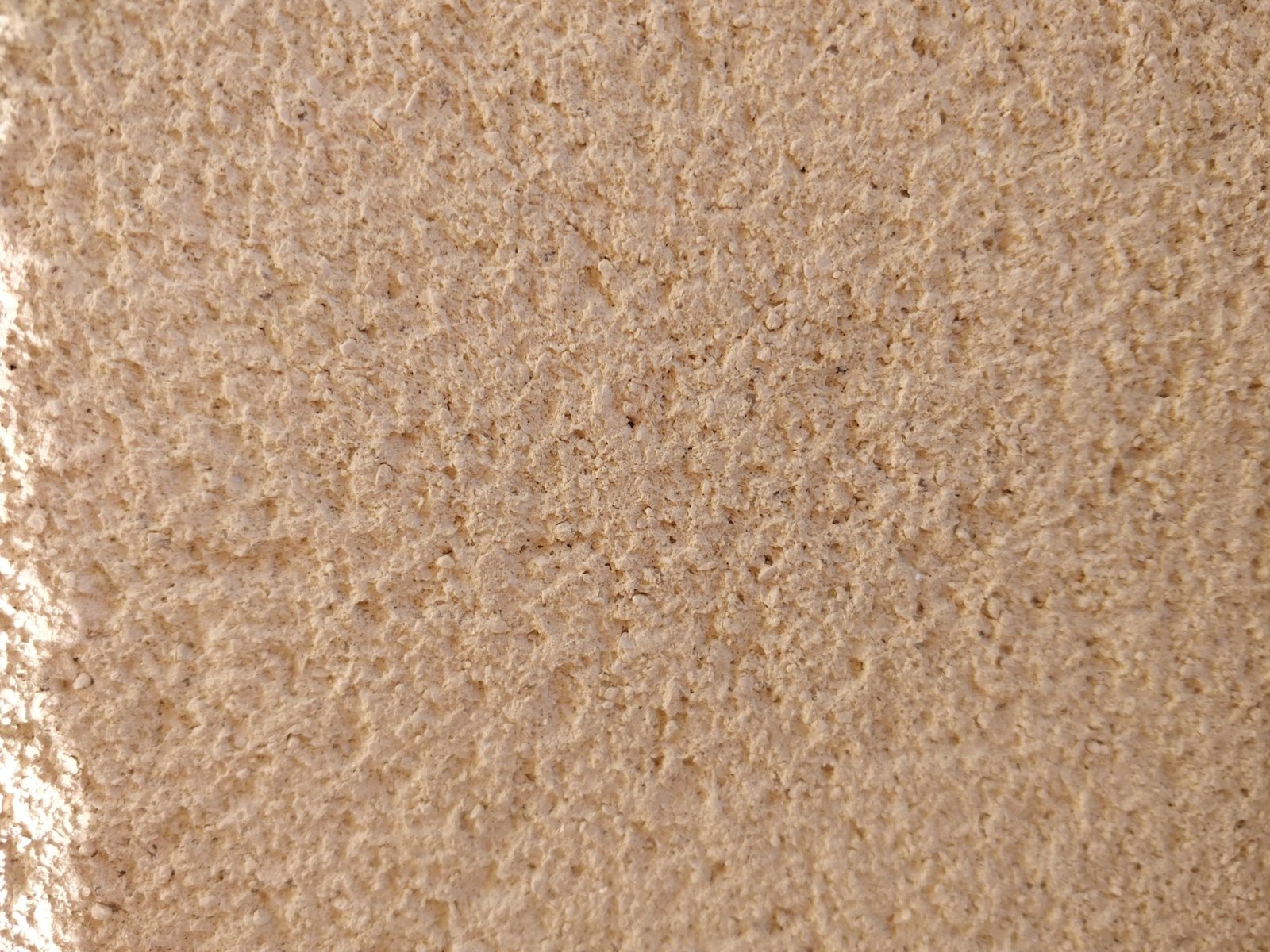

Hi guys,
I need to fix few marks (caused by scaffolding) and some drill holes of the external render of my property.
The property was renovated less than 2 years ago by the previous owner, but I don't have the specs of the product they used for the render.
The render has a bright yellow finish, with a "sandy" texture and when scratched it looses (quite easily) yellow grains. It seems that in few points the scaffolding "flattened" the texture - so the color is still there but the texture is (almost lost)
I've attached some pictures.
Assuming I can find the product, is it possible to paint small areas without repainting the whole house?
Thanks!

Sorry - I forgot to reply. Thanks for your input! I think I am going to look for a company that is specialised in small repair, apparently there are few that do also K-render.
You could you fischer xpress cement comes in silicon tubes the sand colour one matches your render colour well.
Selco stock it
Selco stock it
Interesting - which tecnique/tool do you suggest to get the same finish of the render?
