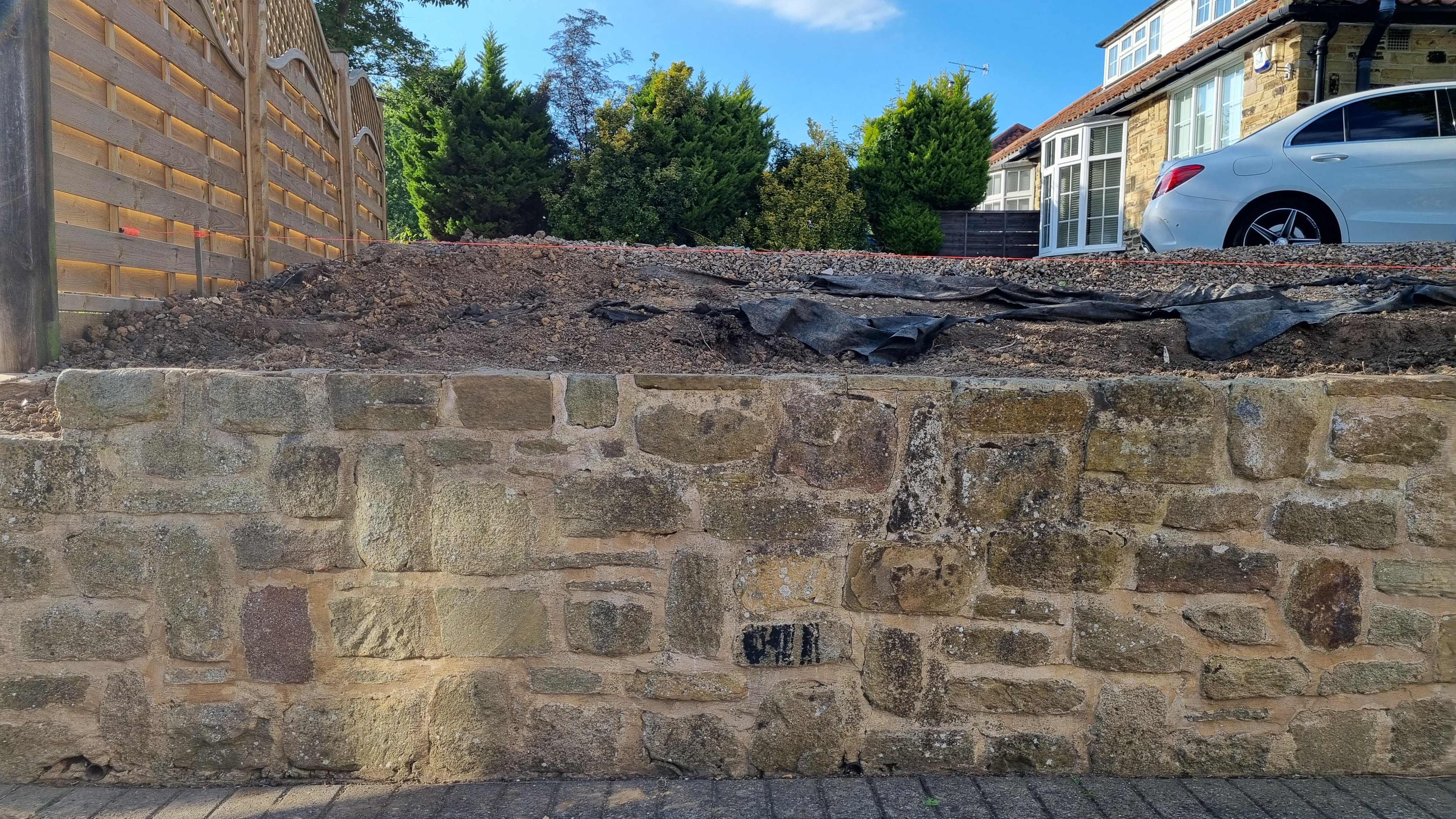

As you can see from the photo's, our neighbours land is higher than ours and there is a stone retaining wall in place, which has so far lasted the 26 years since the house was built.
There was a low 4' fence on this retained land and some scaffolding planks had been used to attempt to keep the soil from leaning against the fence posts and panels, but ultimately they rotted and also the weight of soil behind them helped the posts and panels to fail in high winds. In 26 years, there have been 3 fences built along this length and we have now decided to plant a hedge instead. Before doing this, we need to build something more permanent to hold the soil back.

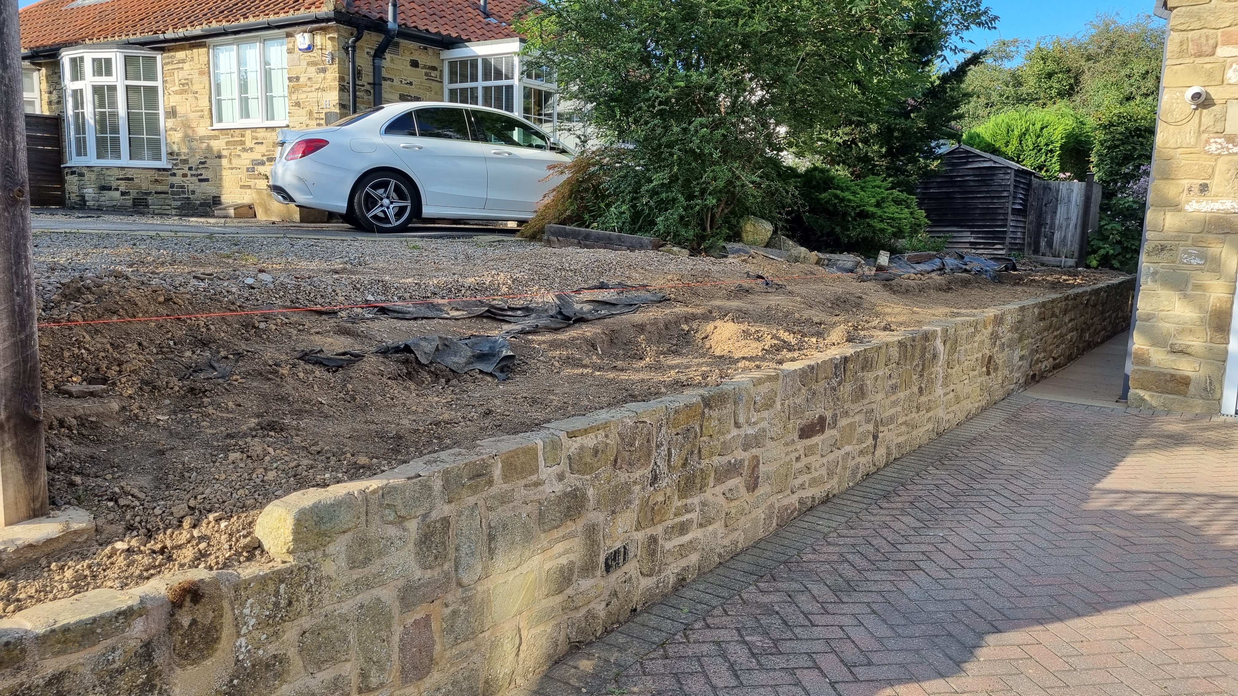

The following photos hopefully give an indication of the area that needs to be retained. The orange plumb line indicates the line of the new retaining wall, so as you can see it is set back by just under a metre from the front of the existing stone retaining wall.
The length of the wall is just short of 17 metres:

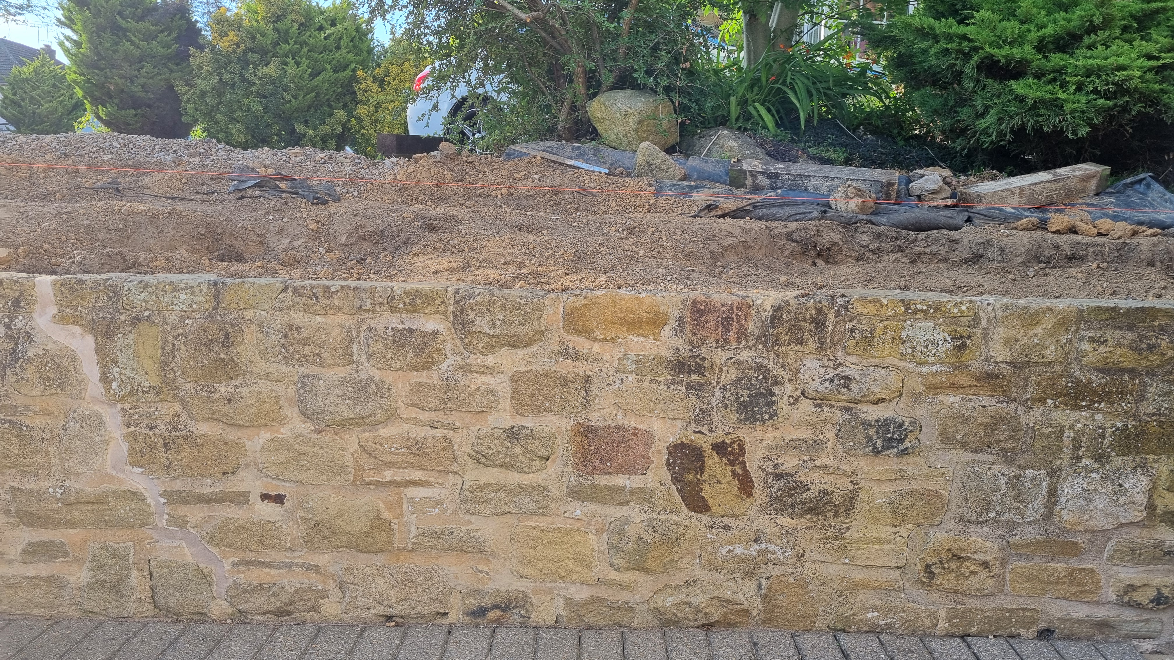

The existing stone retaining wall is 80cm high:
My estimates are that the retaining height will need to be between 15cm and 30cm along the 17 metre length. This is measured from the top of the existing stone wall to the orange plumb line you can just about see in the photos.

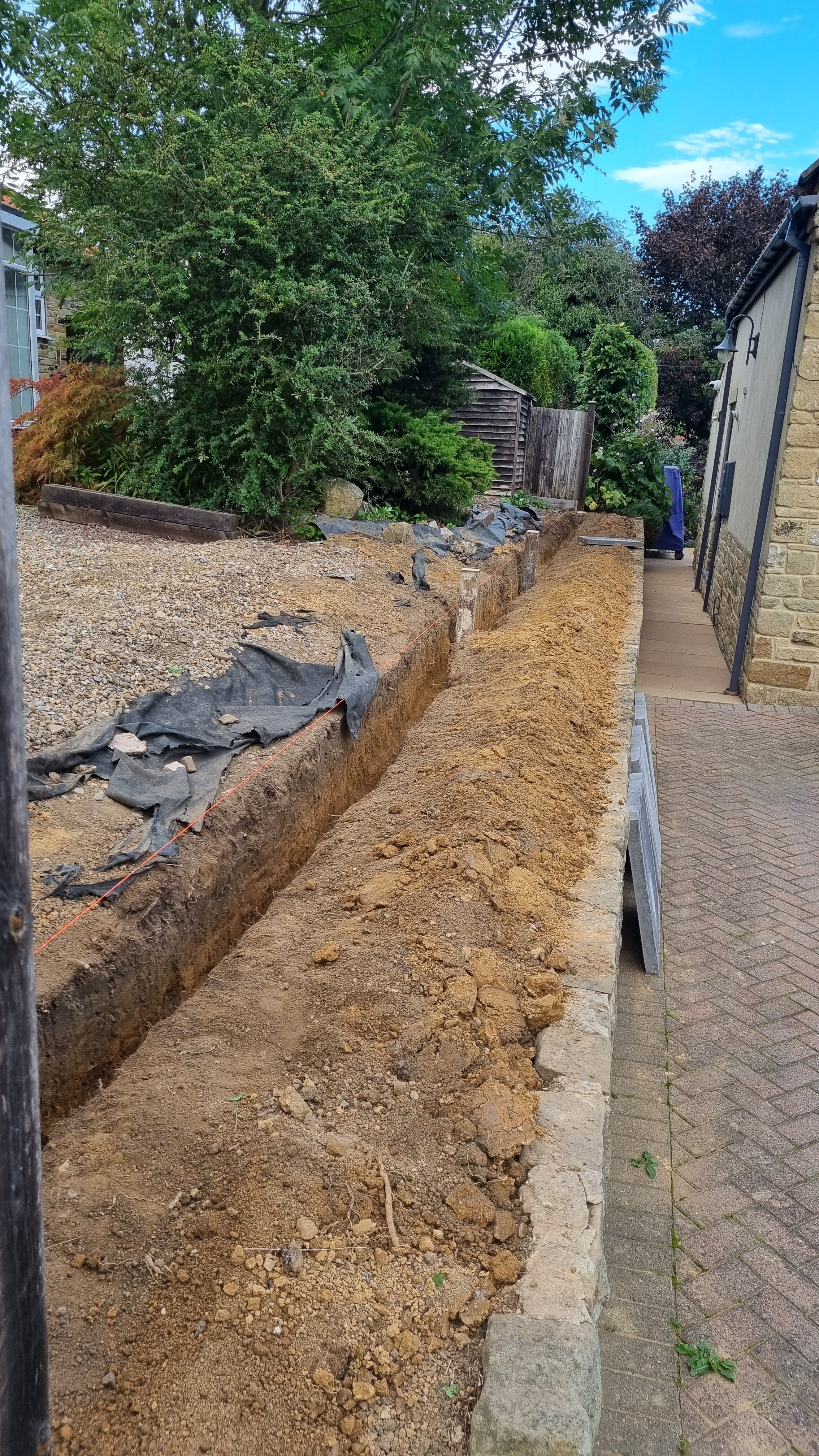

So, we've decided to go ahead and build this retaining wall ourselves! We dug a trench yesterday, which is 17 metres long, 10cm wide. The depth varies but from the lower side (towards the wall) it is around 30cm deep and will probably end up being a little deeper as I still need to accommodate the slope of the soil area to be retained etc. The higher side (behind the slab in the neighbours garden, is much higher than 30cm and varies along the length of the trench.
I will be ordering 24 600 x 600 x 50 concrete slabs. I already have 4 so will be fitting 28 slabs in total along the length of the trench.
I need to determine how much sand and cement to order! We will probably hire a cement mixer for a long weekend (3 days). I would appreciate some guidance on how to determine how much sand and cement is required for this job. For example, if I was to poor 10cm deep cement into the 10cm wide trench (but due to the 5cm wide slab, this would reduce to 5cm wide?), then lower a 5cm wide slab into it, would this be sufficient to hold it? If the cement is mixed with only sand and no ballast I'm assuming the weight of the slab was cause it to slip through the cement and sit on the ground, squeezing the cement up each side and causing the cement to displace around the front and back sides of the slab! If ballast was added, would the weight of the slab do the same, or would be ballast under the edge of the slab cause it to sit a little higher?

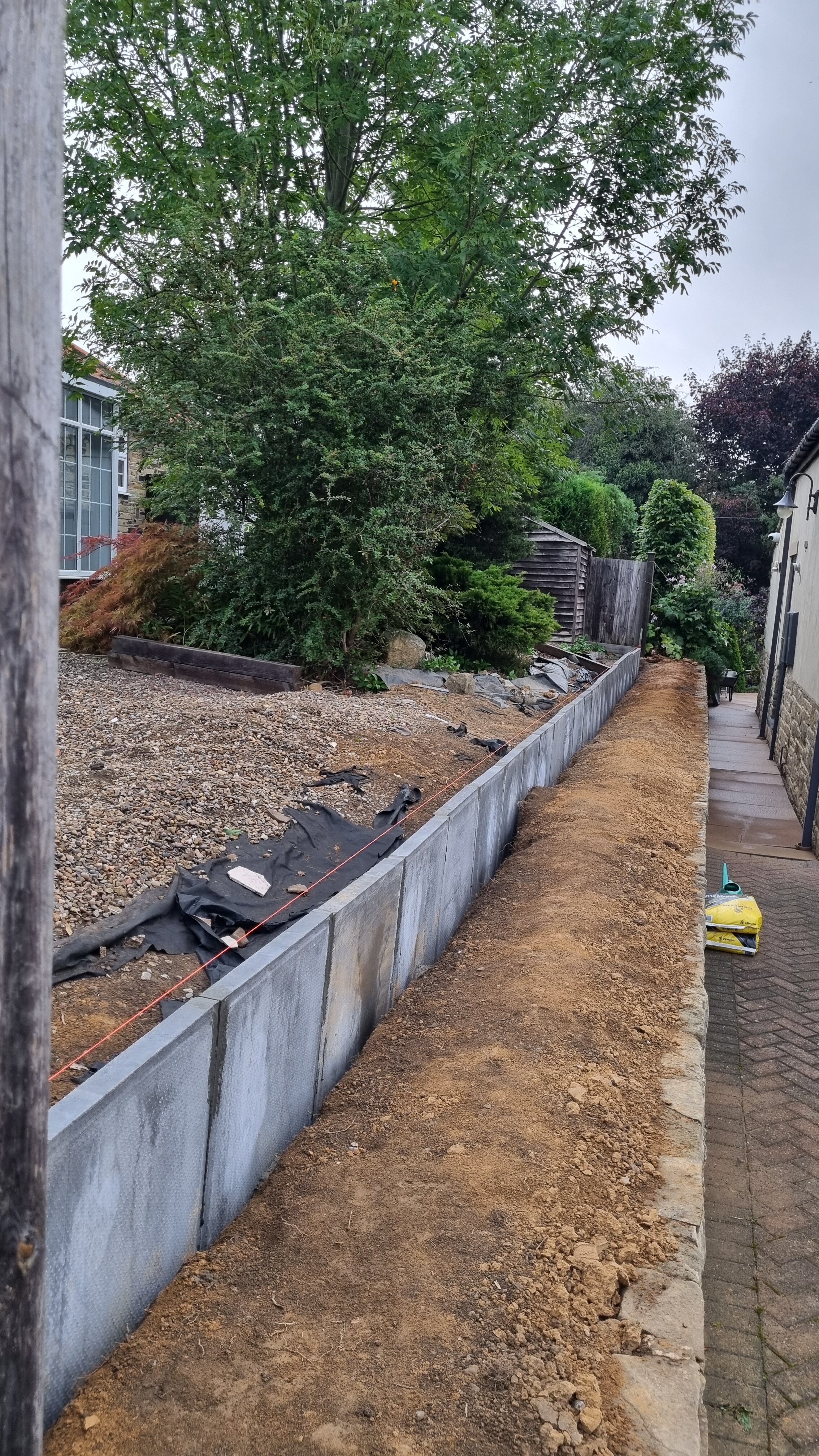

It was hard work, but finally got the paving slabs in place, each one set on a bed of mortar:
Next weekend, weather permitting, I hope to hire a cement mixer and mix enough concrete to fill some of the trench on either side of the slabs to ensure they are fully supported. Then the soil will be pushed back to fill the remainder of the trench and the new hedge planted.
