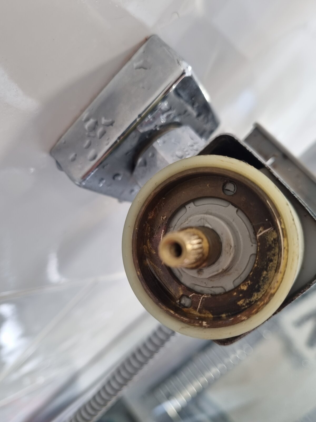

Hi all,
First time poster, looking for some advice/help. My shower is dripping and I believe the shower cartridge needs changing.
Does anyone recognise the type below? And any advice on how to remove? It doesn't seem to have the removal mechanisms seen on other types. Is it possibly something to do with the two holes in the metal plate -perhaps a specific tool is required to remove them?
Would appreciate any advice. Thank you
Is it a bar mixer? If so, a whole new shower valve will be a lot less hassle than a replacement cartridge and may be cheaper. The pipe centres should be a standard 150mm.
If you wanted to change the cartridge, showerdoc.com may be able to identify it and advise on removal. Looks like it needs a special tool but you may get away with using a small screwdriver in one of the holes and gently tapping it anticlockwise.
As suggested - That brass ring with the holes will probably tap around to the left to unscrew. The trick will be getting a cartridge to suit once it's out. As suggested may be easier just to get a replacement bar shower.

Thanks all - very helpful, really appreciate it. I'll check out showerdoc.com and perhaps try the screw driver tapping trick.

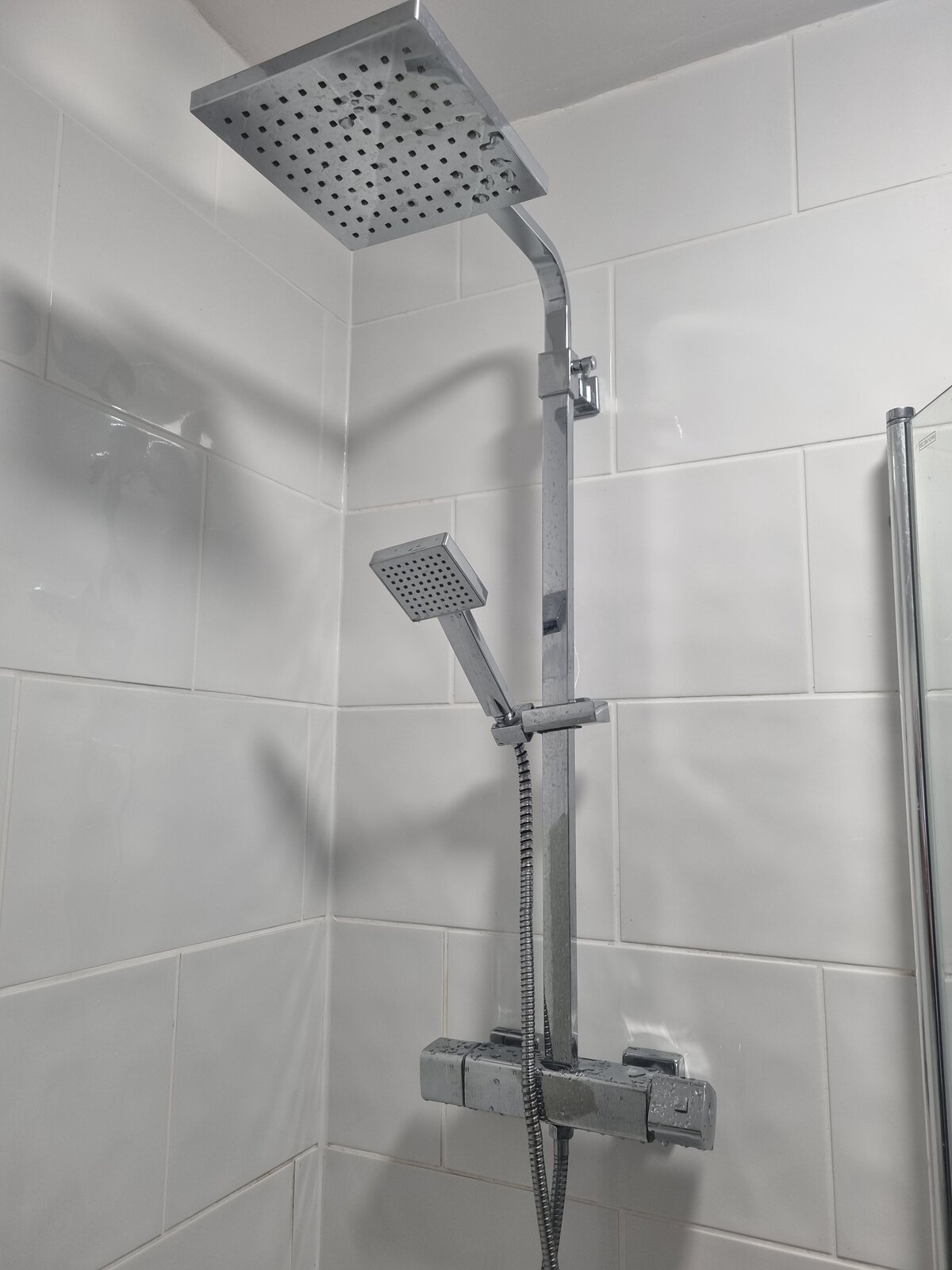

I'm not sure if the replacement shower valve above would work, as there are two outflows from what I can see (see the photo below of the entire shower - might need a specific replacement) - or a case of replacing the entire shower (which seems a shame - outside of the dripping it works fine).
yup, that's quite specific with the hard pipe riser fitting straight into the bar with the handset outlet below. Worst case it would all need replaced.
Ok, now we get a better picture, this would be worth a punt!
