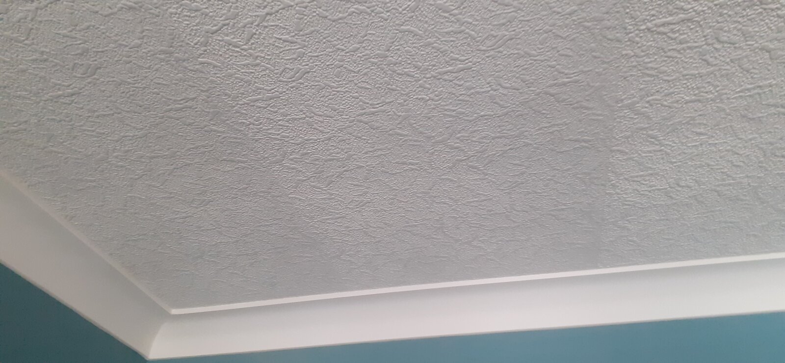

What type of textured ceiling is this?
30 Aug 2022
2
Hi, i am unsure what type of ceiling this is. This is in the UK.
So not Artex (or anything containing Asbestos). Because I have seen a lot of people online saying that a textured ceiling could have asbestos in it and thus not to mess with it.
If you carefully run a scraper down an unobtrusive seam, you should find that it will start to come off as a sheet.
If it does, then definitely not asbestos!
Just to add, if you do intend to remove, sometimes the paper is pasted directly onto the plasterboard ceiling, rather than the ceiling having a skim of plaster.
This can be problematic to remove, without destroying the plasterboard.
This is why I have been procrastinating over my papered ceiling!
