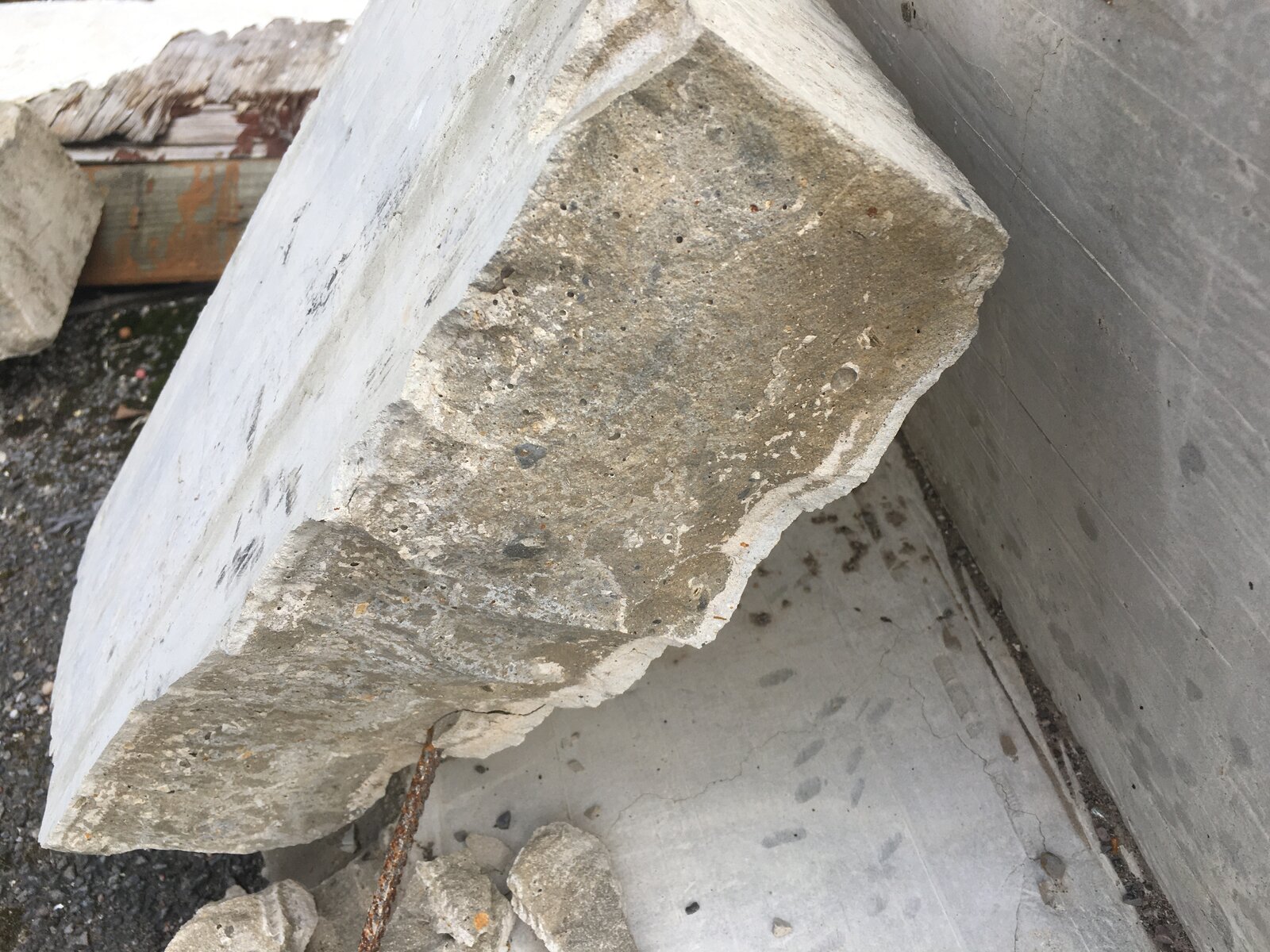

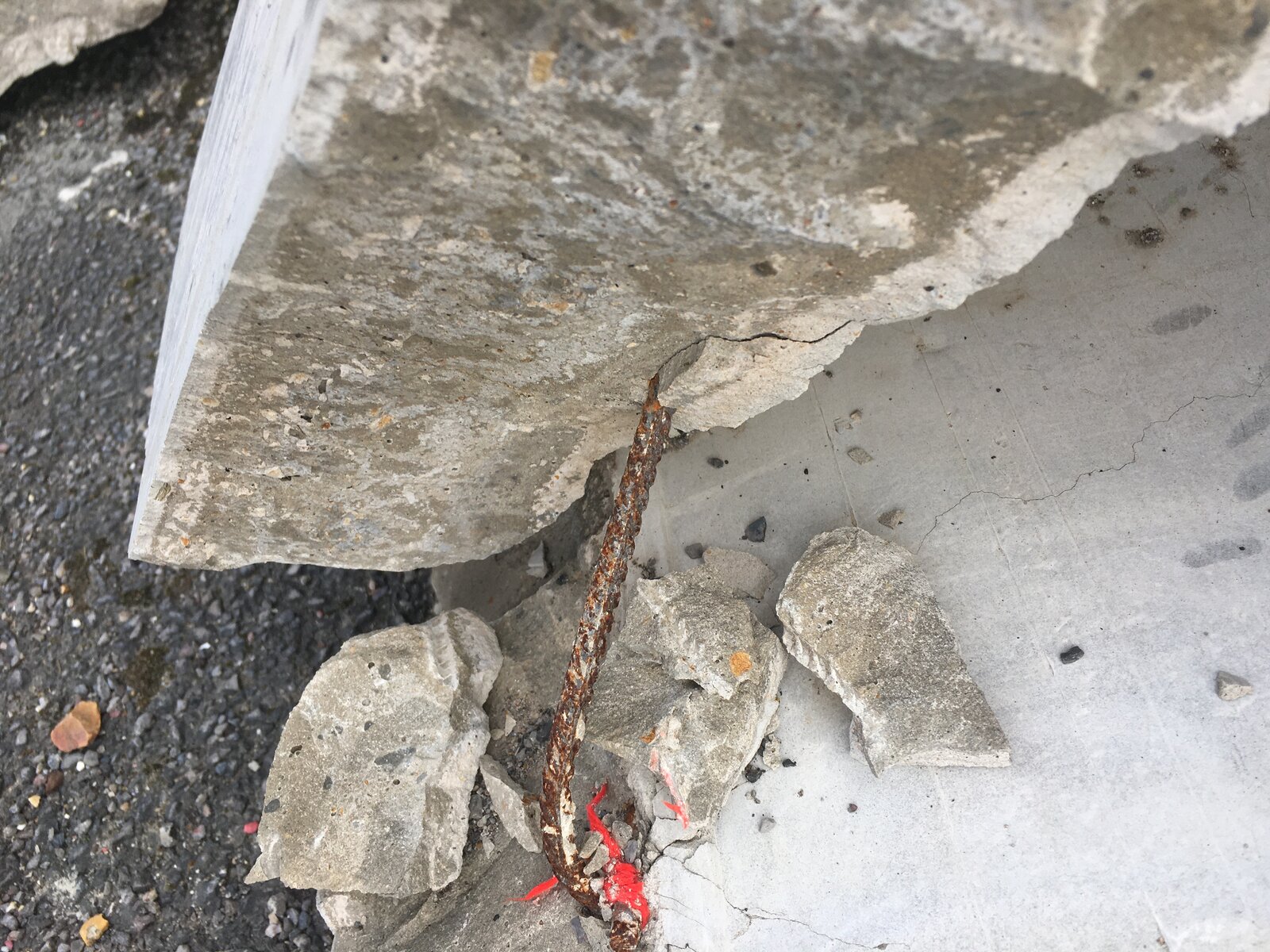

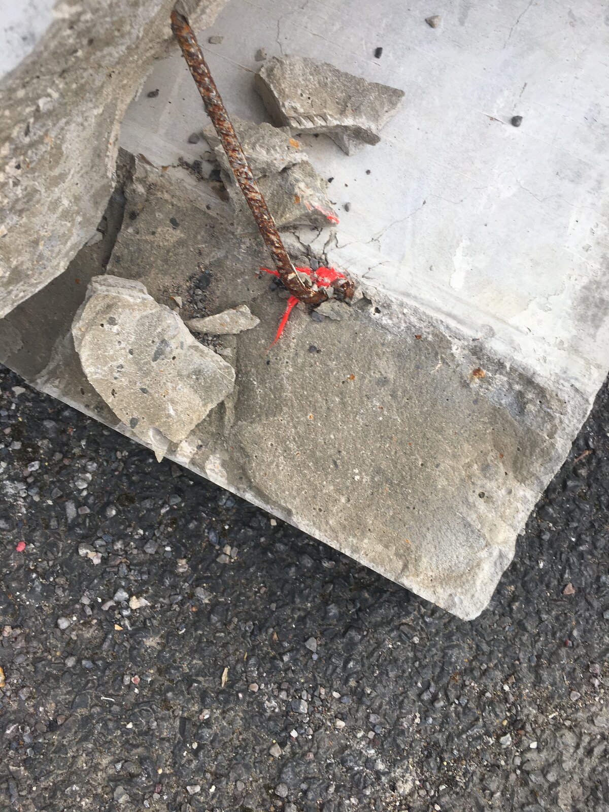

I want to cast a shape in concrete. It needs to be tough, but smooth on the outside.
An example of what I think would be suitable is in the pictures. There is a small amount of rebar in it but it looks to me to be mainly sand and cement? I was going to add the chopped fibre to the mix as well.
for scale, the concrete looks to be approx 4” thick.
Mine would be more rugby ball shaped and a bit bigger than a rugby ball.
TIA.

You need a 3:1 mix, and dont forget to give it a month to harden, sharp sand, not builders sand, and use a febmix or similar so you dont need too much water.
yes, loads of time to cure.
I won't be bashing it too much but may be pushing down on it to bed reluctant (annealed) aluminium.
