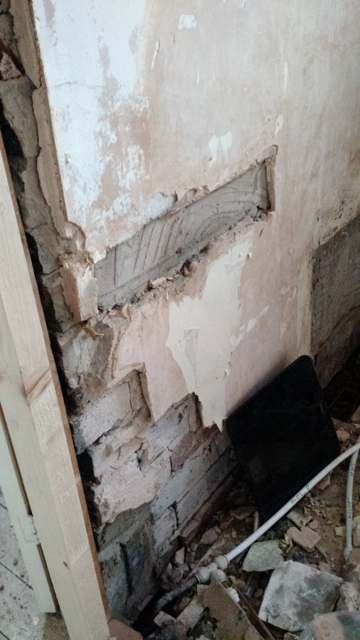

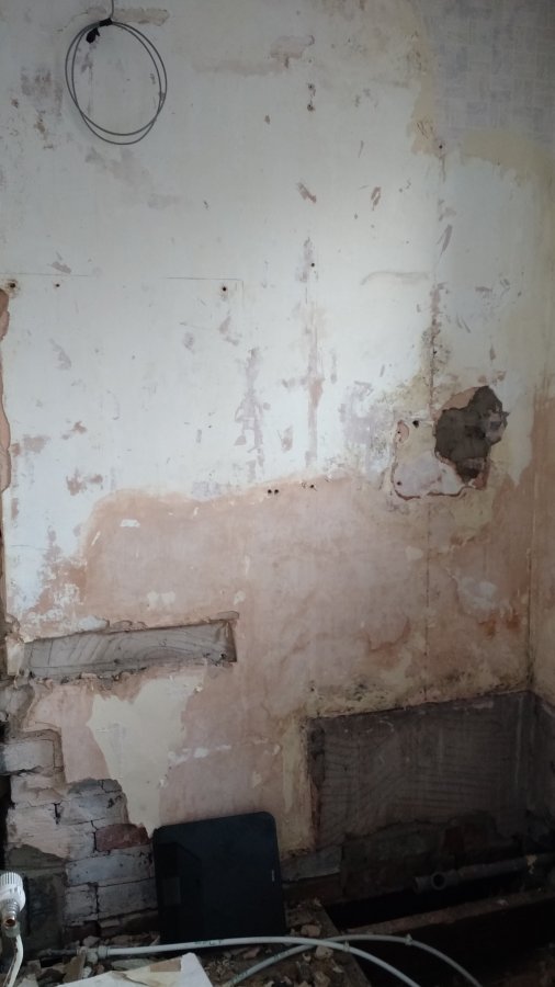

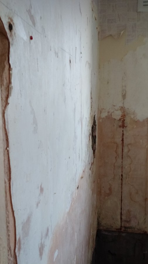

What would you do with this bathroom wall
21 Feb 2014
267
12
Lancashire
as i see it my options are to overboard it with cement board or moisture resistant plasterboard
or knock off the plaster and board the wall?
the wall will have a bath all the way along it and be tiled floor to ceiling
Either way, whats the best method of fixing plasterboard and cement board to a wall, batons or adhesive?
The manufactures of cement boards normally require them to be fixed to battens.
I have in the past when restriction have meant that battens could not be fixed, fixed them using dry-wall adhesive and secondary mechanical fixings for security.
I'd be inclined to remove all that plaster first, then dot and dab your cement board onto the brick
