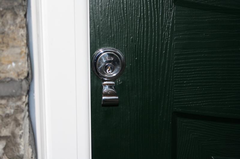

Hi all,
Door circa £1700 installed today. Not paid as are unhappy with defect. It was also not sealed underneath (you could post a letter under the threshold where insufficient silicone was applied).
Installer has come back out to seal under door. He verbally agreed with my assessment of the cause; that the finger pull has scored a mark in the surface but was not happy that I wanted something done about it, as it's so small and that manufacturer would quibble with him over who's liable for the defect.
He has not (in fairness to him) suggested that it was done since they left site today and before I came home. He considers that it's likely factory caused.
He proposes to gain paint from the manufacturer of the door to effect a repair, though I am doubtful that this will work. It's not a colour issue, but radial scratches.
It's visible from about 5' away and really lets down the appearance of a fab and (expensive door.)
I have yet to speak to customer services but the franchise have already said that its between installer and me.. :(
So do any of you put hope in the paint remedy, and what would you accept as compensation? Any other advice? We'd be mad to have them take it away i.e. refuse to pay, but dummies to accept it as is and just say 'oh well!'

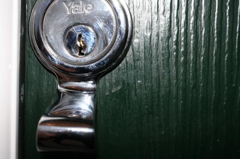

who installed the finger pull? the mark looks suspiciously as if it's been caused during installation.
As DIY said, the mark has been made by whoever installed the Yale lock, it's been secured slightly off center and then moved round (while still tight) into position. What door is it?
That's how it looks to me too FWIW.

Yes, ....I asked (fitter) who installed the Yale and finger pull. My thinking was that it would just not be possible to attend to that task and not notice creating the mark.
He said the whole lot came installed from factory.
To which I said that he'd then inspected (or not) prior to signing over the door and should have not expected me to be happy with it.

On the brush pile issue, I've never fitted a composite door that didn't have the brush pile fur under the striker plate, that really is a manufacturing issue and not the fitters, as for the Yale lock well if the fitter didn't fit it to the door then its highly unlikely that he caused the scratch, as mentioned it looks like the finger pull has been adjusted without enough slack on the fixing screws, they haven't even straightened the cylinder up
As DH says the other faults are down to poor fitting, no excuse really for those but even if the fitting had been perfect you still wouldn't have paid due to the scratch thus the fitter doesn't get paid either, this reminds me of the reason I'll never fit for a company again, spend 2 days fitting a job but one scratched dgu and the customer doesn't pay means you don't get paid, right now I'm salaried and if it took me all week to fit the door then so be it, it'd be spot on when I left though, nowadays fitters are pushed to get as much done as poss just to earn an average wage, still no excuse but that's the long and short of it

It took lad 10 mins to diagnose that frame was not set square leading to the gap between door and front seal, and that the threshold needed packing. This they did in about 45 minutes including using colour pen to repair marks to surface- I am definitely eating my hat on that aspect, as the result is really good.
